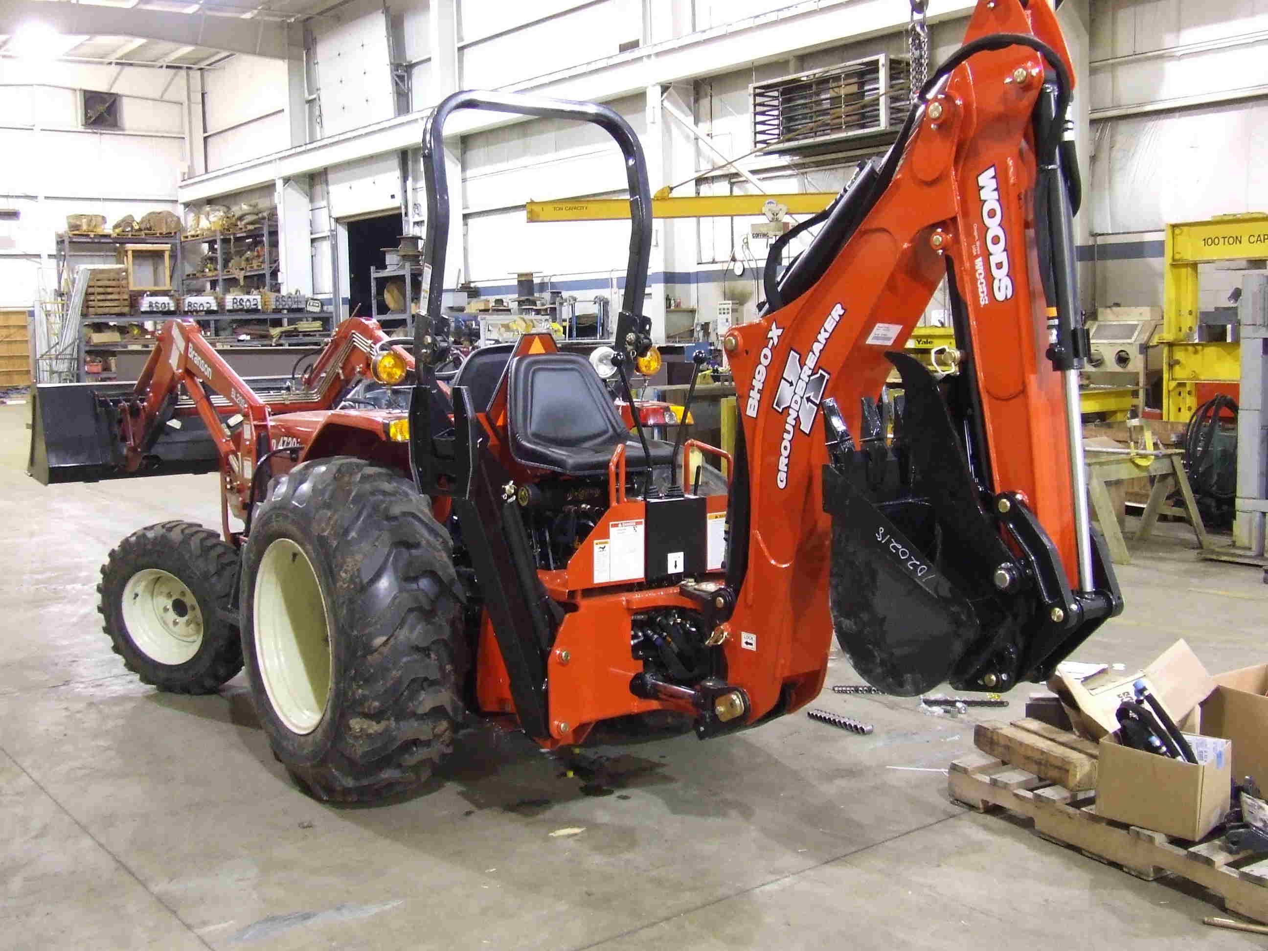

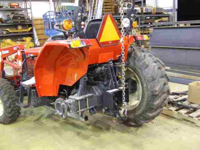

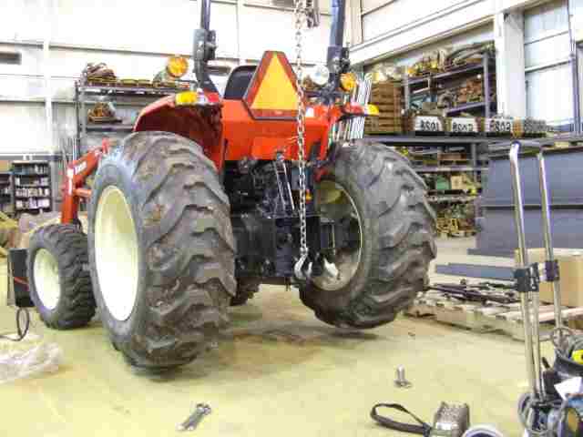

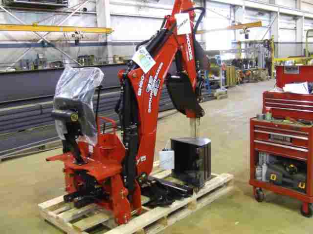

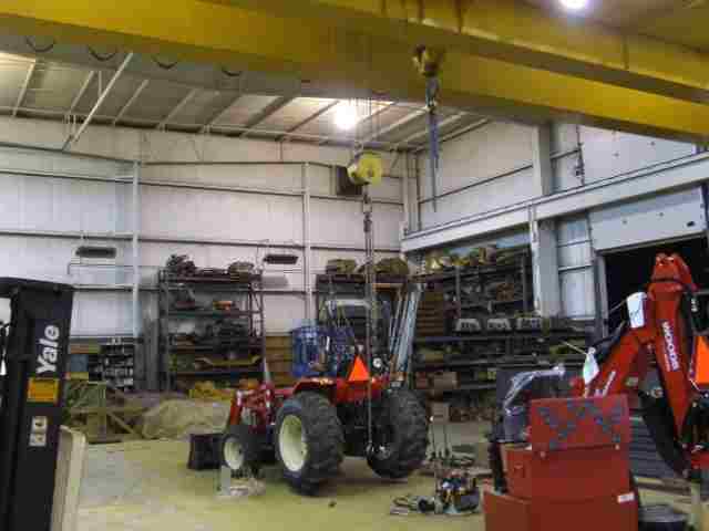

I added a Woods 90X with thumb and subframe. I installed myself in two evenings. Cost approx $7500.00 plus freight. It works very good.
/ Adding a Backhoe to 4720I #12
That my friend is a good lookin hoe!
Gene

Wow, sorry about the size of the picture I brought in. Here is a better sized pictures.DSCF0132.JPG
