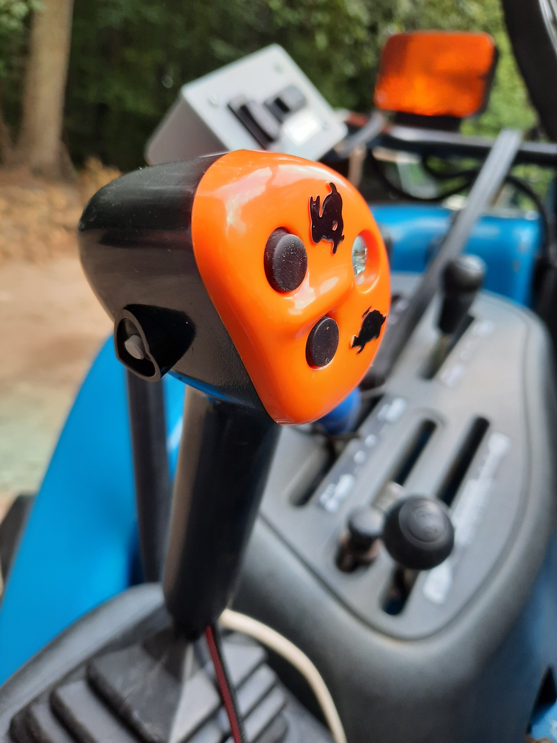

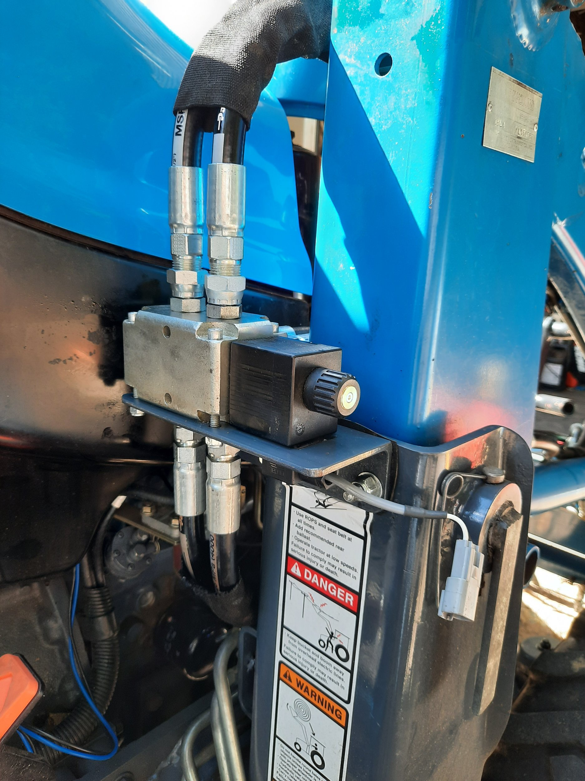

I add a kit to our NH & it took a little longer but only because I made my own bracket (because of where I wanted the valve) & I added my own switch / relay circuit to our existing FEL joystick... Other than that pretty straight forward.
