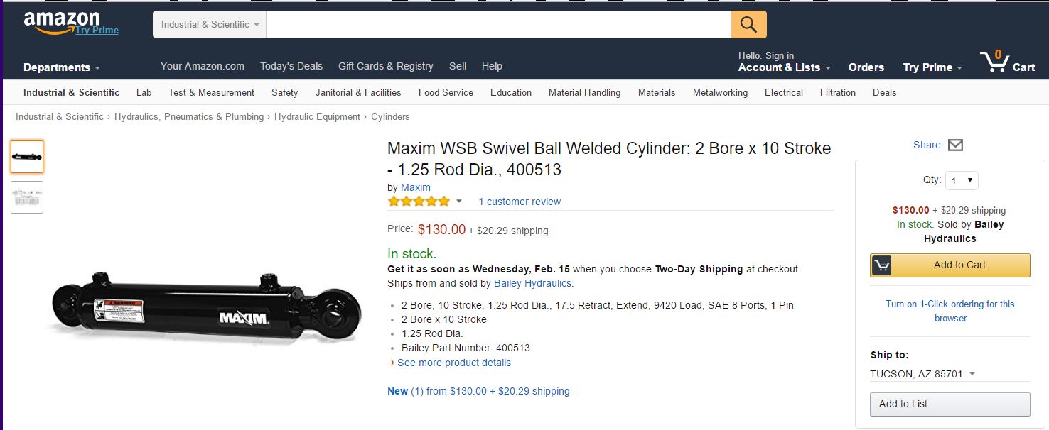

Hi Everyone
I have a 2013 B3300su tractor. I want to add a hydraulic top link. Kubota is very proud $$$ of their offering. So I am looking for something a little more down to earth price wise.
I found this control valve: 2 function for future growth
http://www.northerntool.com/shop/tools/product_200638935_200638935
Hydraulic cylinder:
Amazon.com: Maxim WSB Swivel Ball Welded Cylinder: 2 Bore x 1 Stroke - 1.25 Rod Dia., 4513: Industrial & Scientific
I know I will need some hoses and fittings but it should be far less than the $1021 Kubota dealer quoted (minus labor). Am I on the right track?
Where do I tap into the tractors hydraulic system?
Thanks
Rich

That cylinder has 1" pin holes, cat1 is 3/4".

That one would work, just not as good as one that's more matched with your machine's flow. Your tractor Pump flow is 6.7 gpm and that valve is good for 12 gpm. The one I listed is for 8 gpm. I can not tell if the power beyond plug comes with either valve or if you need to buy that separately.
Factory installed is very clean looking, it fits into a tight, out of the way, space. Has all the mounting hardware and brackets (you'll have to build those) to mount the valve and the quick disconnects to.

I used this one Surplus Center on my B2620, the tractor side mount will need to be narrowed up a bit to fit in the bracket on the tractor. They also make a longer one with an 11 in stroke.
I personally prefer the check valve for my uses, I don't have a need for float and it prevent cylinder drift.
I prefer the prince wolverine valves to the northern valves, northern valves seemed a little less well built when I was looking.
