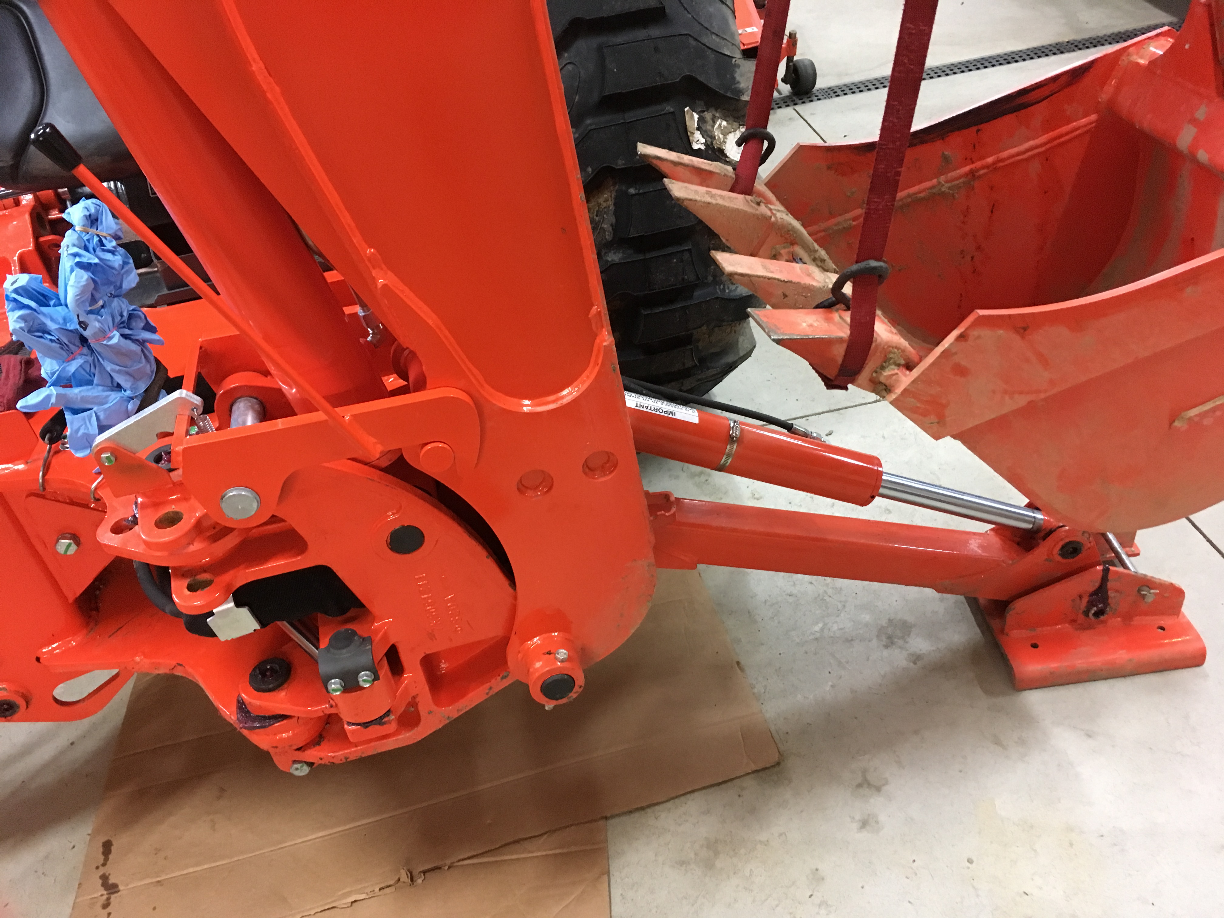

Still no parts but deceided to remove valve block. First, I made sure to releive all hydraulic pressure.
I then labeled the hoses so I knew for sure where they went when I went to reassemble. As I removed each hose pair, I put them in a rubber glove and labled the glove with the order removed.
Only fluid lost was what drained from valve block.
Valve block is now on work bench for a few days while I wait on parts. I already had plans for next few days so even if I had parts, no time to work on installation. Here is a picture with the clamps I plan to use to keep valve blocks together while I remove end block and install new valve. Should be interesting!

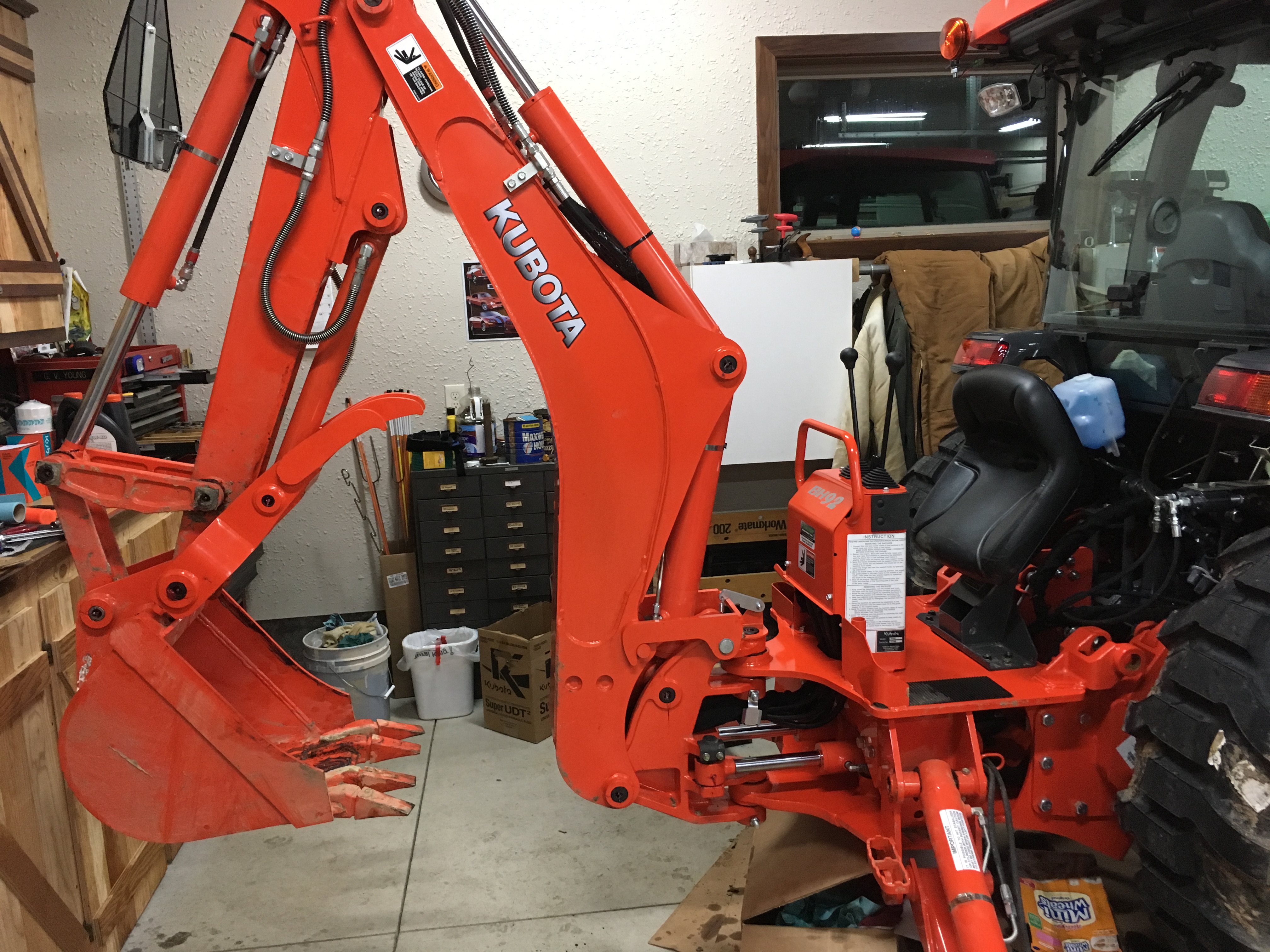

Parts arrived today. So back to work I go. Adding in the extra control valve was not as hard as I thought it would be. The new valve arrived with a layer of misc dirt on one side and a layer of plastic on the other. Of the two, the plastic was by far the harder to remove. Took me longer to clean up the new valve and swap out the shorter tie rods for longer ones than it did to add the new valve. Reinstalling the all of the hydraulic lines was a bit of a pain but not overly difficult.
Okay, who can see the error I made in my setup?
Well, I'll give you a hint.....
I cannot route hydraulic hoses through an internal tunnel at a better than 90 degree bend. My bad!!
Sooo.... What next? Well, I have to get the boom straightened out. To do that, I have to start the tractor, to do that, I have to cap and or seal the ends of the hydraulic lines. Caps at the end of the lines before the new cylinder, provided with install parts, so no problem. I'll just hook up the new lines temporarly to prevent fluid loss and I'll be able to lower the boom. I have some things I have to do in the AM so I'll be starting late tomorrow if at all.

Well I finished up the install tonight.
With the thumb fully open, it was hitting on a cylinder hydraulic fitting. I tightened the fitting slightly to eliminate the contact point. Now the cylinder just bottons out.
Straightening out the boom made hydraulic hose much easier.
A couple of things I would have done differently, when I went to straingten the boom, the hoses for the thumb cylinder filed with fluid but did not flush through the air so when I needed to remove these hoses, considerable fluid came ot and ended up everywhere. I should ahve laided down the booom before I started.
Another thing was the foot control and its associate linkage. I did not adjust it when I hooked it up because it was on the work bench with no reference on where it needed to be adjusted. I should have adjusted the foot pedal as soon as I mounted the valve block back on the tractor. I waited until I had all of the hoses reconected. This made it almost impossible to even reach the linkage, let alone adjust it. I ended up removing a couple of hoses and bleeding even more hydraulic fluid on the floor. Live and learn.
Bottom line is it is all installed now. It I can, I'll test it out tomorrow.

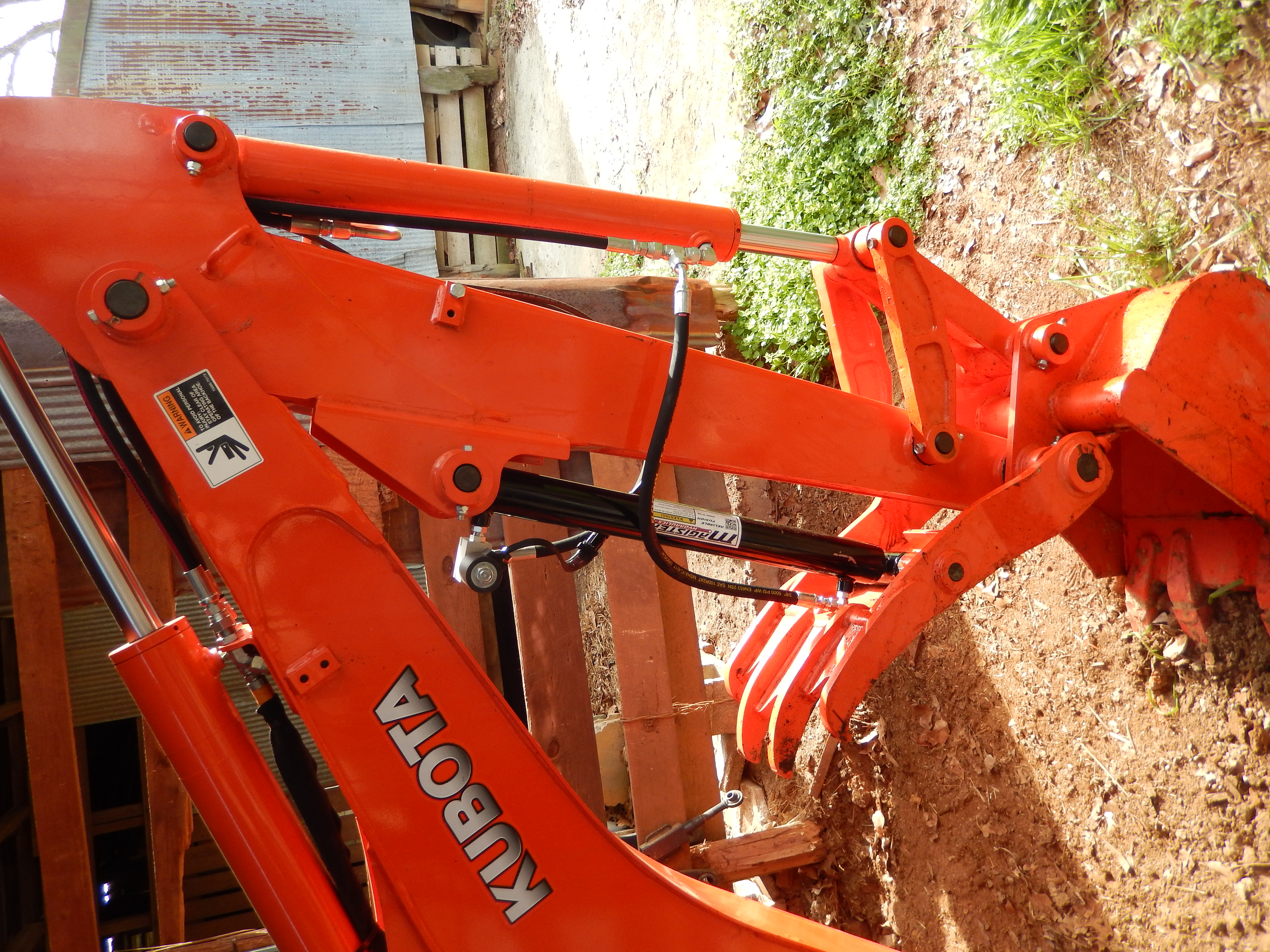

Will do. Overall, If I had extended the boom at the start and adjusted the foot pedal when initially installed, this would have been a painless modification. The way I did it cost me some hydraulic fluid. While not free, the cost was minimal compared to the cost of dealer install. Pictures requested will follow tomorrrow. As far as initial testing is concerned, I love it! No hydraulic leaks was a plus. I've picked up trees to make them easier to cut into fire wood and cleaned up a drywall dump site I established during house construction.

Any pictures of setup?
Here are the pictures of my setup as requested:
I forgot to take pictures of my switch setup though. I have a push button on the joystick that when pushed opens the valve on the thumb cylinder.

Big bite...
Weight was too much for backhoe, It started to lower load when I attempted to raise the log. I love this thumb!
