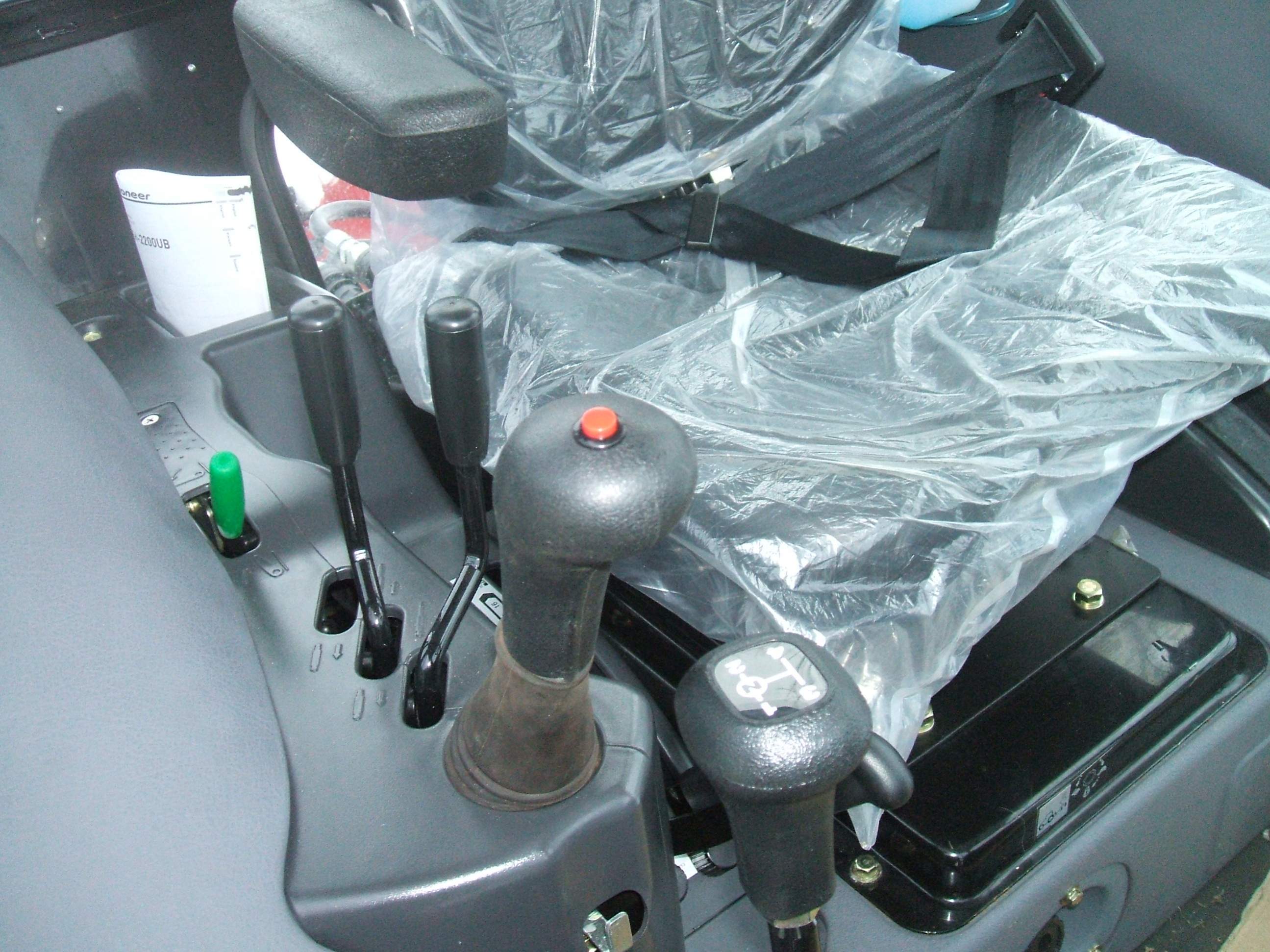

I am thinking of putting an electric diverter and additional hydraulic lines on the loader for grapples and such. I notice that there is a plastic plate, on the face of the loader control handle, that looks like it can be replaced by installing a switch. Can anyone tell me what will fit in there ?

It may be a while before I can get a picture. I'll probably have to take it off to get a clear picture. It's about a 1 inch square flat removable piece in the face that will come out if you split the handle into 2 pieces. The plate is right where your finger tips would touch if you grab the handle while on the tractor.

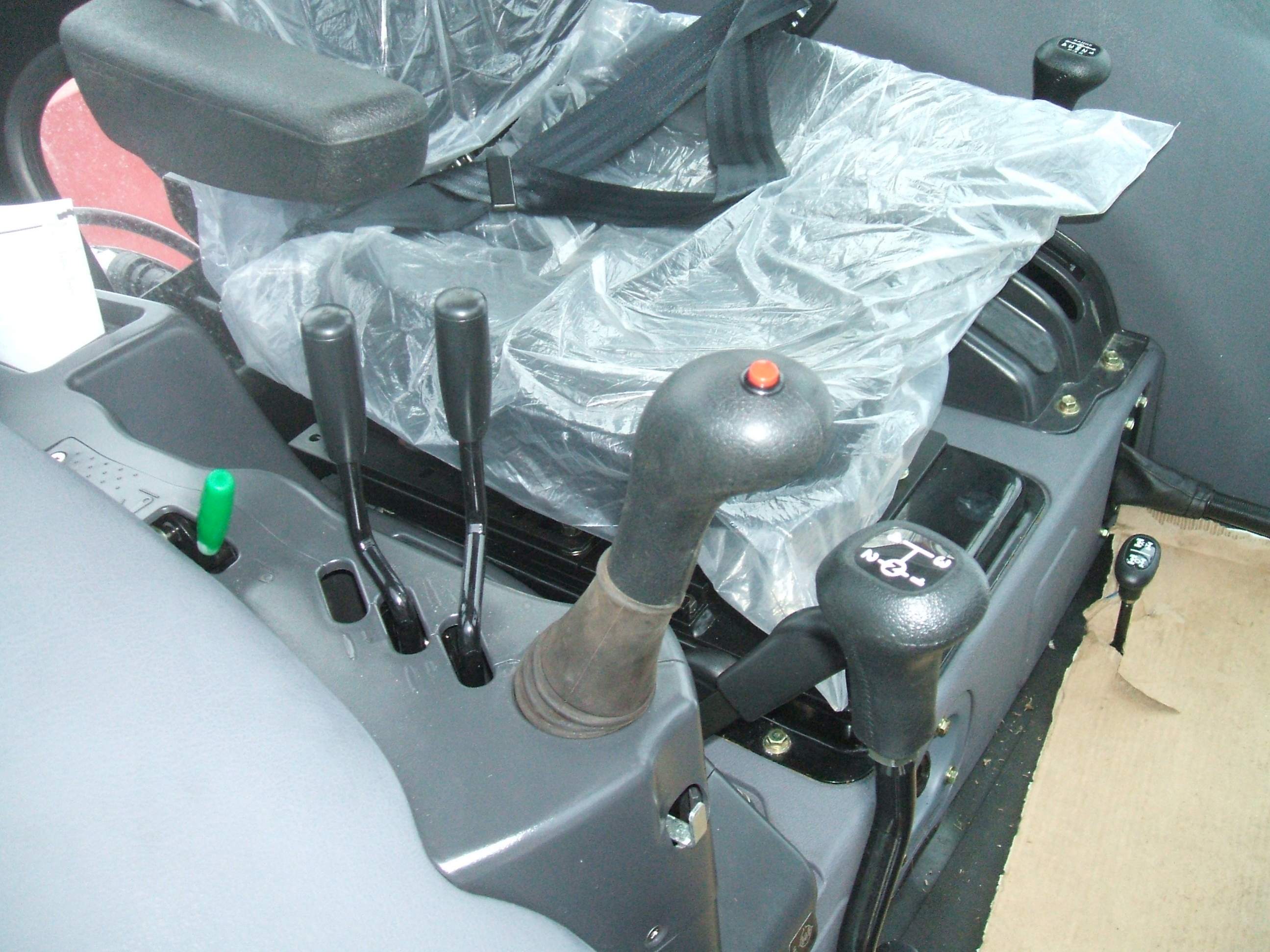

this is what I did to mine.Went to radio shack and bought a button,drilled a hole on the top of the knob,heated up a piece of coat hanger wire and ran it up inside of the knob to fish a wire threw to connect the button.very easy and looks good.next I have to hook up the valve and hoses

Looks good !!
Your FL handle is different from mine. The top of mine has the pattern on how the loader works about the size of a 50 cent piece. The inside is hollow so I wouldn't have to use the coathanger method. I haven't heard anything from the dealer, but I did find the same handle in a Stoll FEL manual on line. It shows either 2 or 3 buttons in the handle.

I bought a switch that fit at Radio Shack for a couple of dollars. There are three spots in the face plate, in a triangle configuration, that I can use. One for the diverter. I may add a horn and additional works lights to the other two places.
