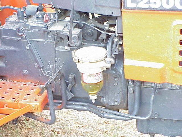

I had a Racor 200 and 500 sitting around for 23 years but never had a use. They were left over from when I was a mechanic. Somehow they made it through living at home, then an apartment, then a second apartment, then 2 houses. My Dad kept them around before I moved into the houses. I looked and Racor elements are found everywhere. I used the 200 because it's smaller, the 500 is a better filter and separator but just to tall. Made a bracket and replaced the OEM filter. It's tucked just enought that it's protected. The bracket is angle oron.
I have drained a bit of water out of this one. Seeing is believing as to what ends up in your fuel.
