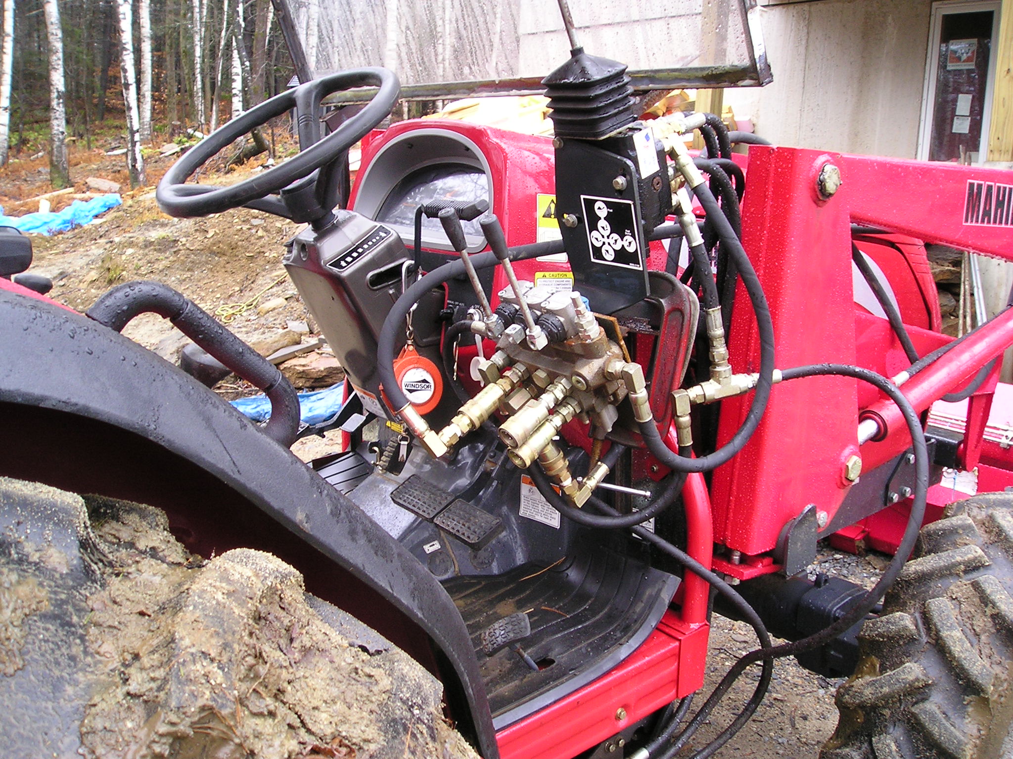

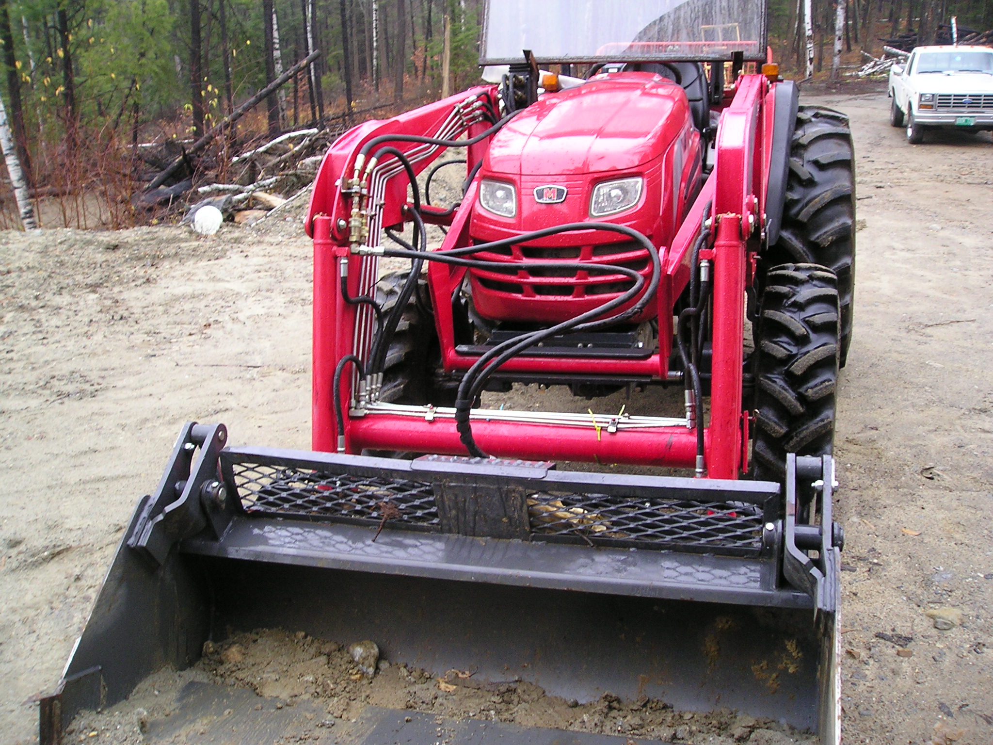

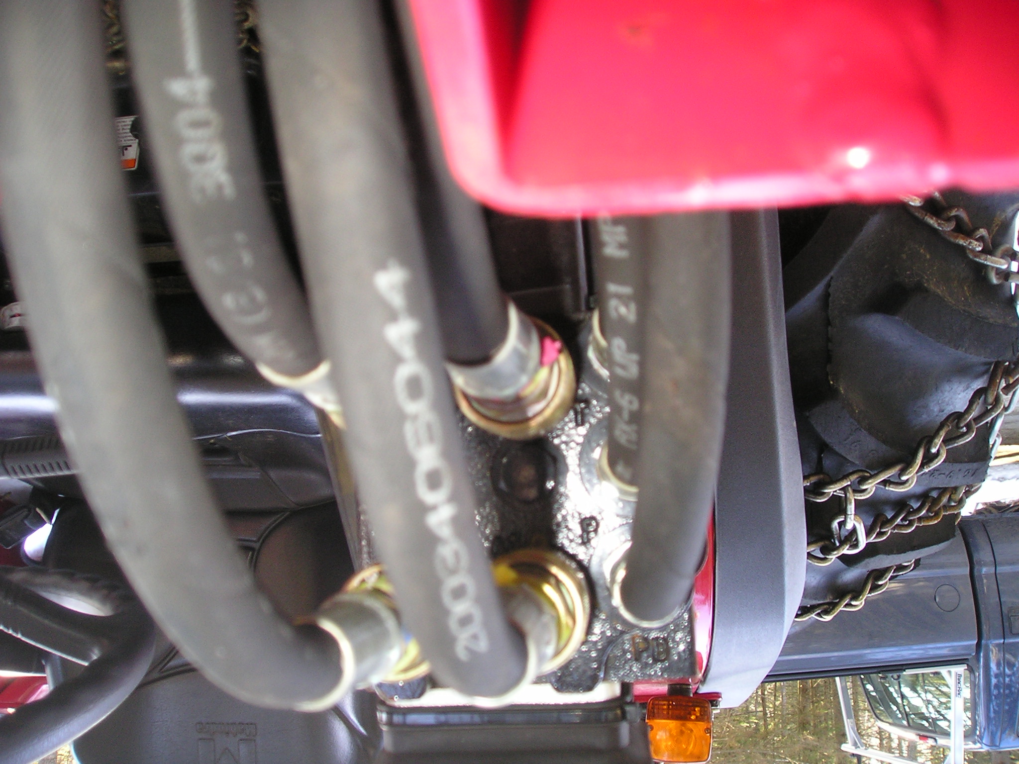

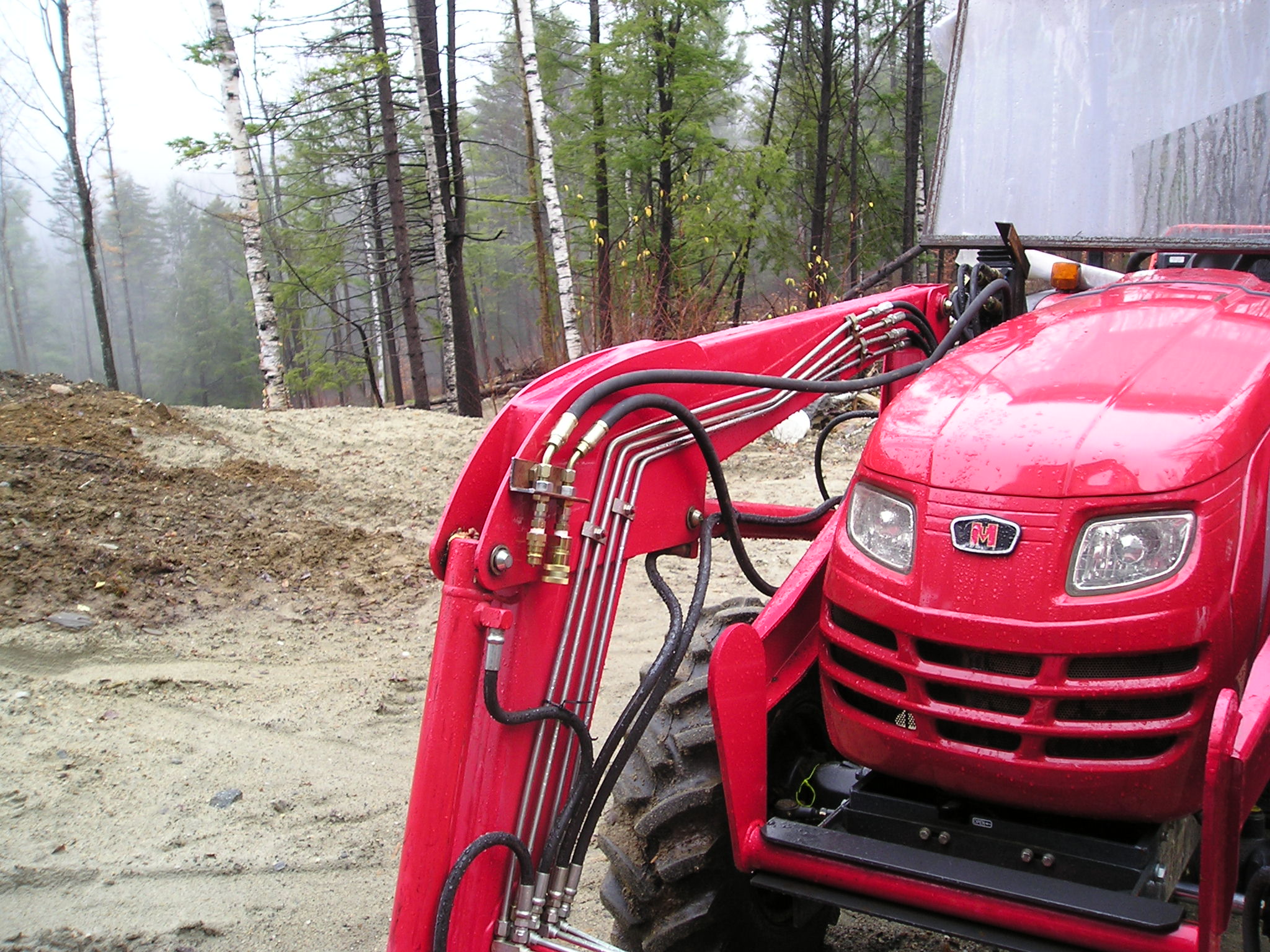

i've finally added extra hyd valves so that i don't have to keep changing hoses
on my rear remotes and easy use of front attachments. in pics 1 & 2 are of the loader valve

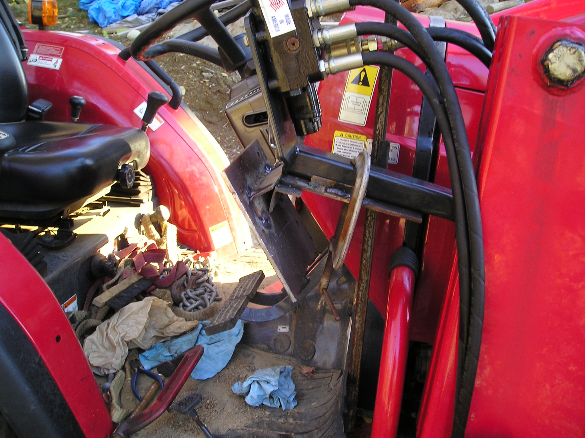

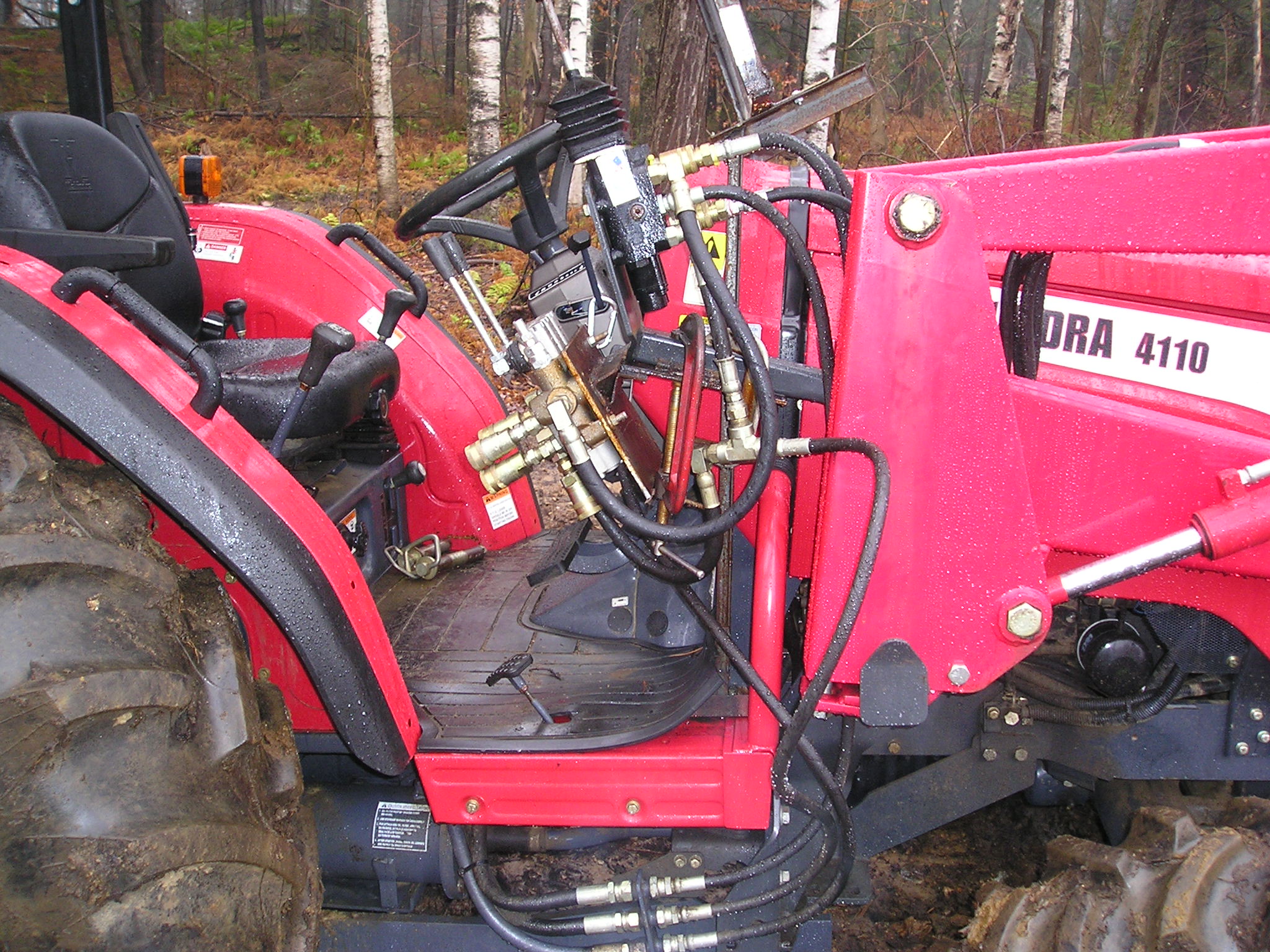

in pics 3 & 4 are the mounting brackets

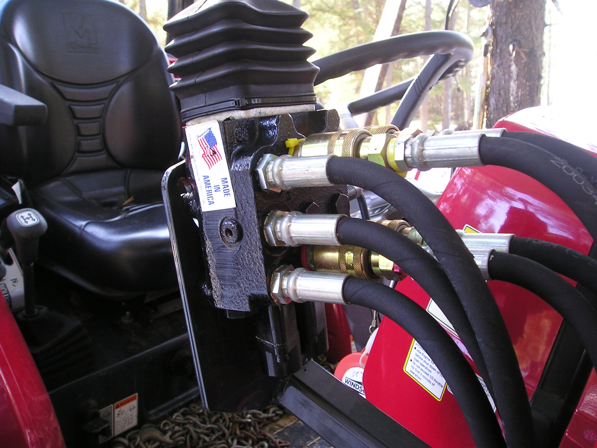

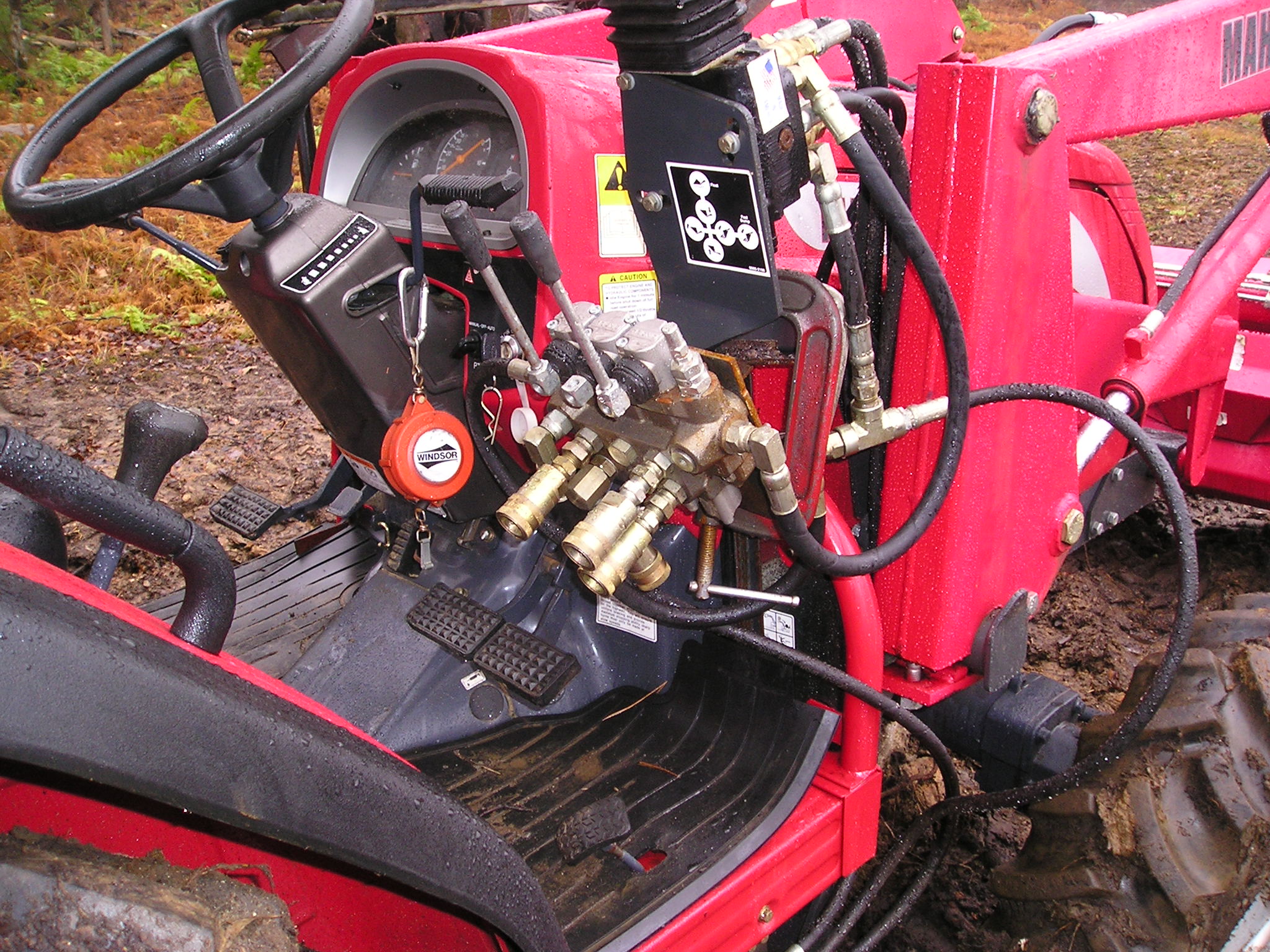

5 &6 are the bracket and plate with the valve

   / adding extra valves
pics 8,9,10 are the rest of the install to the front of the :) loader
   / adding extra valves #6
That'll work out pretty neat. Just have to remember which handle does what! Do you think you saved a considerable amount vs. using an ele/hyd. switch? If you mounted the new valve "backwards" would that have kept the operators platform a little cleaner looking?
tbluser the operator's area will clean up better after i change the rest of the
hoses to the right size & fittings.by "backwards" do you mean with the valve
facing forward or on the fender?
   / adding extra valves #8
With the valve qd's facing the front of the tractor.

JPM… interesting setup. I too have a 4110 with same joystick and have a need to install extra hydraulic valves to accommodate my quick-attach front mounted hydraulic angle snowplow. The plumbed snowplow operates off the rear auxiliary hydraulics. Also, I have and wish to keep mounted, the 509 backhoe, which is great for ballast. I need to maneuver the backhoe and snowplow concurrently when backing into and parking in the garage. Being one valve port short, I manually switch the quick disconnect lines to operate each implement.
Being a novice at hydraulics, I have questions. How many auxiliary ports have you increased by? Is your setup diverter valves?
I only need an additional one and was thinking more in the way of a tee or a 3 port diverter valve (I don’t know what a diverter valve is).
Tlbuser, can you elaborate on the use of an electric hydraulic switch? Would this accomplish my needs?
bill b , I added 3 spools 1 for the front ,1 for tnt ,1 for the heck of it.you can add 1 thru ? valves this way just as long as you have a power beyond valve which continues the flow to your rear remotes. Diverter valves i've seen on this site are usally only 1 spool and you have electric connections to deal with,though it seems most people here have no problems with it.One thing to look for is a light weight valve,you only need 15 gal.flow,i think mine is a little less
