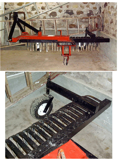

I just picked up a 6 foot King Kutter landscape rake for $224 at Central Tractors liquidation here in the Vestal, NY store. (I also picked up a 6 bushel spreader for salt for $210) I think I got two pretty good deals. What do others think? Also, I'd like to add gauge wheels to the landscape rake for gravel drive work. The CT catalog listed a gauge wheel option for $189 list, but this was special order only, so no go under liquidation. Can I make them myself or are they cheap enough to justify buying them. Where can I get them? Do they need to be specific to the rake, or is there a supplier of a generic add-on. I'd like to use a pair at each side, rather than one in the middle.

Pault,I made gauge wheels for my 6ft. rake that I got at CT for only $100.00. It was missing the top part of the 3pt. I just used some scrap steel I had on hand and ordered the tires and wheels from Harbor freight for $8 each. It does make a big difference having the wheels. Attached is a photo of the rake with wheels, as well as the stand that allows me to roll it around.

Pault, You can see the add on wheels I made for my rake at:
http://www.mgsweb.com/tractor/hacker/rake.htm
The wheel hight is adjustable. The wheels swivel and have 10" air filled tires. I have used this setup for 3 years and in the winter I bolted a steel plate to the rake tines and used it to plow snow before I got a rear blade. Works pretty good for plowing and the wheels are great for all uses.
