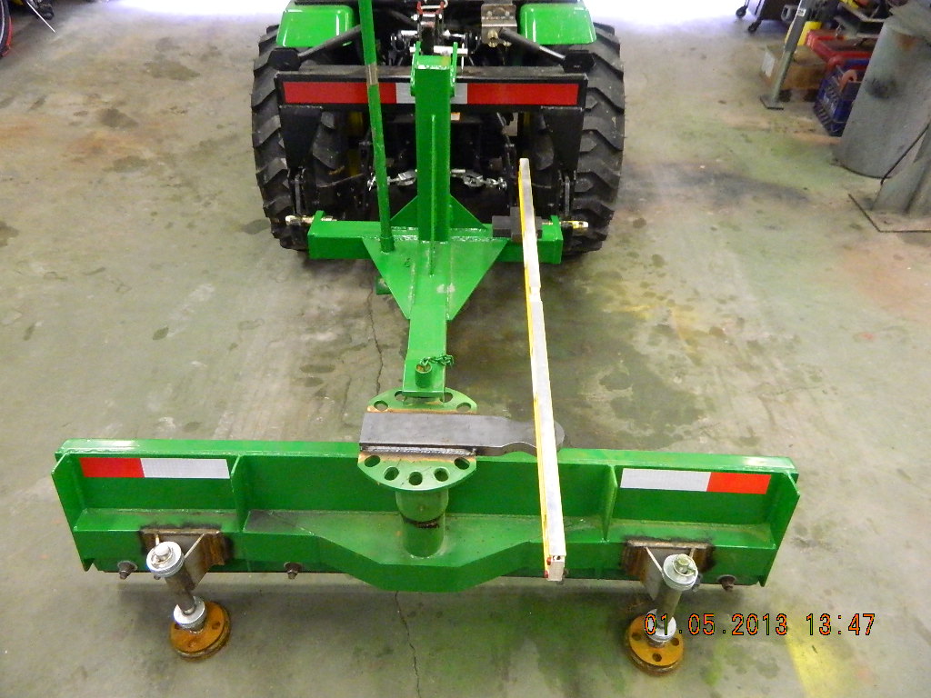

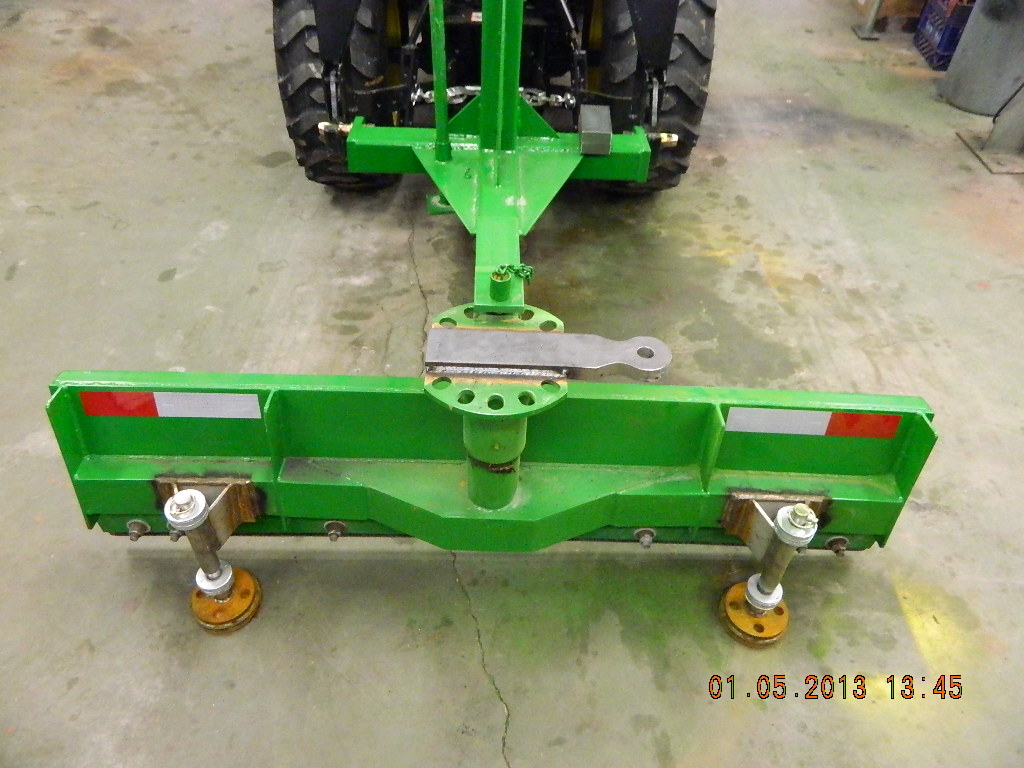

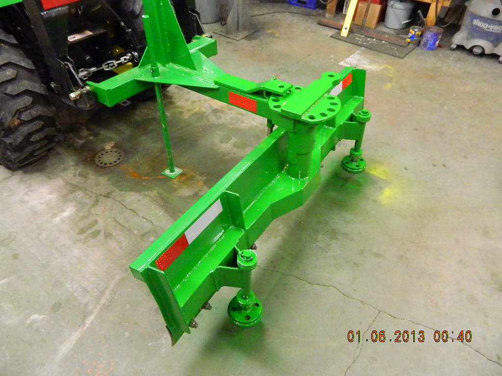

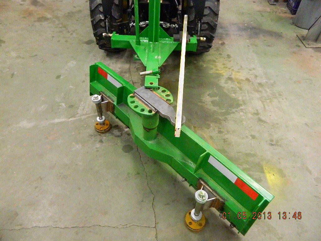

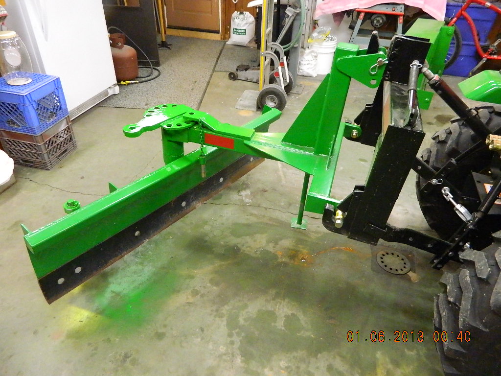

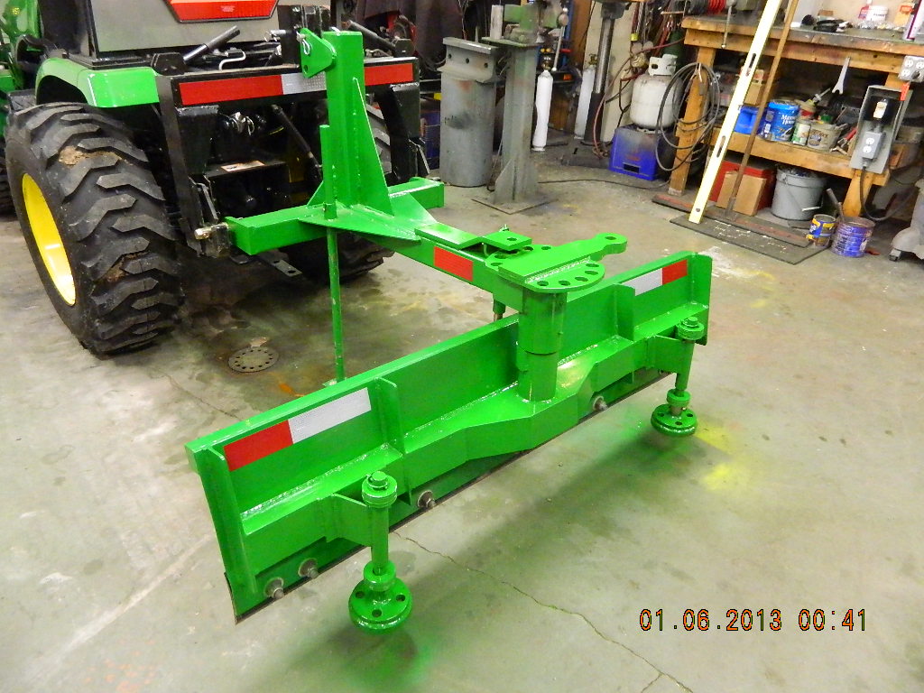

This is my TSC rear blade I am adding hydraulic angle to.

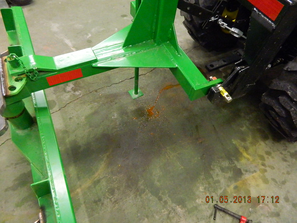

I also want to point out that the tubing was holding water and a drain hole should be added to prevent rusting and damage to tube during cold weather due to expansion of ice.
I ordered a 3" x 12" 3000 psi cylinder from Surplus Center.
The 3" bore cylinder has a 1-1/4" shaft and will be less prone to damage if bumped in the woods.
12" stroke completes the same left to right angle as the factory holes.
I will wait to weld the front mounts until the cylinder arrives.
The blade can be rotated 180 deg. and the cylinder reattached on the opposite side for reverse blading.

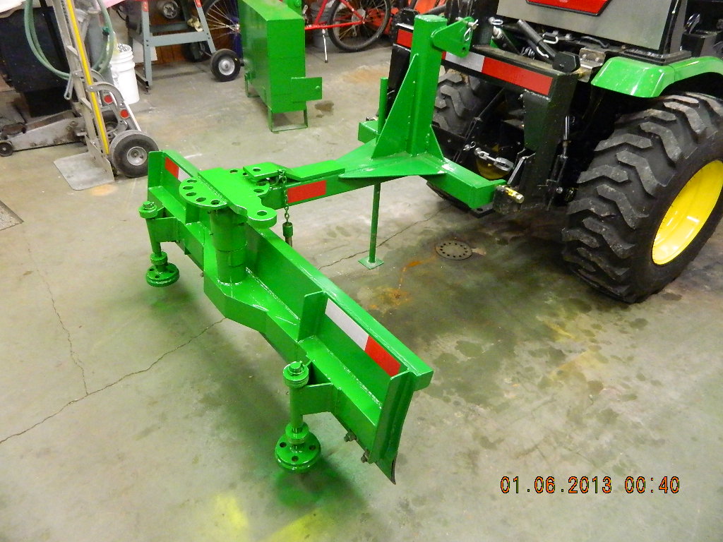

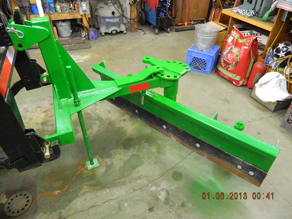

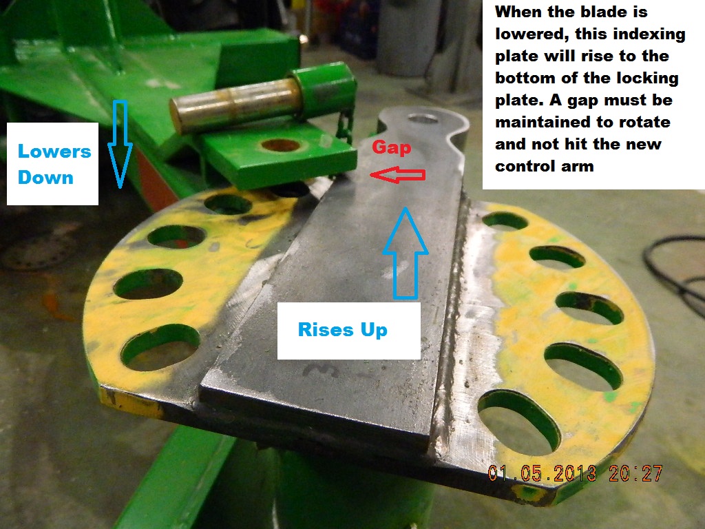

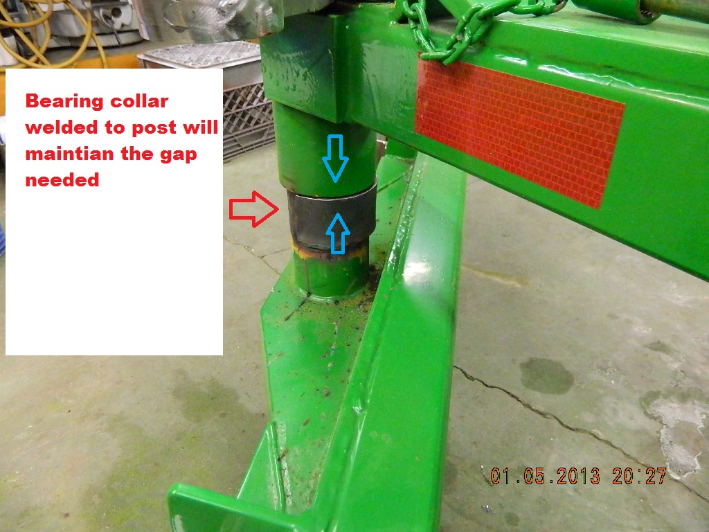

Added a bearing collar to maintain spacing needed for new control arm clearance.
Blade will be able to rotate when in the lowered position.

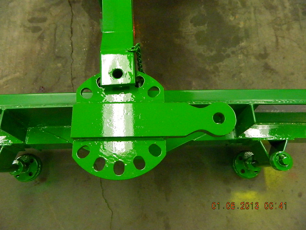

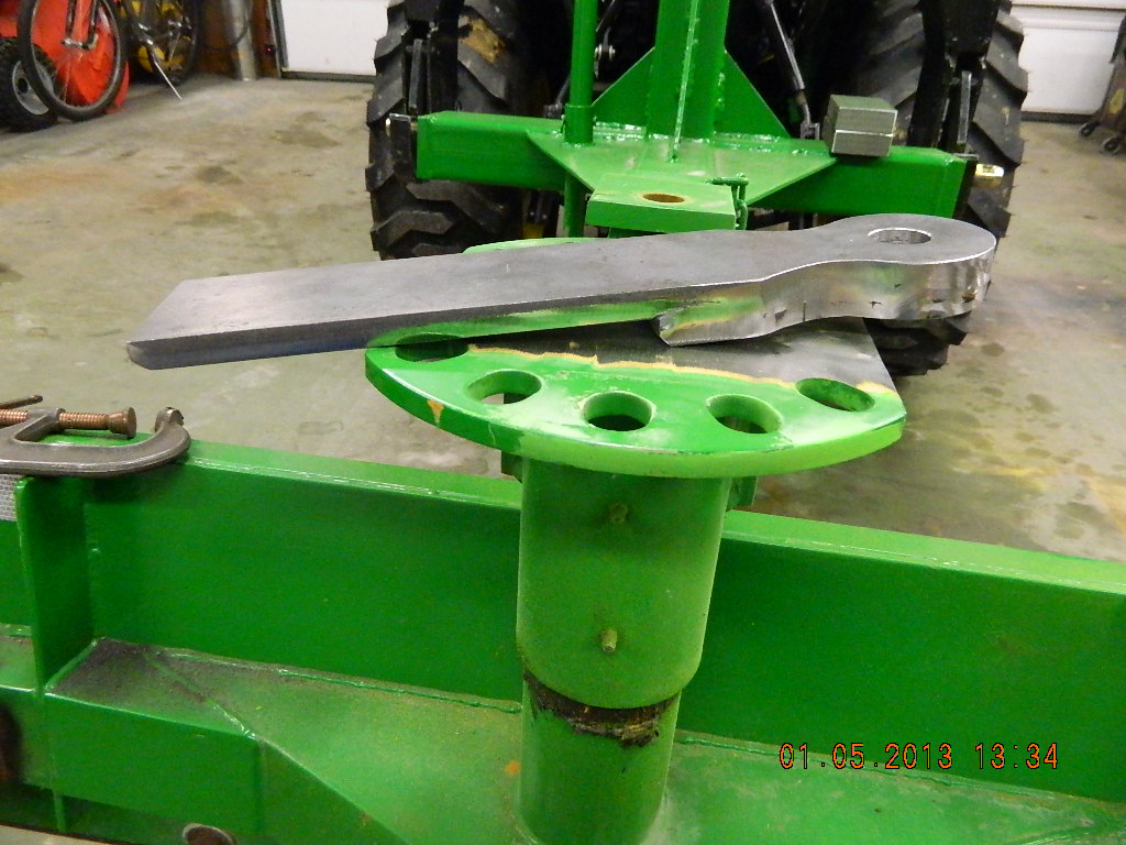

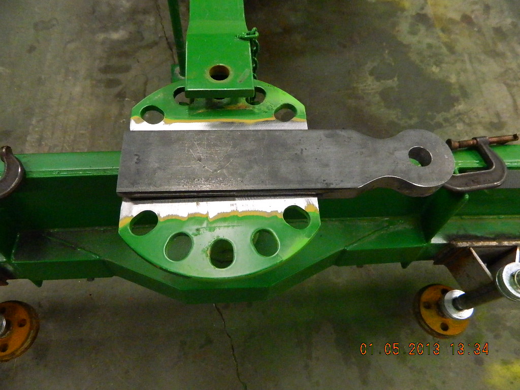

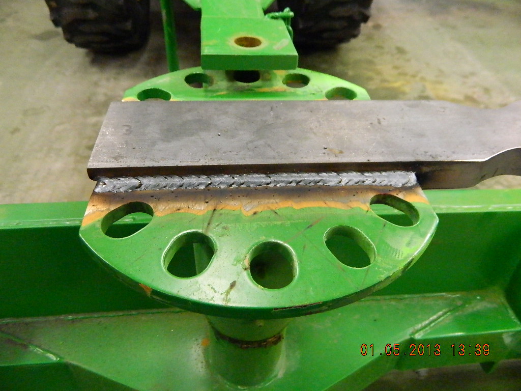

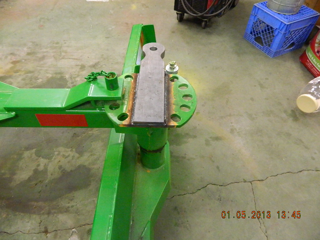

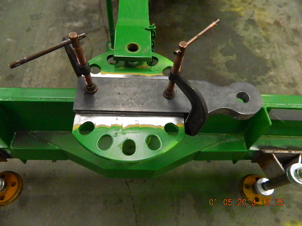

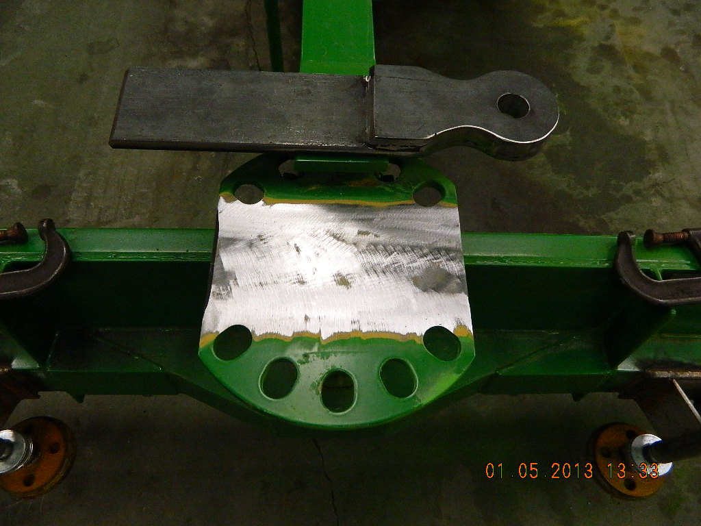

   / Adding hydraulic angle to rear blade
1/2" x 3" plate.
Doubled where cylinder connects to add strength and remove slop in the tie-rod cylinder end.
