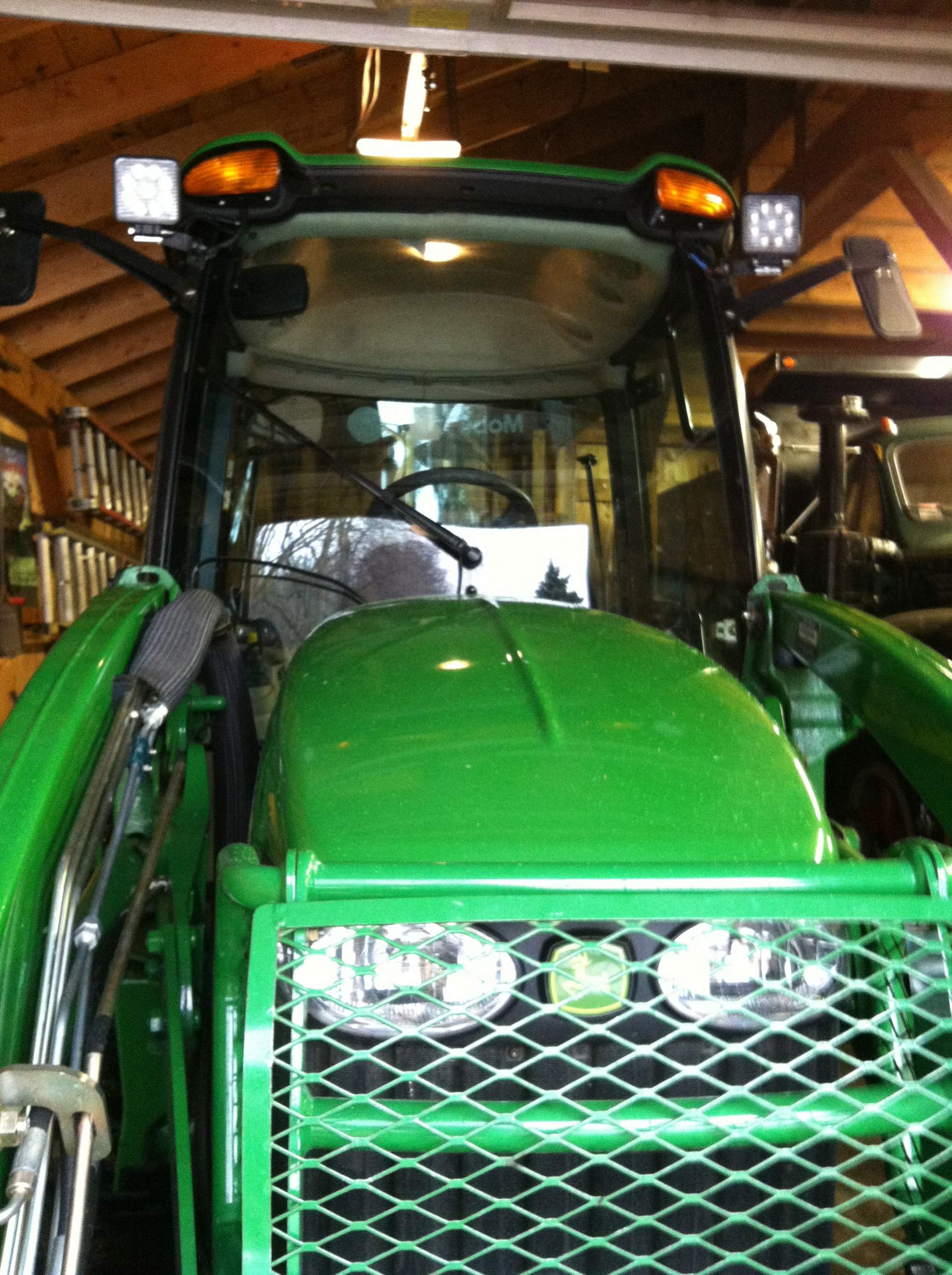

I bought a pair of Tuff 4" LED lights to replace the factory cab mounted halogens. I noticed that these things only draw 1.9 amps. Any chance I could keep the two halogens (point them to the sides) and utilize the LED's as the driving lights? The cab worklight circuit has a 30 amp fuse that feeds 4 worklights-two in front, two in back.
I would just jump into the existing feed wires.
Opinions?

Correct-only the four cab worklights are on that 30 amp circuit. I made brackets yesterday and was trying to keep the factory halogens in place as well. I had guys telling me however to "forget it". the LEDs will be more than adequate on their own. So I hooked one up on one side with the factory light in place on the other- case closed-these things border on "hazardous".
Pix to follow.

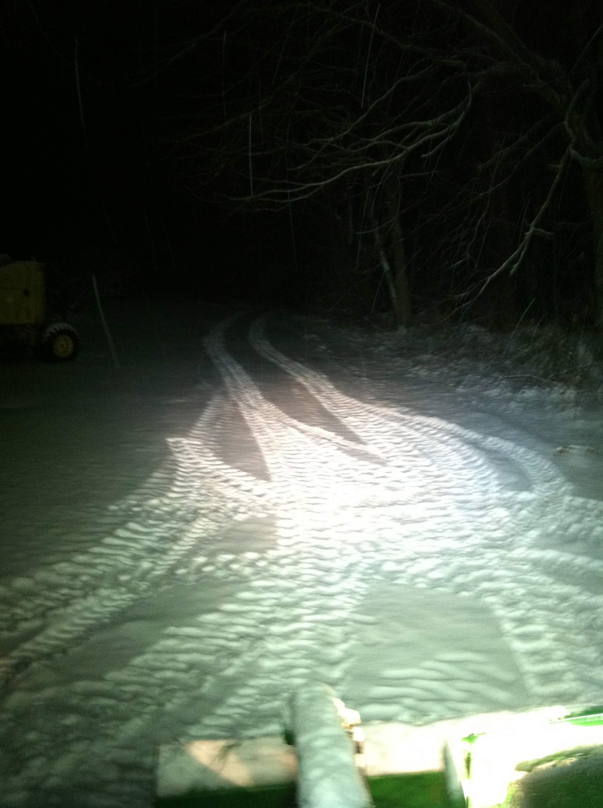

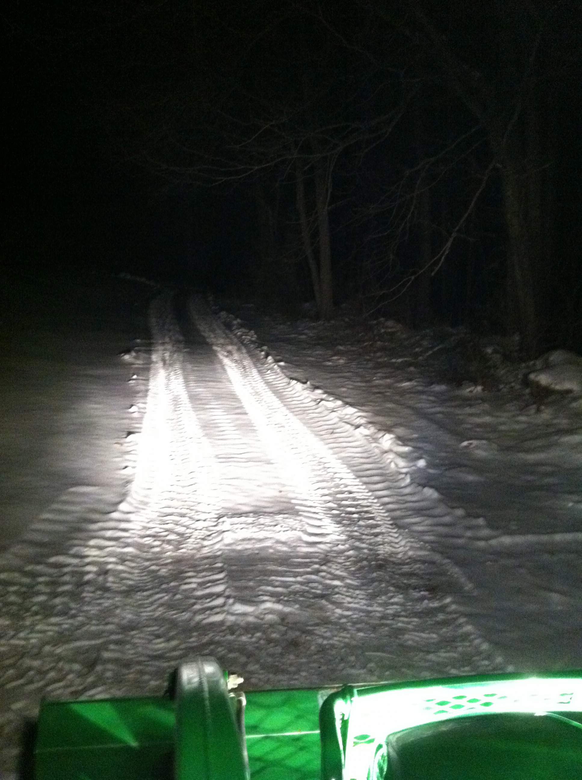

Well you were right on as far as washing out the halogens. I installed an LED on one side while the halogen was hooked up on other side-case closed. First picture is with originals, next picture is two LEDs. Pictures don't do justice to the superior power of the LEDs. these are 1550 lumens
