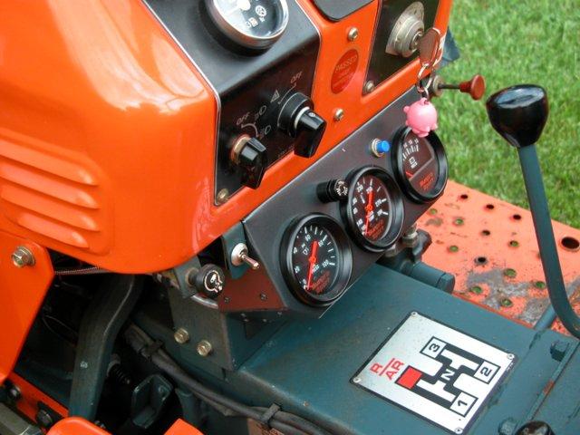

Other than the price, the JEGS gauge looks fine. I spent about $18 total on the three gauges I added to my first tractor, and never had any issues with them. The oil gauge came with a variety of fittings, and I just added a brass tee where the sender unit was screwed into the back of the engine block, keeping the sending unit. Voltmeter is easy, and usually there's a place on the cooling system, maybe at the thermostat houseing, for plumbing in a temp. sensor. Certainly, enclosing the nylon oil tube in another line would protect it from heat to some degree. Knowing pressure, temp. and voltage can warn you of many potential problems, and the idiot lights will still be there.
