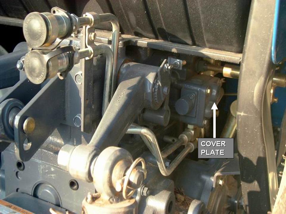

Unfortunately, your first listed prices are about as good as it gets these days. When I installed my remotes back in 2001 the first valve was $250 and the 2nd and 3rd valve were $215 each. All three remotes were less than $700. But that's all ancient history. Here is a photo of me installing the valves.
Next is the end plate that has to be removed on the side of the hydraulic assembly. It's shown on the outside of the 1st remote in this photo.

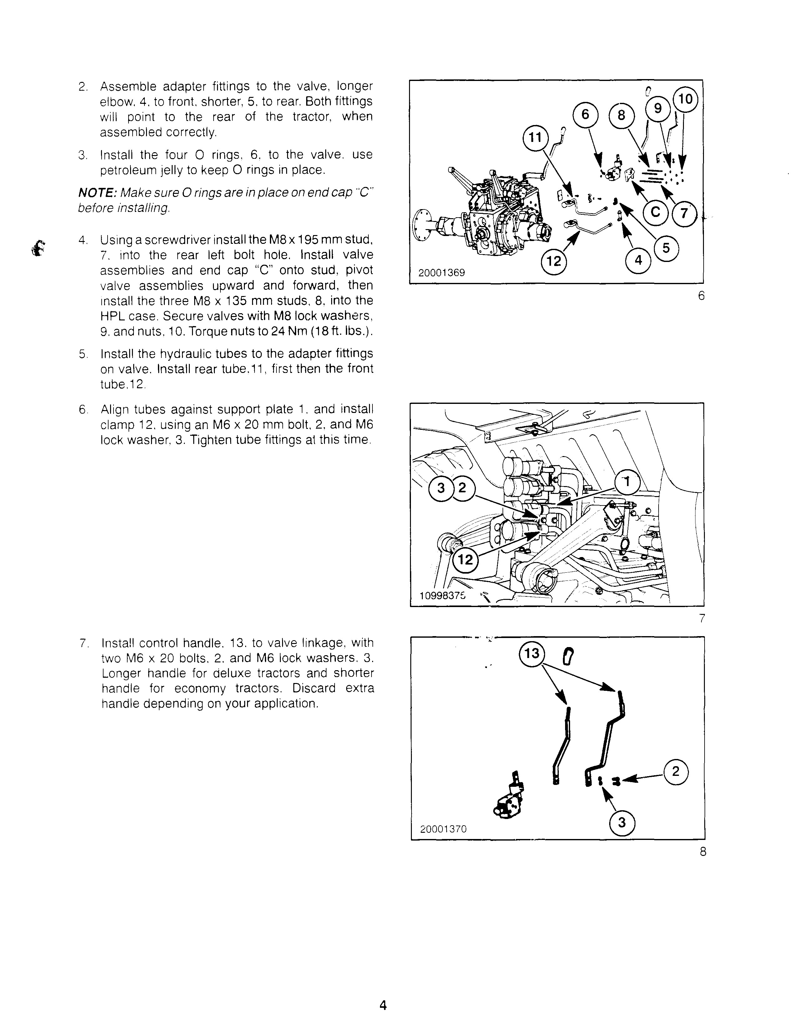

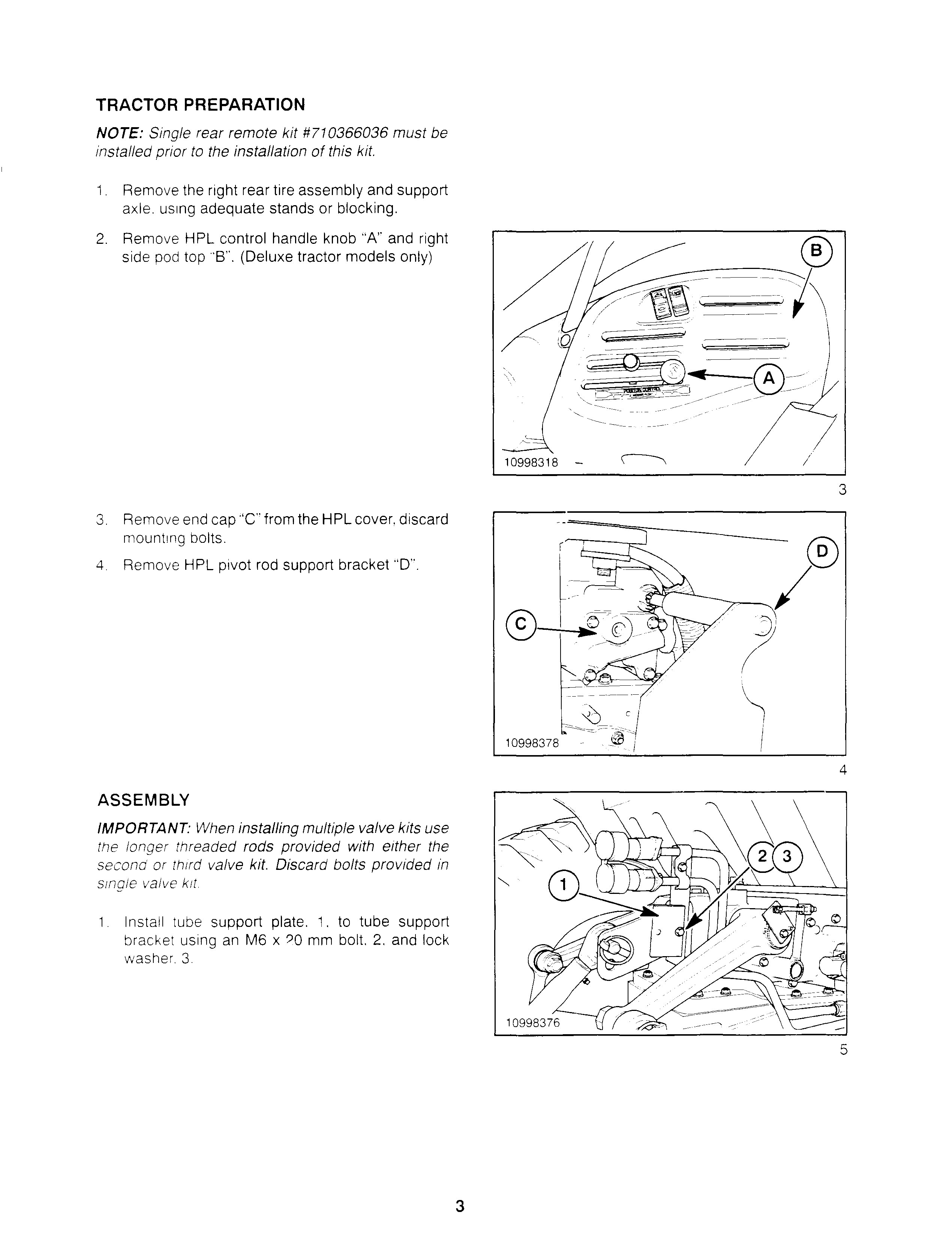

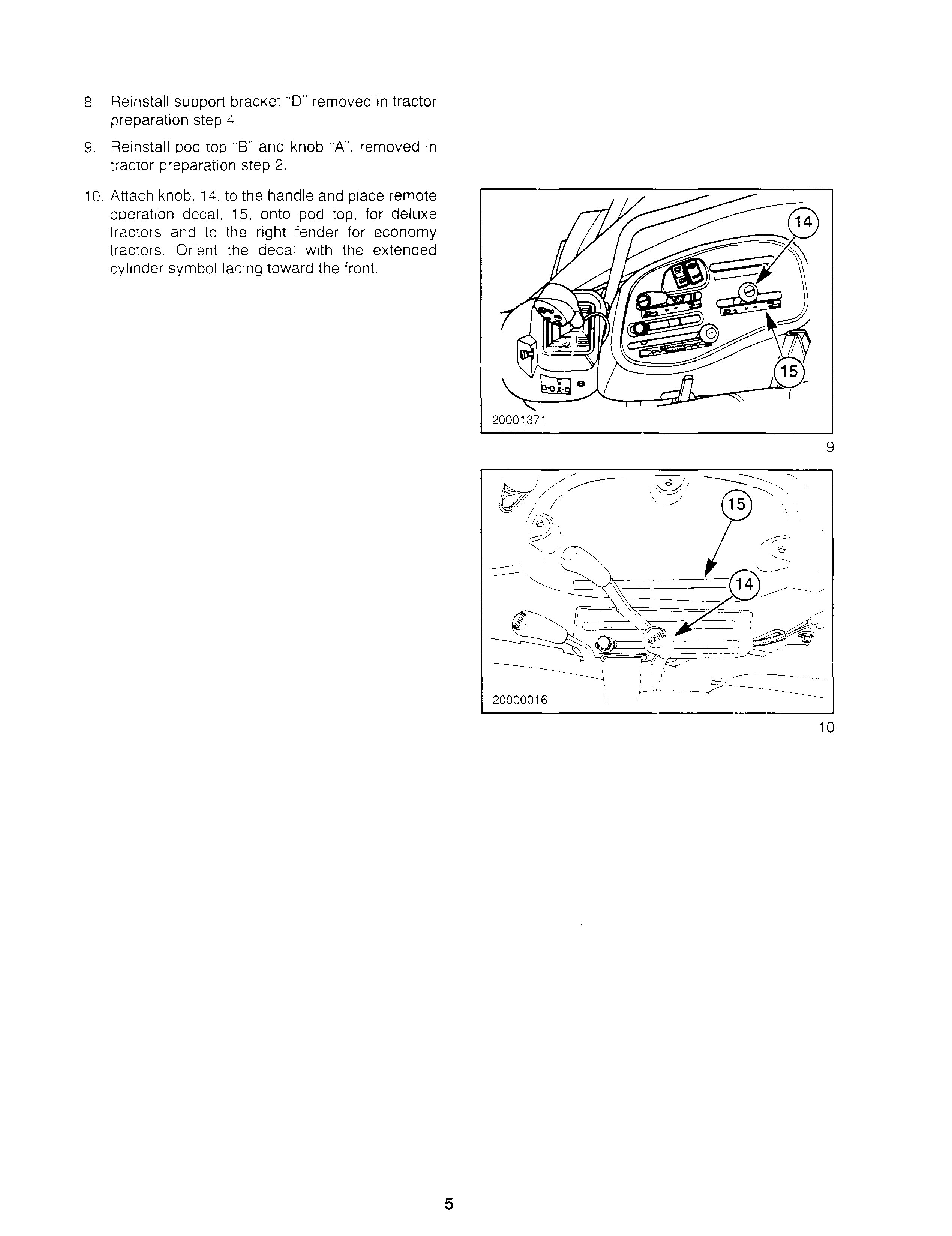

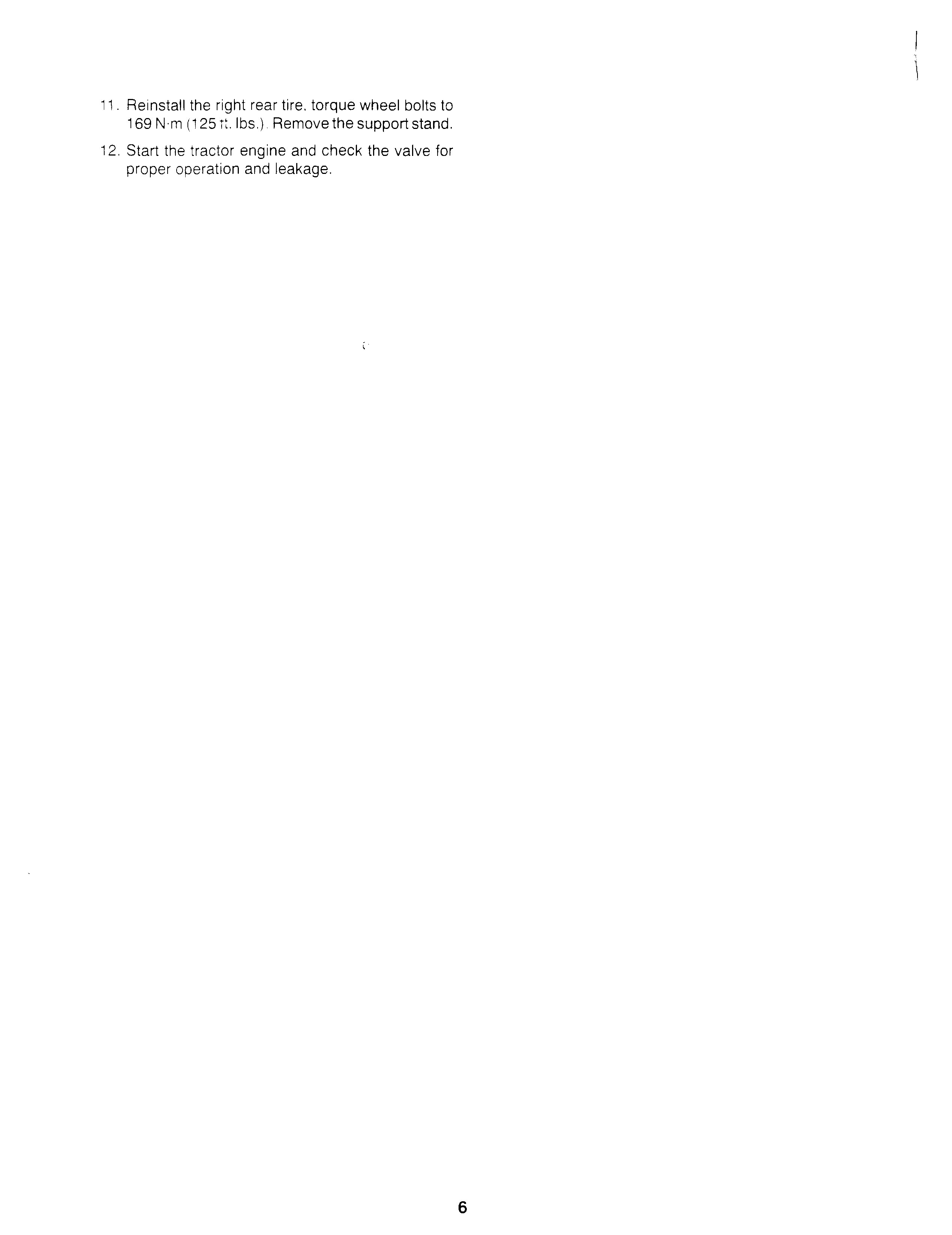

Attached below are the instructions for the 2nd remote. My first remote was installed by the dealership, so I did not get the instruction sheet for it. I didn't send the instructions for the 3rd remote because they are essentially the same as the ones for the 2nd remote. Note that the parts in the kit come with two handles. One is for the economy TC45A tractor. Your DA model will use the deluxe handle and you get to keep the economy handle as a paperweight.;)
