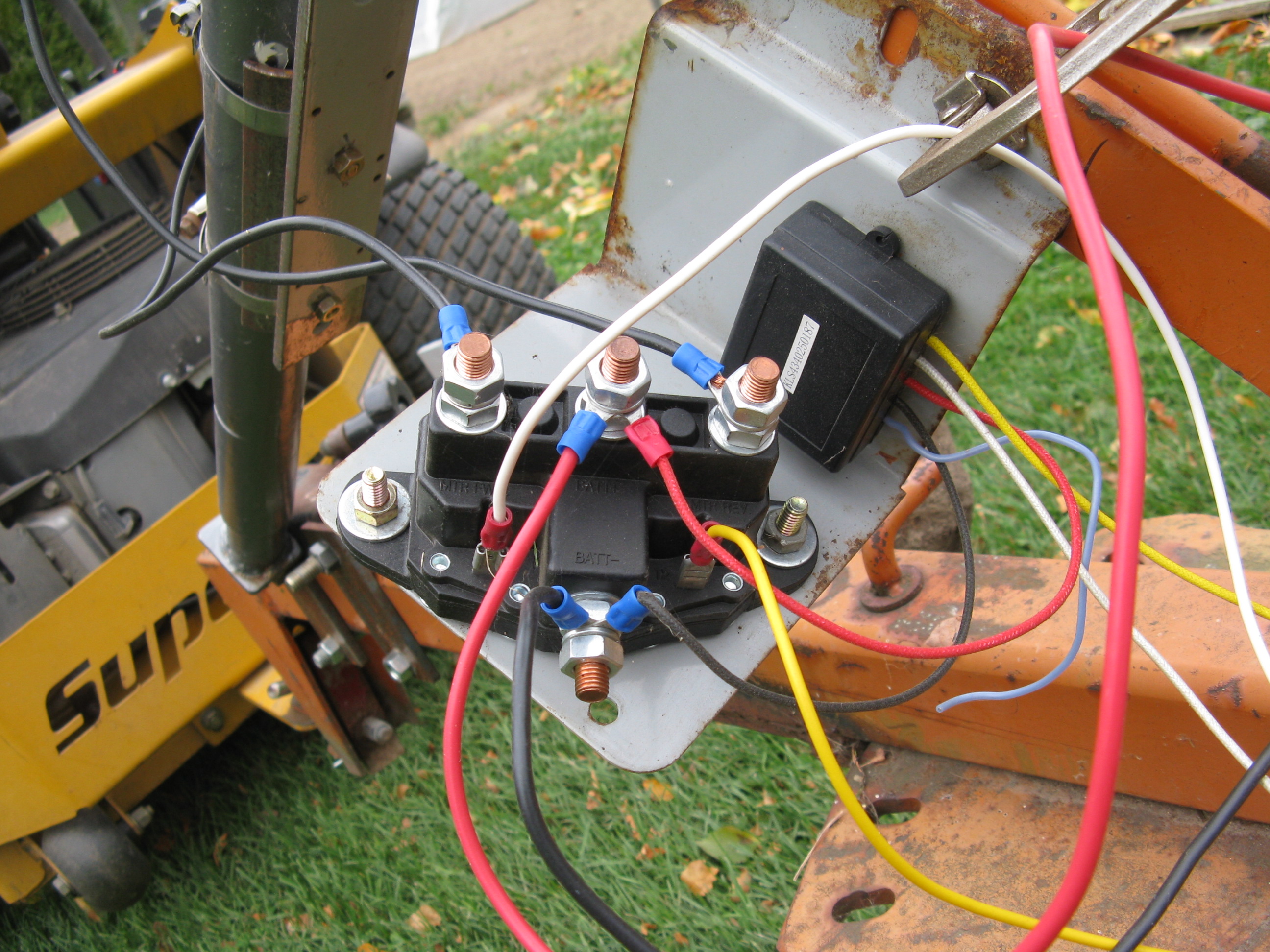

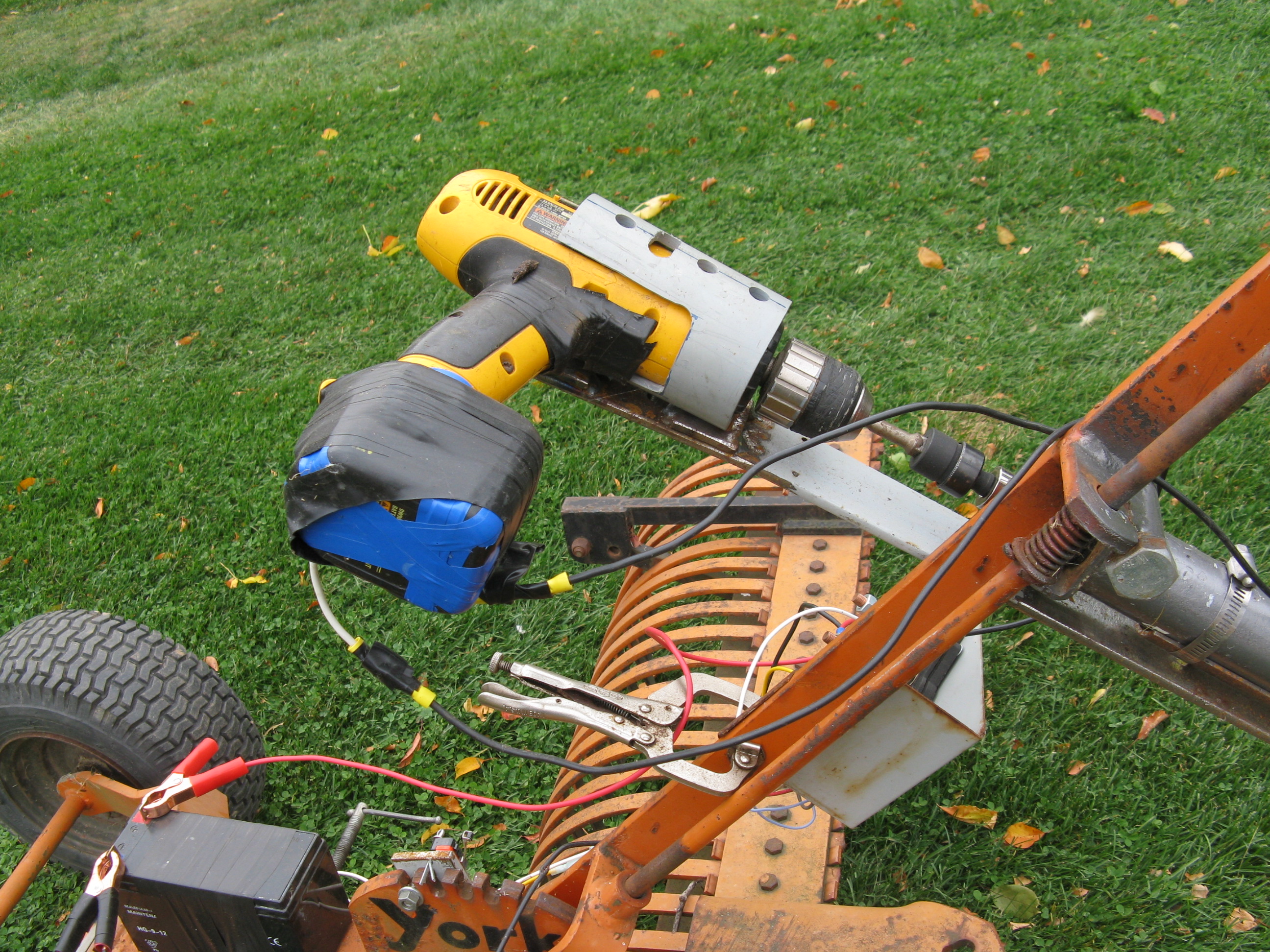

I used a trailer jack and 12 volt cordless drill to make my remote lift control.
I took the switch and battery cells out of the cordless drill.

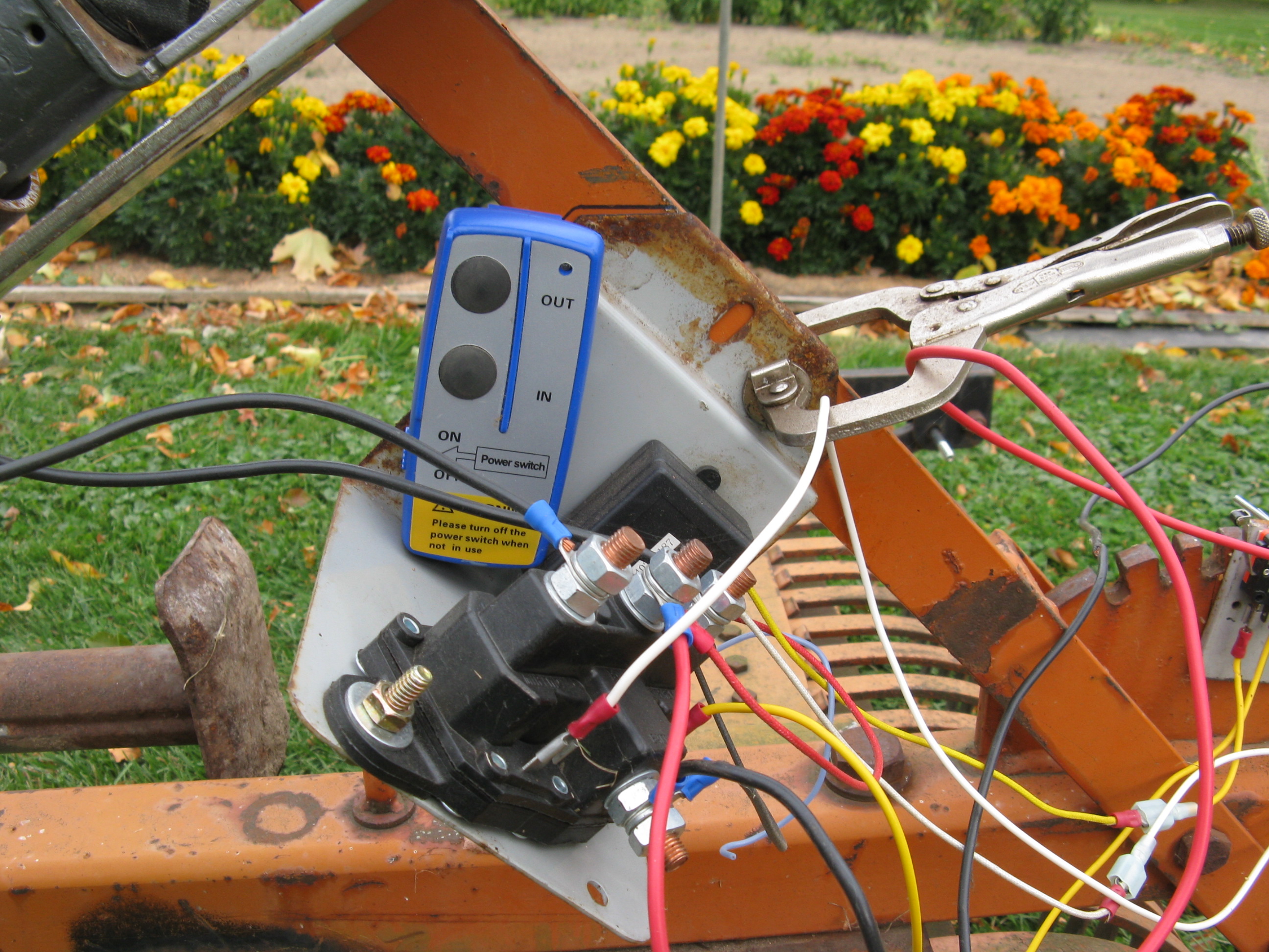

Wired the drill to a winch control for up and down action.

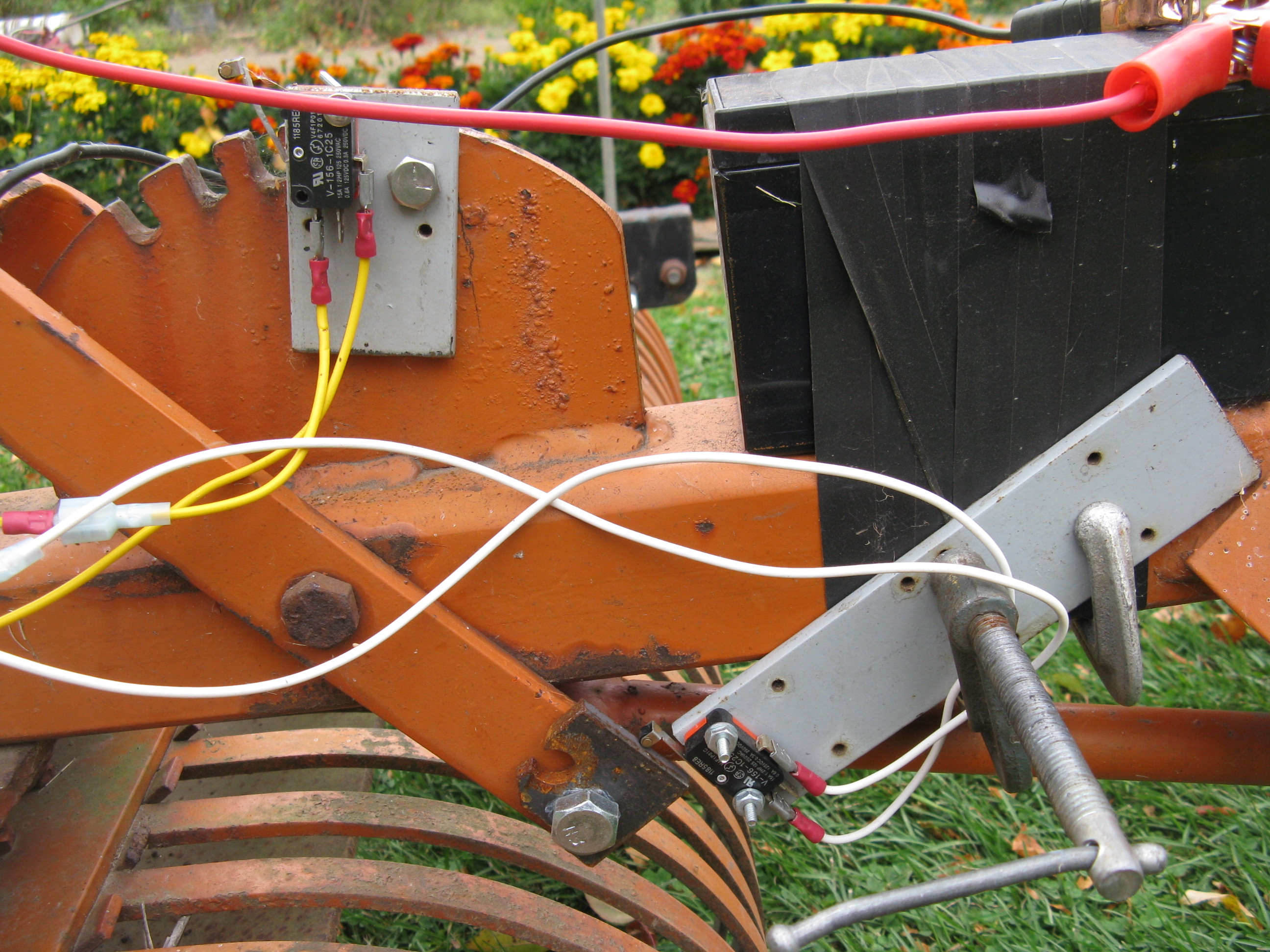

Installed limit switches to shut off drill at max up and max down.

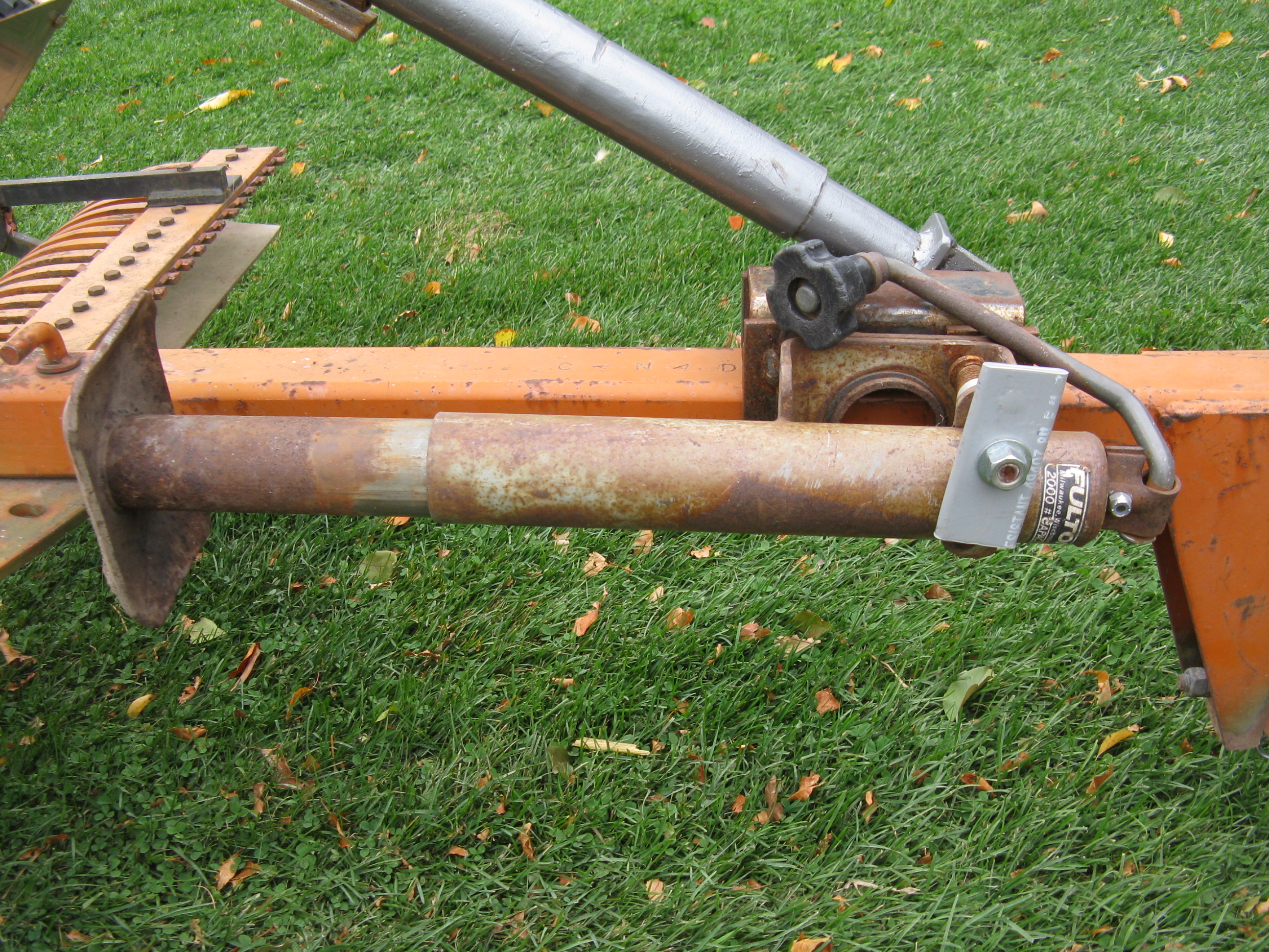

I also added a swing jack.

I like it , nice touch adding the limit switches to.
   / Adding remote lift control to york rake #3
Now we're talkin' ! Thats a project, all the details worked out too. Very cool. Be sure to post when you have it all buttoned up!
