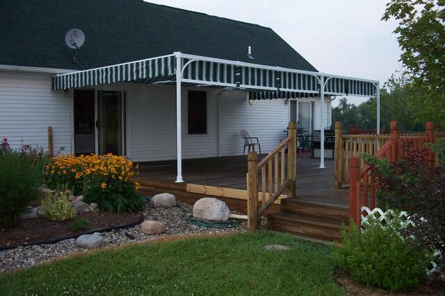

Last summer we put up a shadetree awning. It is made of canvas and slides in runners. It is very similiar to the canvas and guide design that you mentioned. The shadetree products can be ordered with aluminum or plastic support beams, or you can order it to mount directly to your wooden structure. We really like ours.
ShadeTree
   / Adding roof on patio, want to dodge mistakes #7
I've attached a pic of my awning. There are five sections of canvas that can be easily slid back toward the house to reveal the deck to the full sun (if desired)
Jerry, yours is VERY close to our "vision". Cut yours in half, and instead of two posts away from house, the house (mine) is "L" shaped, and I only need ONE post to tie to. Otherwise, you're about dead on to what we are currently envisioning.
