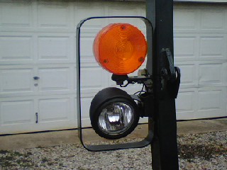

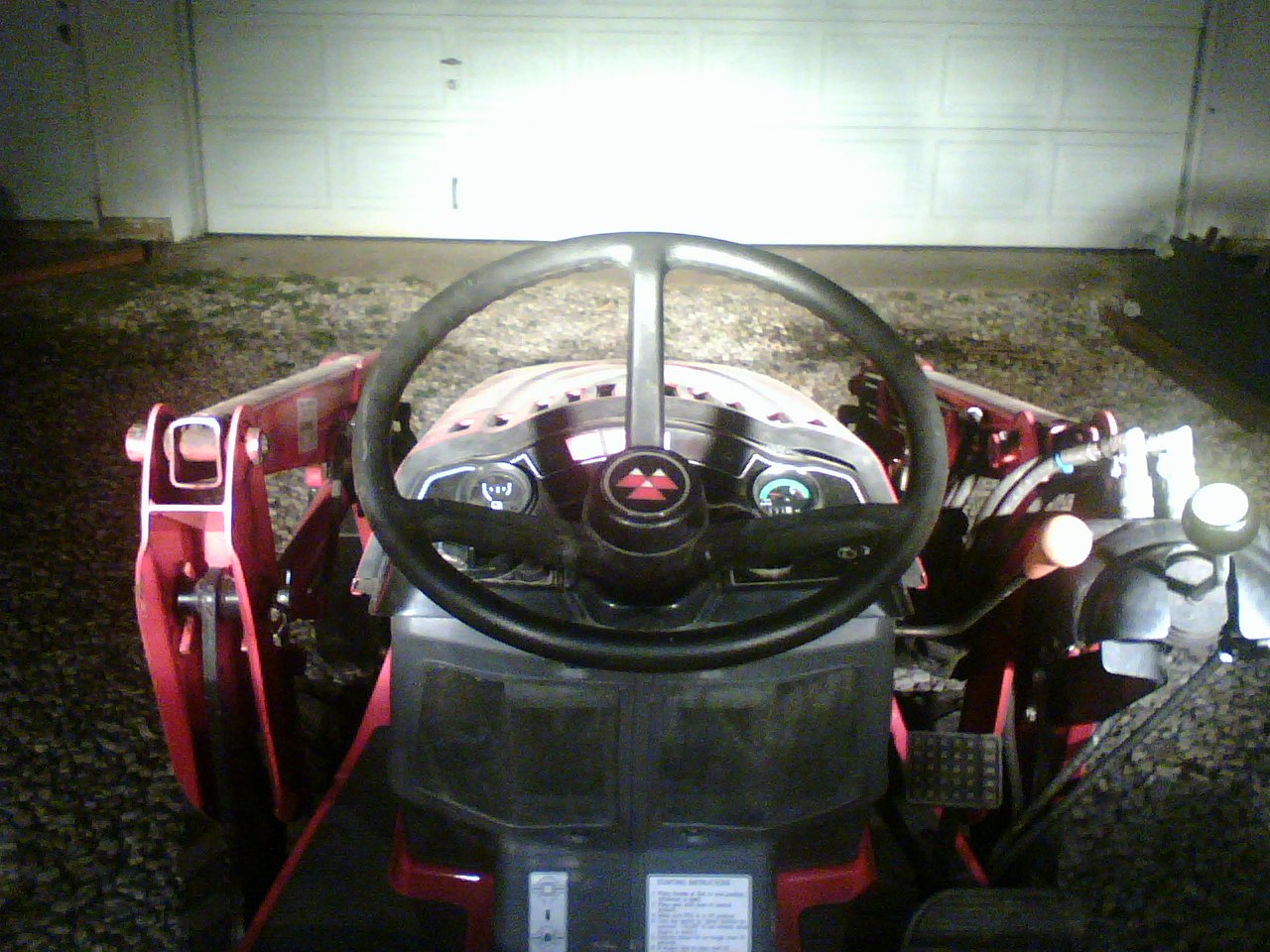

   / Adding ROPS work light to a 2310 #6
I got my switch from TSC it is just like the flasher switch. If you look farther down on Ray2310 thread you will see my setup. The lights are attached to the flasher bracket and I have added a guard around them.
Doug
