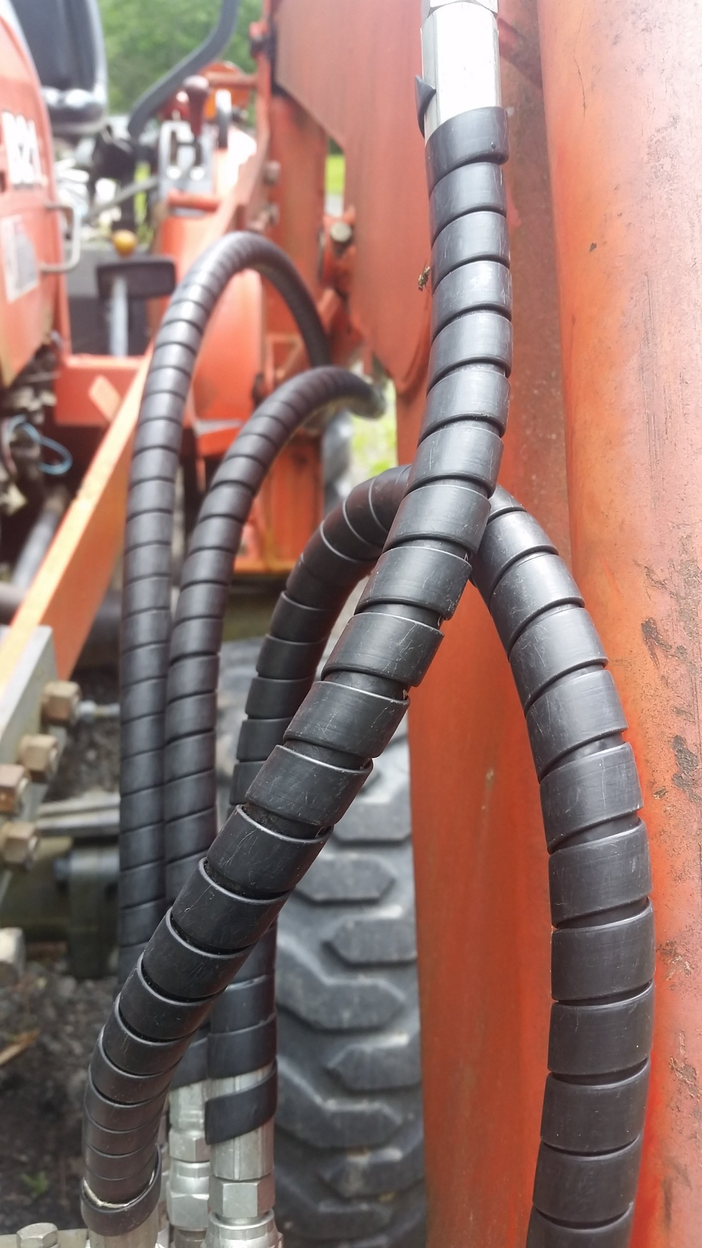

Forgot to get back to this post. Went with "safeplast" in 1/2 and 3/4 inch ID. After some trial and error did it much as Peter described. Problem I had was I could not "push" the wrap down the hose at all, I had to "spiral" it on. Did not cut the first couple, but quickly found what a PITA dealing with 25 ft of twisty turn spiral wrap could be. Once I got the "eyeball" calibrated ended up cutting which went a lot easier.
In this case, I found the spiral holds tight enough there is no need, so far, to ty-wrap or otherwise secure the ends to keep it in place. I'd guess that depends mostly on the OD of the hose and ID of the spiral.
If nothing else, feel like a better tractor owner now. Some pictures below:

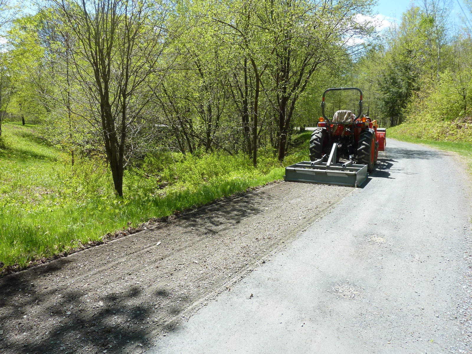

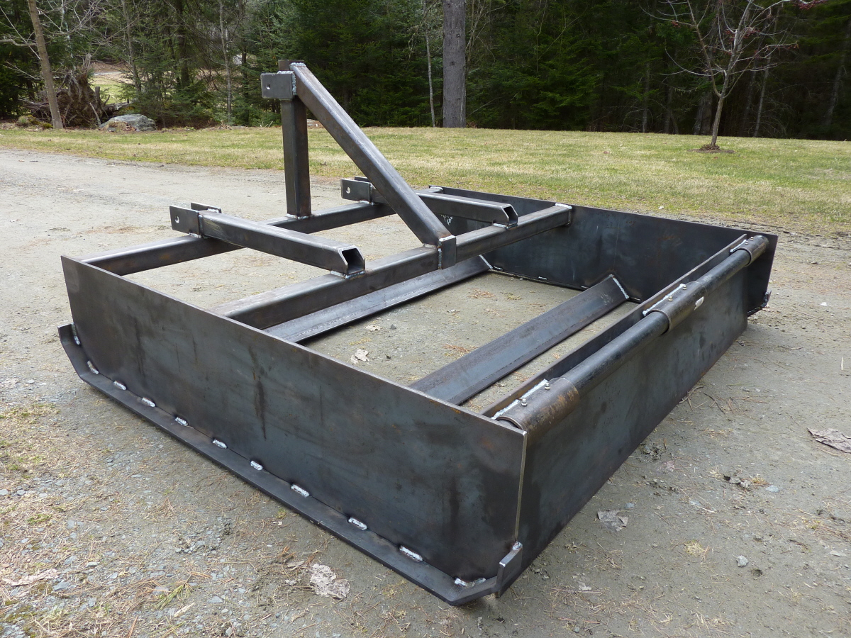

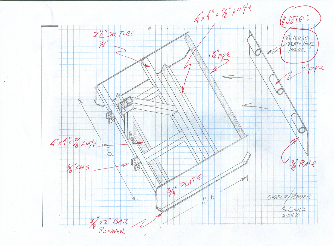

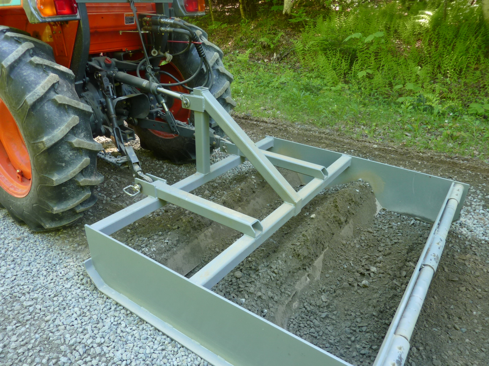

Did you build that scraper/leveler?
   / adding spiral hose guard to installed hoses. #10
Yes - It's 12 years old now and still my go-to road tool. My rear blade and box blade have their place but that grader sees the bulk of the work.
