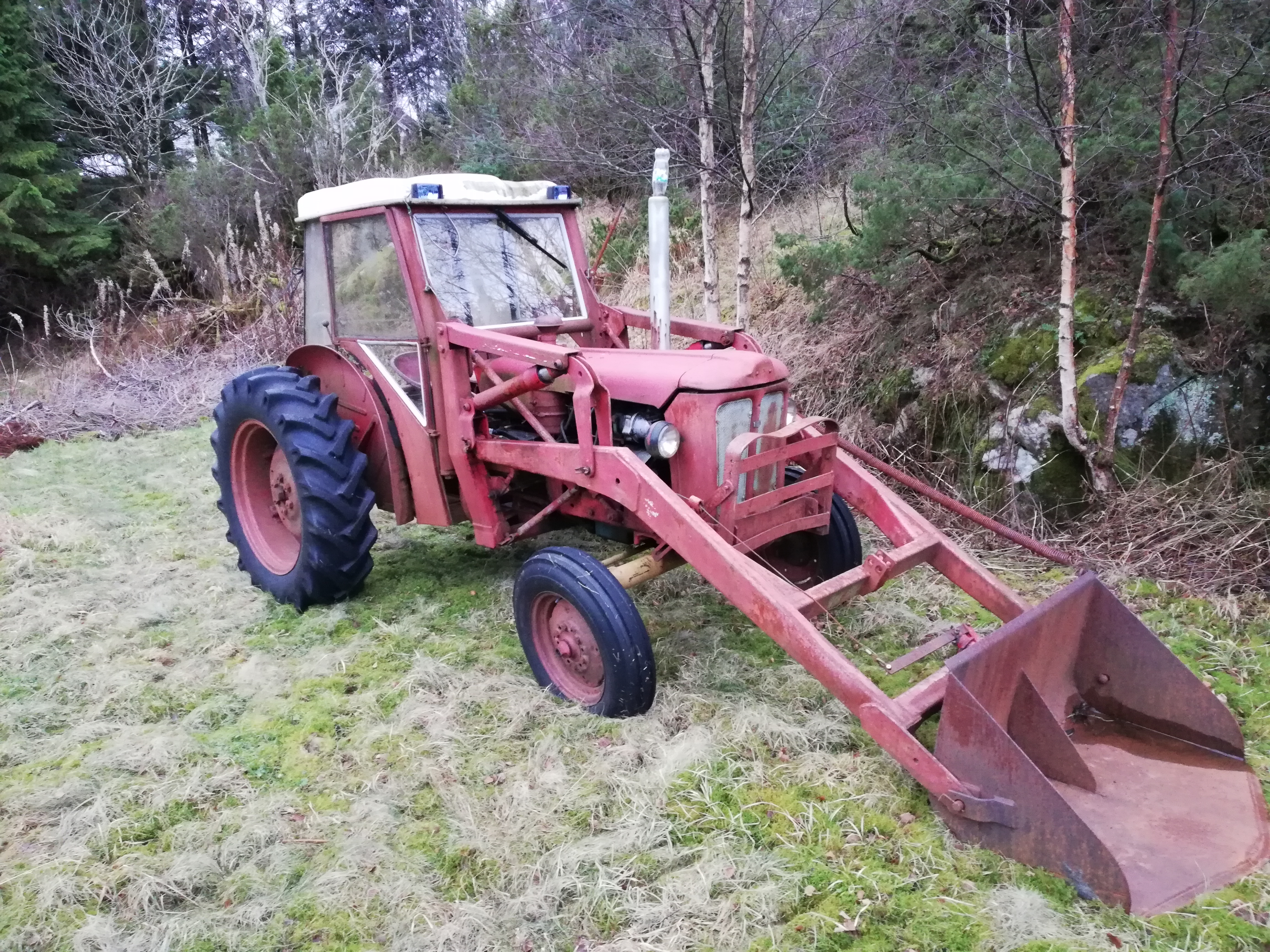

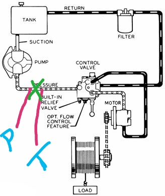

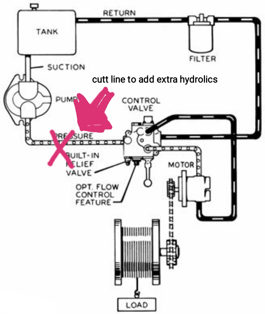

Hi i want to add a 2 hydraulic function to my tractor while still using my existing hydraulics. Can i use 2P40 Contols to tap in like in the photo (photo not supportet?!)
Cut line between pump and 3ph, and install controll valve p to pump and t to 3ph, or do i need to conect thru power beyond (high-pressure carry over) and splice a t-joint on the return line at tank. and how shuld i hook it up?
Im woried that if i just pass thou from P-T that it might blow o-rings is i use my original 3ph. But still worried that my 3ph will lose all pressure.
Its an old Volvo bm 320 (Buster)

You need to add a power beyond line from the new valve to the 3pt and tie the tank lines together. Otherwise you will damage the new control valve.

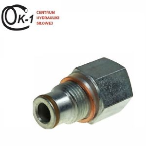

That looks like a Badestnost valve. You need the power beyond fitting for that valve.

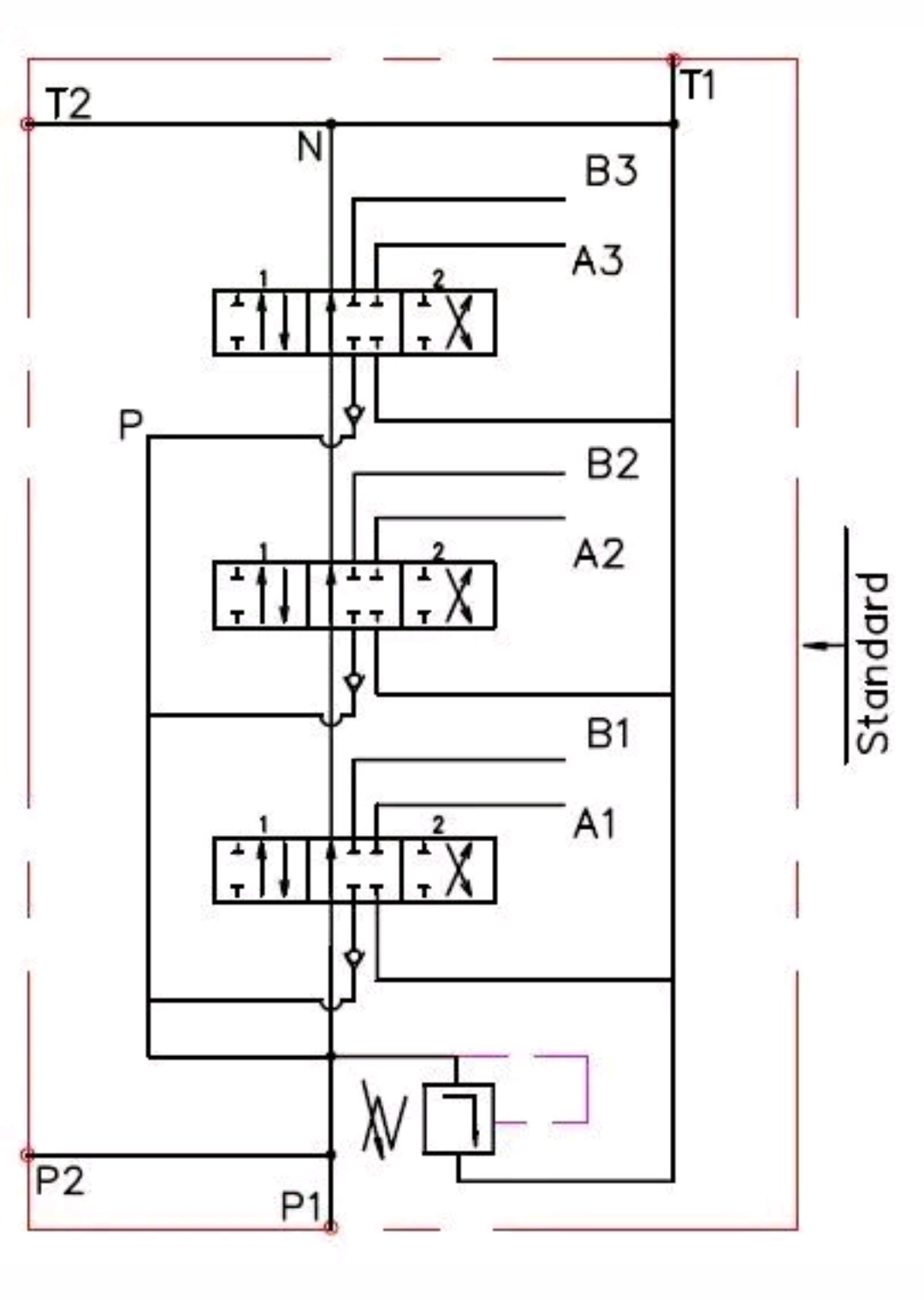

thanks for the reply, like this diagram?
can it be hydraulic valve open center or must it be closed
   / Adding/splicing new hydraulics to old existing hydraulics on a old tractor. #6
Yes exactly like that diagram. It's open center.
