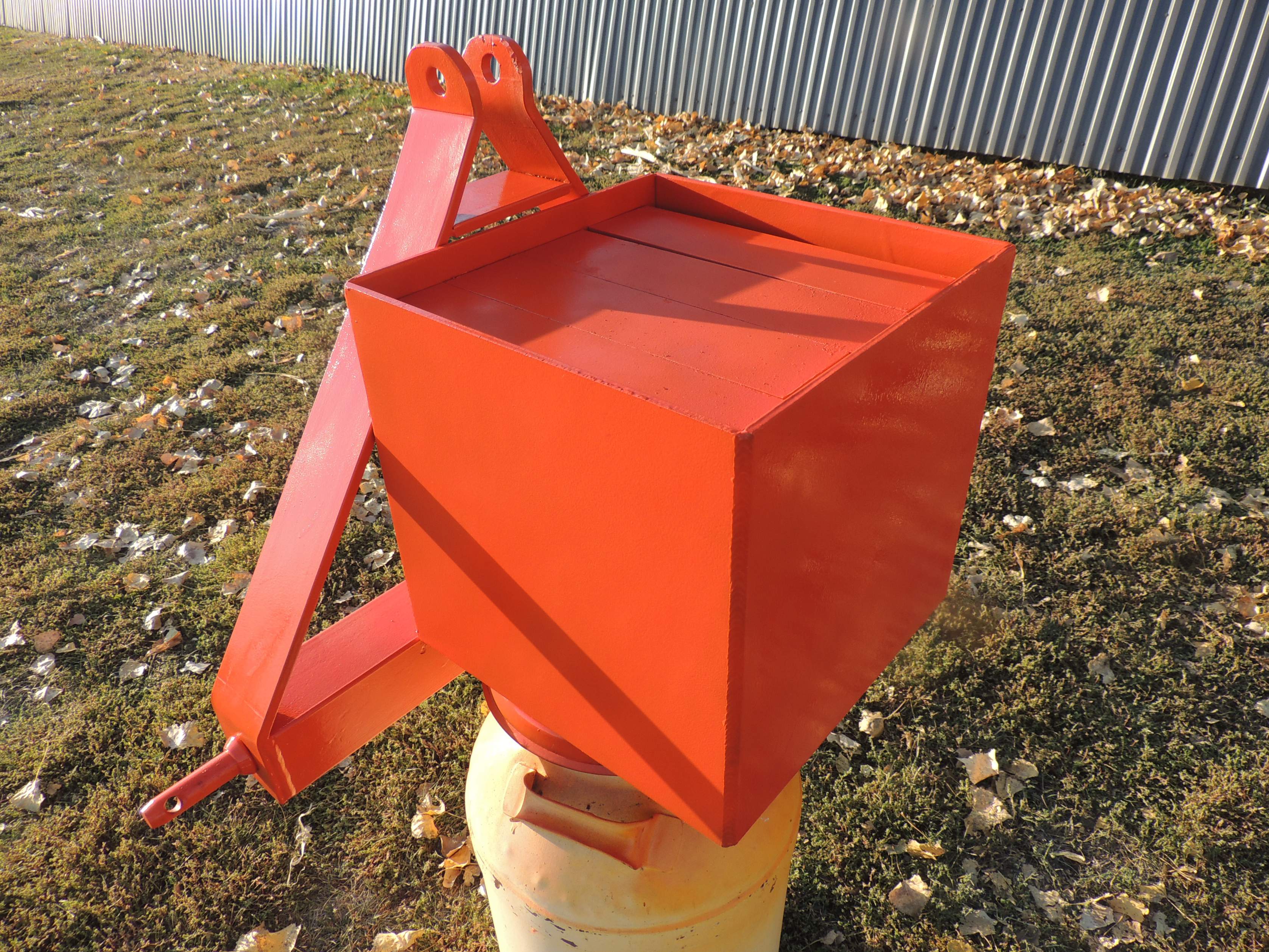

You will appreciate the extra ballast weight on the rear tires. :thumbsup:

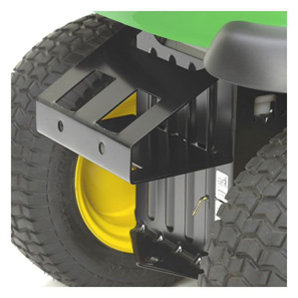

thanks guys! unibidden - I don't think I can add more suitcase weights as the rear bracket only has room for 2 weights. LA120_rear_bracket.jpg

That is a pretty heavy snow-blower and you need a bunch of weight. I use a X740 and ran with fluid, 2/50# weights on each side and it worked out quite well. This year I put a 200# weight box on and now I can go through a lot of snow. They are two totally different tractors, but the point is you have to get lots of weight on.

unfortunately there aren't many options for adding weight to the 100 series tractors. as a matter of fact,
JD advises against any more weight being added, due to the light weight nature of this line of tractors.
the transmission is pretty light duty and could be susceptible to premature failure if this tractor was to
be loaded down with weights like you can with a garden tractor that is heavier built.
