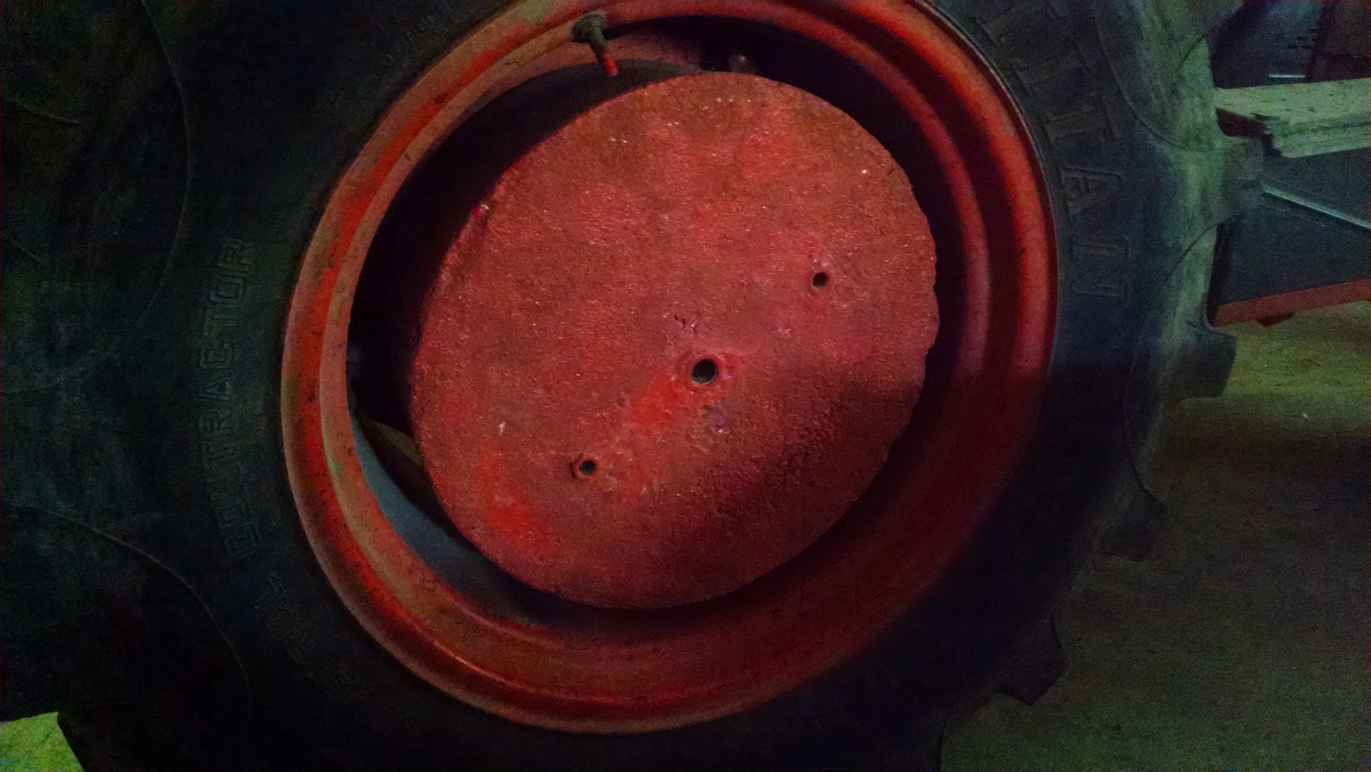

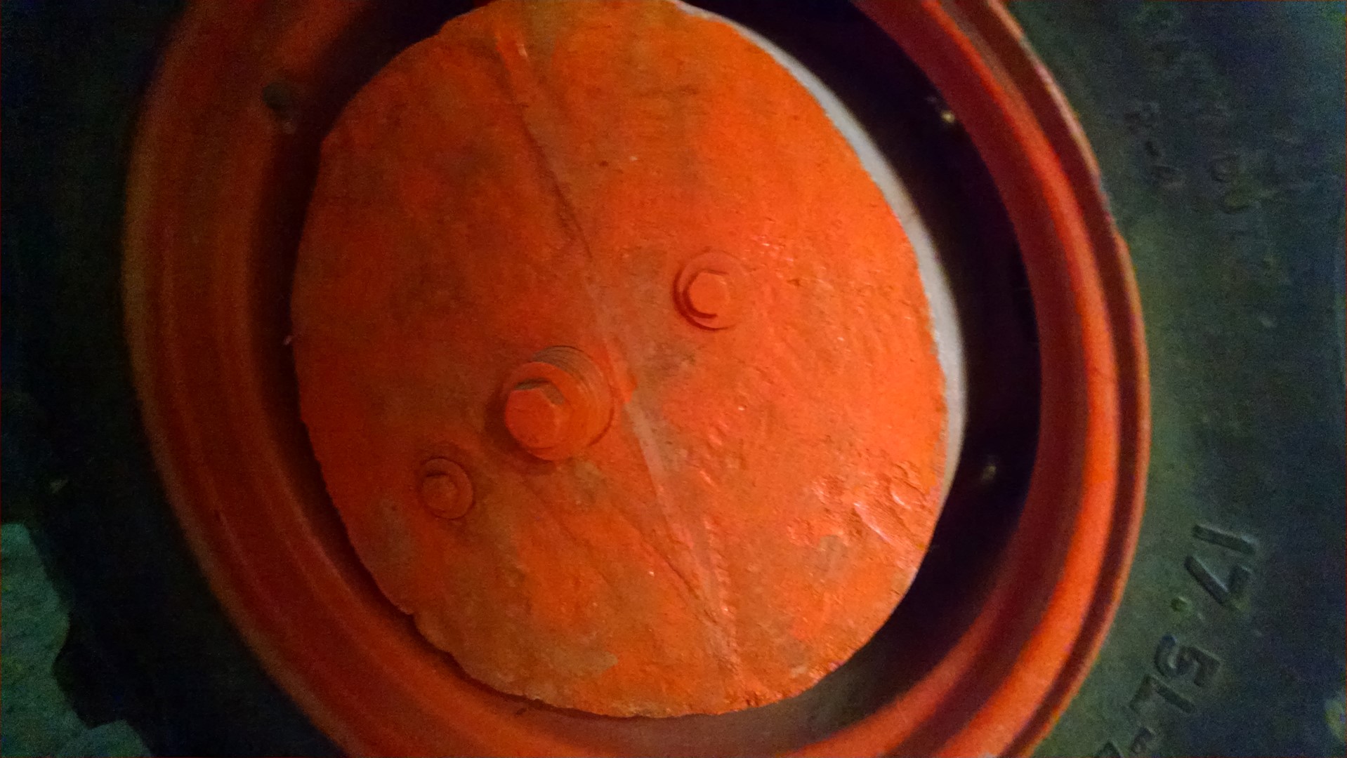

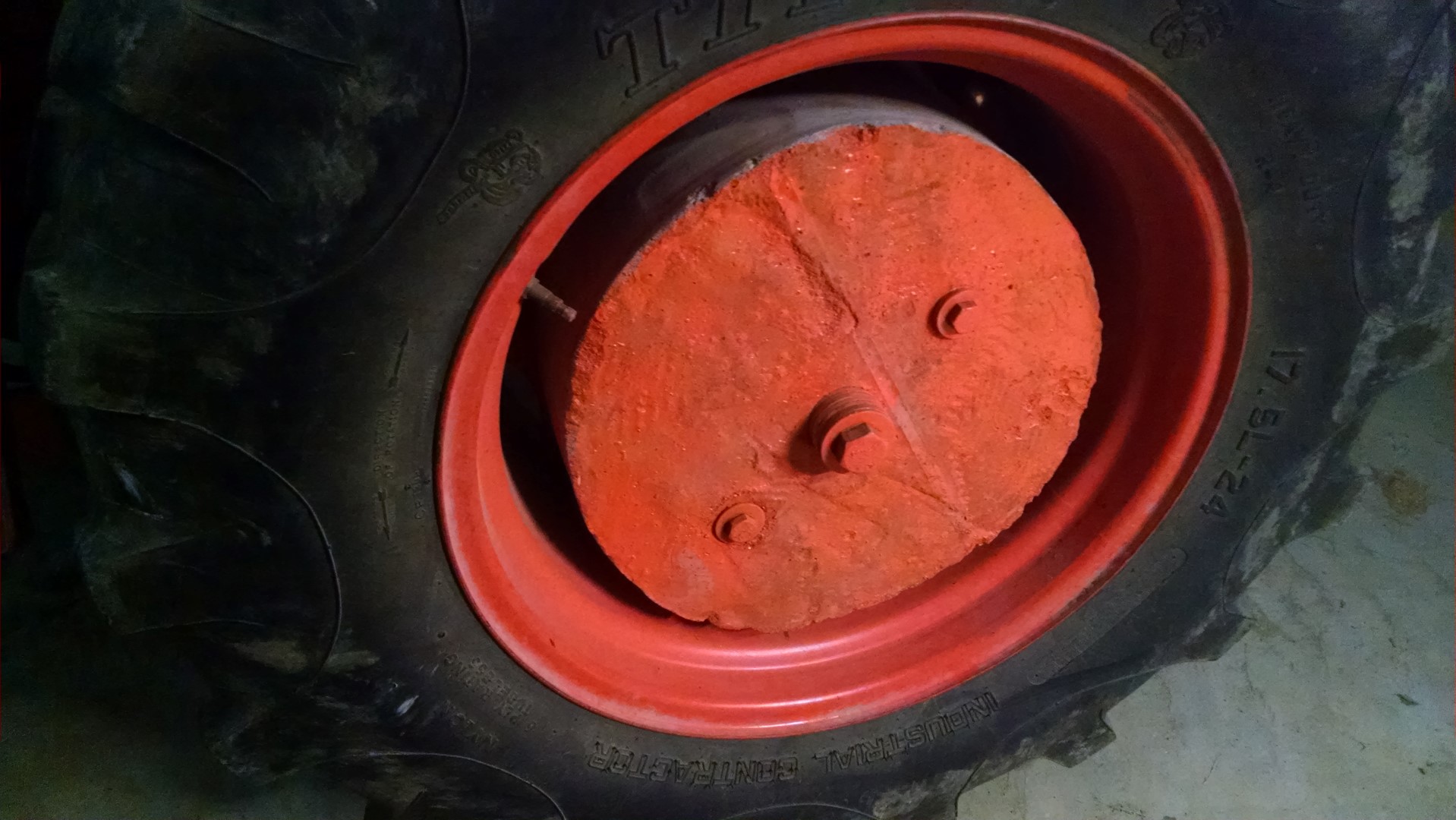

Build your own:
IMG_20150721_151840520 (Large).jpgIMG_20150721_151847930 (Large).jpgIMG_20150721_151859847 (Large).jpgIMG_20150721_151912794 (Large).jpg

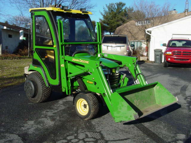

when I washer flud in my x585 brake one side of the tire an dumped it in. but have to watch you my get wet when you put air in. then finsh with the pump it a lot fasterDSC04233.JPG

when I washer flud in my x585 brake one side of the tire an dumped it in. but have to watch you my get wet when you put air in. then finsh with the pump it a lot fasterView attachment 504815
That's how I did my X740 and they were still heavy to reinstall, but worked great. But for a larger tractor tire that might work but you might run the risk of the bottom bead coming loose; did that.
I would jack up the tractor and keep the tire just resting on the ground so the weight won't distort the tire to unseat it while filling. Try to keep a little air in or pressure going into it at all times. One bigger tire I did while it was laying down and was able to seat it, and it worked. But then I couldn't lift it until I put a come-a-long to it and hook it to an a-frame ladder over the top.
