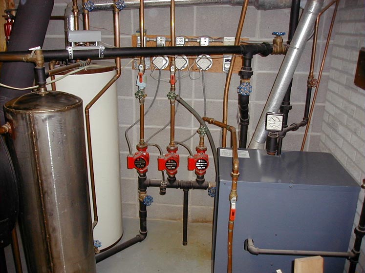

I hear you, and have the same system (gas instead of oil) except I don't have the domestic water heater in the loop (almost true, as I have a 30 gal pre-heat tank on the cold water input side of the domestic hot water tank, that the wood heats up some). This second picture shows the gas boiler on the right, the three pumps, the dom. hot water ss preheat tank, and the wood boiler on the far left.
The only problem I see with your design is getting the right controller of water temp at the oil burner. If the wood heats the water to 180, and the oil burner kicks it another 10 degree, that water may come back around to the wood burner, which checks the temp of that return water and says "its already hot, I don't need to add any wood heat", so keeps the wood damper closed. So, effectively the wood heat is out of the loop. I found that I couldn't get a water temp control for the gas fired boiler to have the right range of temp to do what you want to do.
My wood boiler has a temp sensitive draft control, which closes the damper at about 180 deg F. That is because the wood fire has residual heat that will keep heating the water from hot coals, etc. after the damper is closed. If one makes the mistake of throwing in a lot of wood in early, and there isn't a demand for a lot of hot water, then the damper shuts early, and the wood just smolders away (don't make the mistake of looking at the fire when it has been smoldering, because a big flash-back can occur, i.e. explosion of gases getting some oxygen).
I put the gas boiler under control of a separate temp senser, that is set to have the gas come on when the wood boiler output temp gets below 100 Deg F. But it doesn't take much for the gas boiler to kick the circulating water to 100, at which time the gas shuts off.
If the hot water in your system recirculated back to the wood boiler cooled down to, say, 100 deg F, then the wood would heat it up and the oil could kick it some more. But I don't think you will get that much cooling from your circulation system. You may know that better than I.
Your dom. hot water being tied into the system makes the design much more difficult, IMO.
