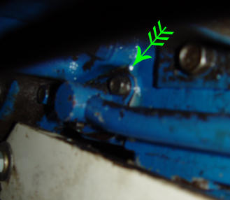

I see I will need a dedicated suction, but still think I will use the trans as my sump. I believe I can machine a spacer plate that will sit in between the existing suction line and the side of the trans and tap thru the side of the spacer to accept my new suction line. I attached a picture of the existing steel suction line and its connection to the trans. This port at the connection looks to be 1 1/2".

Fabricating a tank is way more involved than machining a fitting to incorporate into the existing port in the side of the trans. With that port at 1 1/2" dia its area is just larger than the 2-1" lines it will feed.(if my math is right)
Another question: The pump I am looking at is 11GPM and the Inlet port is 3/4". Should I still feed it with 1" to make up for fittings and bends? Or would 3/4" be fine. The 3/4" would be easier for me to incorporate into the machined fitting.

If the pump uses 3/4" inlet port, 3/4" hose should be okay. This will require a -6 or bigger pressure line and a -10 or larger return line. -10 is kind of a doggy hose, just go with -12. -12 will also make installing a return filter easy. I would probably run -8 from the pump to the valve, -6 from valve to cylinders.
