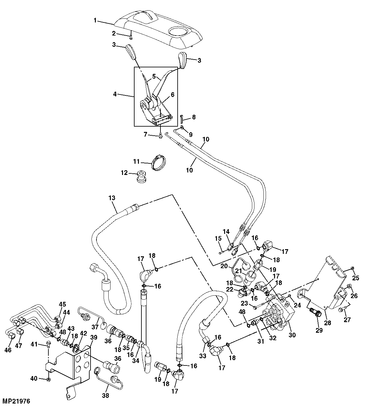

I have a 02 4600 Hydro, FEL, Cab. I am wanting to put a 3pt snowblower,(with hydro chute rotation, deflector tilt) hydro box blade, hydro rear blade, and hydro top link, on it. I currently have 1 valve set up on the back. I'm thinking that I will need 3 more additional SCV on the rear. How hard is it to add those valves, and should I get the parts from JD or else where. Mr. Goodwrench I'm not. I'm more of a Mr. Goodgod what did you do? :laughing: Any and all hints, suggestions, and what ever you do, don't do this, that you care to send. :thumbsup:

JD only offers the one remote you have-so going with all JD stuff is not gonna happen...
There are two choices here:
One) plumb in a new two or three spool valve using the "power beyond", It will be all custom-you will have to make bracket for the valve and get all the hoses made. Probably about $500-$700.
Two) You can add electric "diverters" and effectively "split" the one remote you have into as may as you like, each function would be selected by a switch. This is the easy way to go, and a little cheaper also, the downside is that only one function can be used at a time;

   / Additional SCV's #6
Storm,
I just checked jdparts and realized I was wrong, there is a 4th and 5th kit available from JD- part number BM19588.
   / Additional SCV's #7
There "was" a 4th and 5th kit. It is NLA, you would have to do piece by piece most likely far exceeding the actual value. ex, the valve alone is over $500. Better go the aftermarker route if wanting to save some dough.
   / Additional SCV's #8
