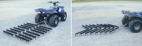

Another harrow design... This looks pretty good. Has anyone tried this? Even if not, what do you think of the design?
Country Manufacturing Harrows
They also make chain and spider harrows...

Rocky,
What exactly do you use yours for? I guess you own a farm so there are likely lots of uses for you.
   / Adjusta-Flex Tine Harrow
Pasture maintanence. Break up manure. Dethatch. Cover seed. Uncover more rocks (!) Smooth and level. Clear dropped hay. I have about 60 acres so a 10 foot wide one that can adjust down to 6 sounds nice....
Except, I don't have one, yet. I want it for behind my tractor or a gator.
Don't get too serious about that "farm" word...
   / Adjusta-Flex Tine Harrow #5
I have a 4 foot one from Loyal-Roth that I bought at Tractor Supply that I like.
I realized that I didn't need a 4 foot wide 8 foot long drag harrow so I welded some pipe and some bar stock on the ends and made it 8 foot wide and 4 foot long.
The one I have has 3 positions, upside down for manure breakup and smoothing, forward for light digging, backward for heavier digging. Like I said, I like it real well.
