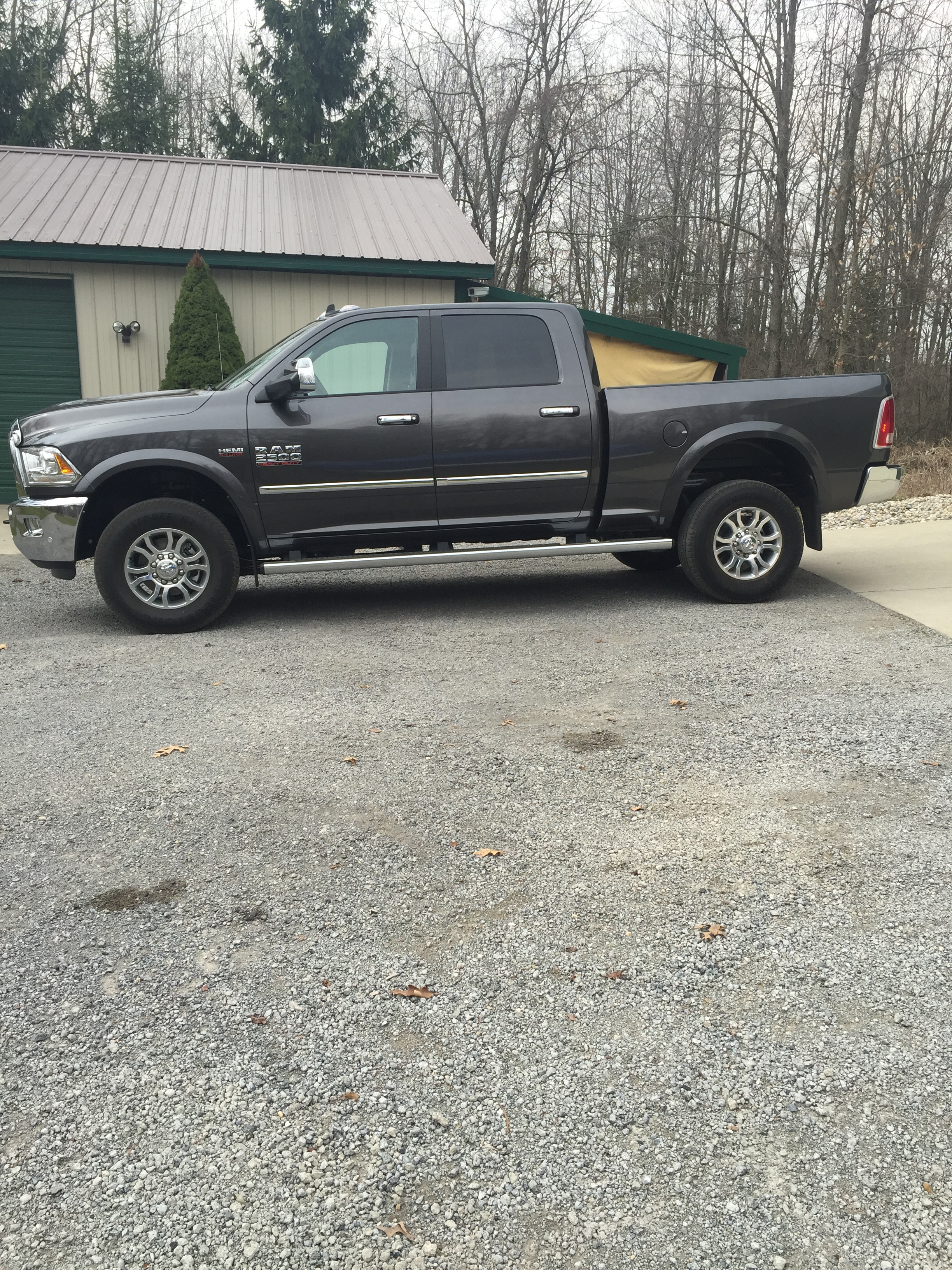

Other way around for me,my 2011 Ford F250 squatted under load of my 20 ft bumper pull trailer.My 2016 ram 2500 does not squat as much under load like my ford did.
