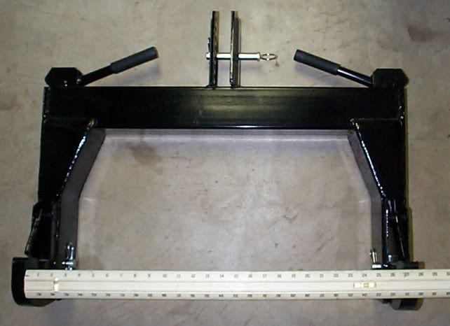

Mabye these photos will help answer some of the questions about the Harbor Freight Quick Hitches:
This first photo shows the Quick Hitch as it arrived from Harbor Freight.
This photo shows that the inside width is 26-3/4 inches.
But, as others have said on the other threads, it isn't wide enough. The attachement points on my KK 6-foot rear blade, my KK 5-foot box blade, and my PHD are all 28 to 28-1/2 inches wide. My Howse brush mower is 27-1/2 inches wide.

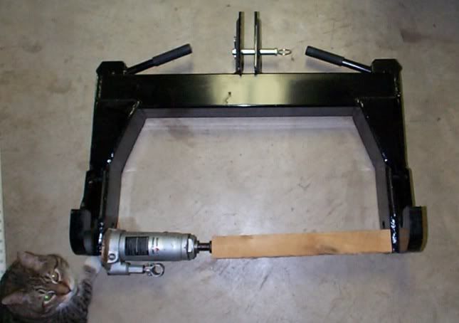

I used a bottle jack and 2x3 to spread the hitch to approximately 28-1/2 inches.

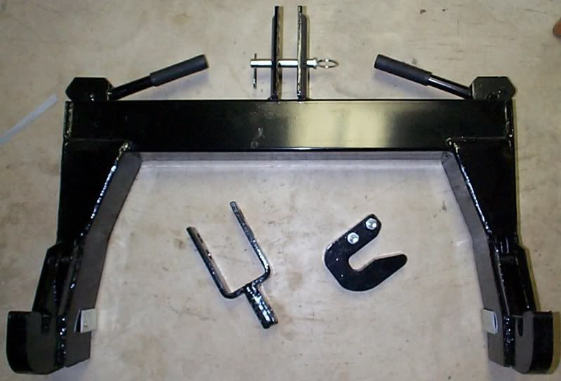

Then I found that the hook wouldn't connect to any of my implements. So, I had to order the adapter, as shown in the picture below. The adapter is shown on the left.
The hitch adapter is not in Harbor Freight's catalogs or on their website. But, you can order it by phone. The part number is 93691. It cost about $8.00. I bought several other items also, and the total shipping was about $7.
When I first tried to use the hitch after I widened it, I had to take a 20 oz. ball peen hammer to the guards for the lift pin locks. They stayed straight, when I widened out the rest of hitch. A couple of good whacks did what I needed.
Anyway, I am real pleased with the hitch. It took about 10 minutes to widen it. Widened, and with the hitch adapter, it fits my 6-foot KK rear blade, my 5-foot KK box blade, my Howse brush hog, my post hole digger, and my carry-all. (I had to add bushings to by brush hog lift pins so that they were 28-inches wide. That cost about $2.00.)

Well, I and my back are indebted you guys. The welding man stood me up, so it was back to plan B. With the use of a neighbour's jack I was able to spread the hitch by 2 1/2 inches with out any damage. The KK implements fit fine.
Again, thanks for all your input.
