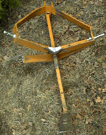

Here is an example of what the traction on R1 Ags can do if you do something dumb like try to use your subsoiler to remove a stump.... /forums/images/graemlins/tongue.gif
Notice that it bent the subsoiler BACKWARDS. That steel is about 1.5" thick and 4-5" across! (I'd have to measure it to be exact, but you can see my boot in the bottom of the pic.) These are air filled tires, not water. Anyone say traction??? /forums/images/graemlins/crazy.gif
