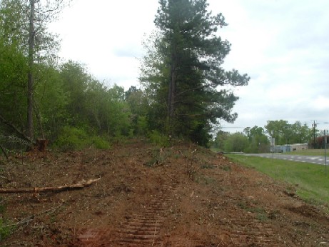

I have a contract on the land I've been trying to sell now, but to make it all work out I agreed to sell more land then I had originally planned. It took about a week for me to reckognize the advantages to this before I agreed. Now I'm excited about the changes and looking forward to moving ahead with my plans.
I brought power to the land that I've now sold, so I have to come up with another way to do this. I can come down the highway if I remove a few trees.
There's only a few more to go here. Unforuanately I'll have to use the chain saw to get them down. To big for the dozer without pushing them into the highway. The backhoe might get a few of them, but not all.

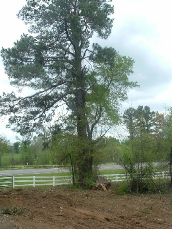

This photo shows my problem. Just past these trees will be my new property line. The power company requires ten feet of air on either side of the power lines.
The oak along the fence line isn't a problem. It will come down with those pines in the last photo.
Behind the oak is a HUGE bull pine. It's at least three feet thick through the trunk. It's hard to tell from the photo, but it's almost twice as tall as the oak. Easily over 100 feet tall.
The highway is 60 feet away. It's a State Highway, which probably means I better be extra careful.

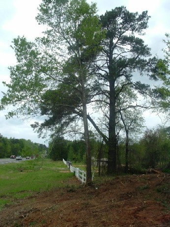

This photo gives a little better perspective of the size of this tree.
Here's my problem.
That tree is way past my comfort zone in felling it. If it falls the wrong direction, it will land IN a State Highway. That couldn't be good.
No way I'm gonna attempt it. Times like this is when I pay an expert to do what they are experts at.
My question is this.
I need to hire somebody who knows what they are doing, that's obvious. No neighbor down the street type of deals here. I know I need somebody with insurance and who is bonded.
What is bonded? How do I prove they are bonded? What do I do if something goes wrong? Same thing with insurance.
Please feel free to offer any and all advice.

I would buy my friend a case of beer, he would climb the tree and attach a good cable near the top, at a sturdy area, then have him start cutting a knotch with his chain saw. Keep pressure with the tractor and make sure, please make sure the cable is long enough to stay out of the way.....afterwards sit back and wonder if that was really the correct way to do it.
And help him drink his beer.......

Sounds like a barberchair waiting to happen.
The cable/tractor idea works out with a large snatch block added to the mix. Direct the pull away from the tractor/people.
Go with an open notch (looks like a >), plunge cut just past the hinge, then pull out and do a release cut on the holding wood opposite the notch side.
With a tree that big, I'd get a portable sawmill in there and make some framing lumber unless the schedule dictated otherwise.
