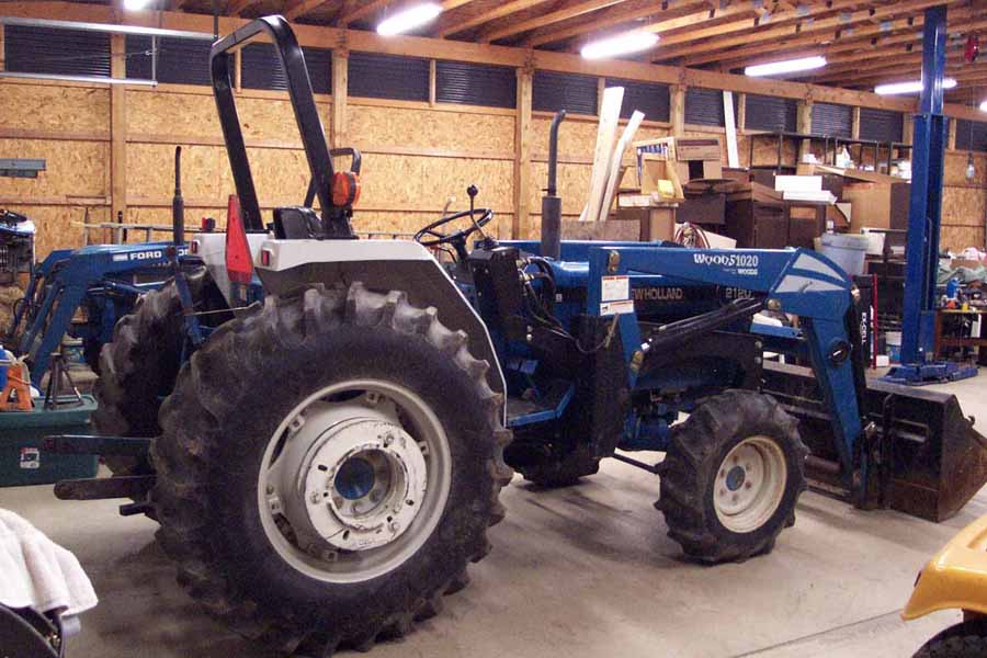

Those prices sound high. 3 years ago I bought my 2000 NH 2120 HSS with a Woods 1020 loader for $15,500. It needed front tires and some paint. I looked for a deal for a year or so. A dealer quoted me a price for a demo 2120 with NH loader at the same time for $20,500 with low financing. I agree with the comment of the 2120 being much more tractor than the 1920. The 1920 is marginally bigger than a 1720. I sold a 1990 1720 with 1260 hours, Ford loader, new paint, good tires, 12x4 transmission for $9500 in 2003. Good luck.
