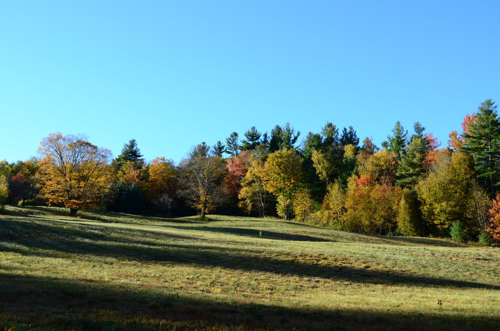

Here's a pic of part of the field to get an idea of the slope, this is after a recent brush-hog.
Doesn't look too horrible in the photo, though after any given year's brush hog there's lots of stubs of the things that were cut. Pines that never stop trying to grow, little stalks of cut saplings.
The grade is deceptive, and some of the steeper parts aren't shown. But between the grade and the stubble, you _never_ want to run through this field or you will plant your face on a stick. My wife broke her ankle just walking through it a couple of years ago, but not on stubble, instead that was wet slippery bedrock peaking through in one corner.
This year my field looks awful though. We missed the cut in fall of 2018 (bozos since fired), and the guy who cut it in 2019 had difficulty since all the saplings had an extra year to grow, so now there's all kinds of stubble and a bunch of 4 foot saplings whose cuts weren't complete, so maybe they're only an inch or less in diameter, but it's one stubbly looking field.
What usually grows there is tons of golden rod, lupine, iris, ferns, and all other manner of brush, and a high volume of birch and black cherry shoots.
I'm not sure about the horsepower of the tractor that used to do it. Last year's guy had a 45HP (not PTO) thing and a 5 foot cutter. Most of the rocks and pits are known and mostly avoidable except unless I just can't see them in the tall weeds and forget where they are.
Reading other things they recommend 5+ PTO HP per foot of cutter, so I figured if I manage 30+ HP I'd manage with a 6 foot cutter, but maybe I need to do 5. I'm not sure how this relates to your comments which talk about more power for dry and wet grass, but while there are plenty of grasses, "grass" isn't the first word that comes to mind describing my field.

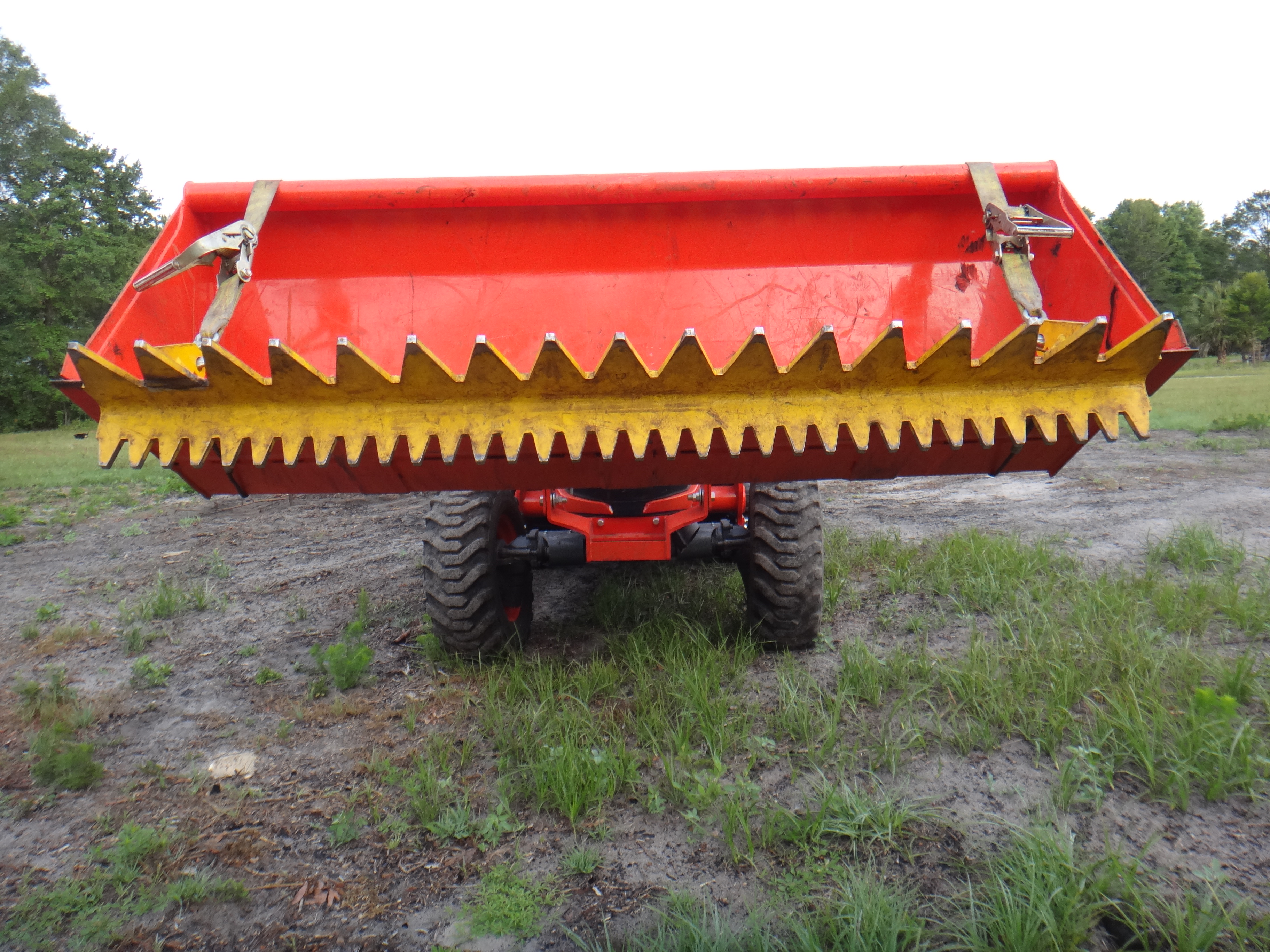

Almost an aside: Consider a Ratchet Rake bucket attachment for infrequent driveway grading.

Anyway, I'm figuring a blade because grading is everything on this driveway, the water flow has to be managed.

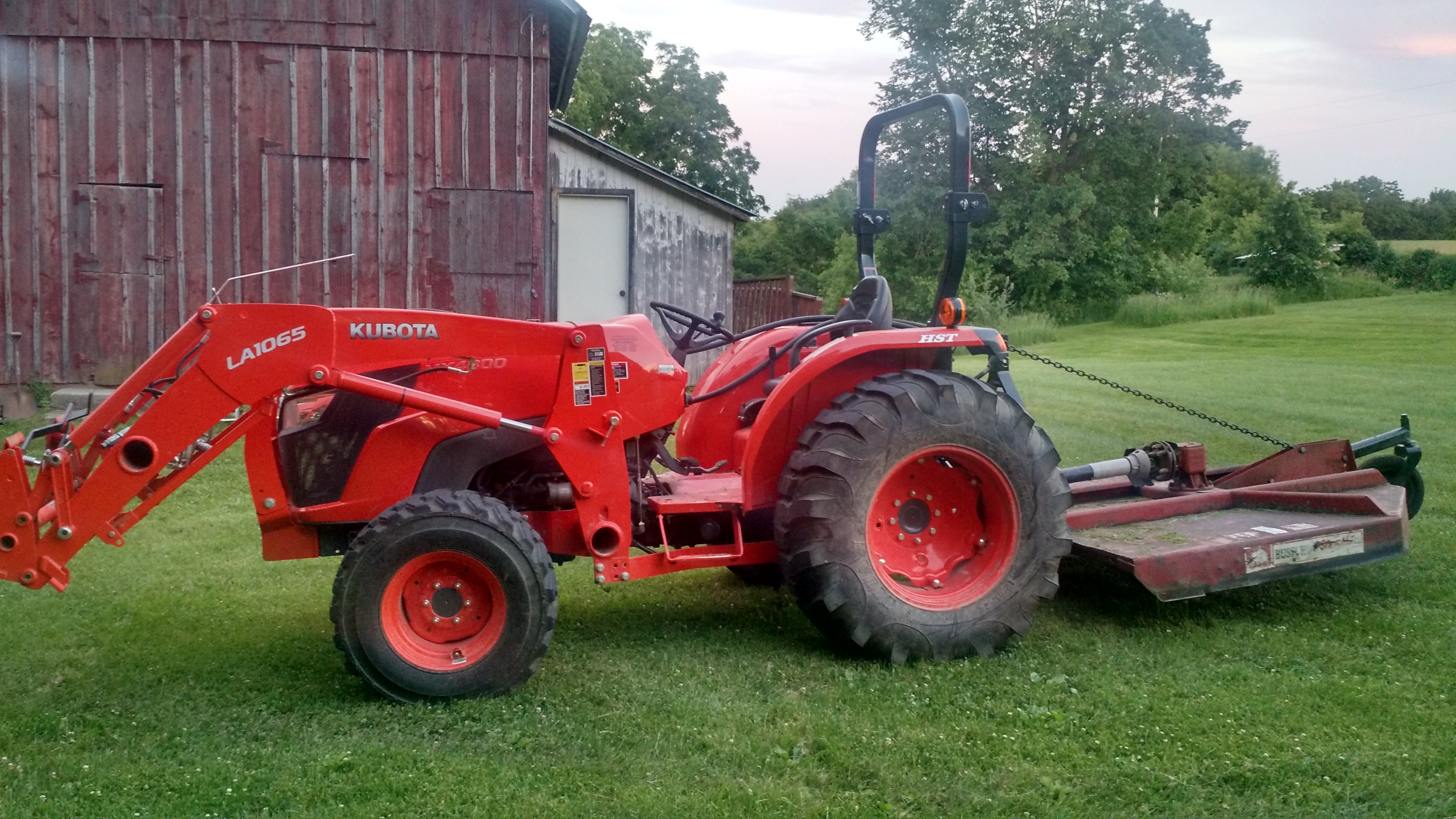

I have a 45 hp tractor with a 6 foot cutter. Most of the time it's enough power. When the growth is too much, either overlap the cut or slow the forward speed. 30 hp on a 6 foot cutter is marginal in my book, but the major issue is: will the tractor lift it ? A loader does a fair job of front counter weight.
Second, with a loader, do everything for stability. First IMHO is rear tire width. Even with loaded tires a mere 8 inches (4 inches per side) of increased track made a world of difference to the seat of my pants.

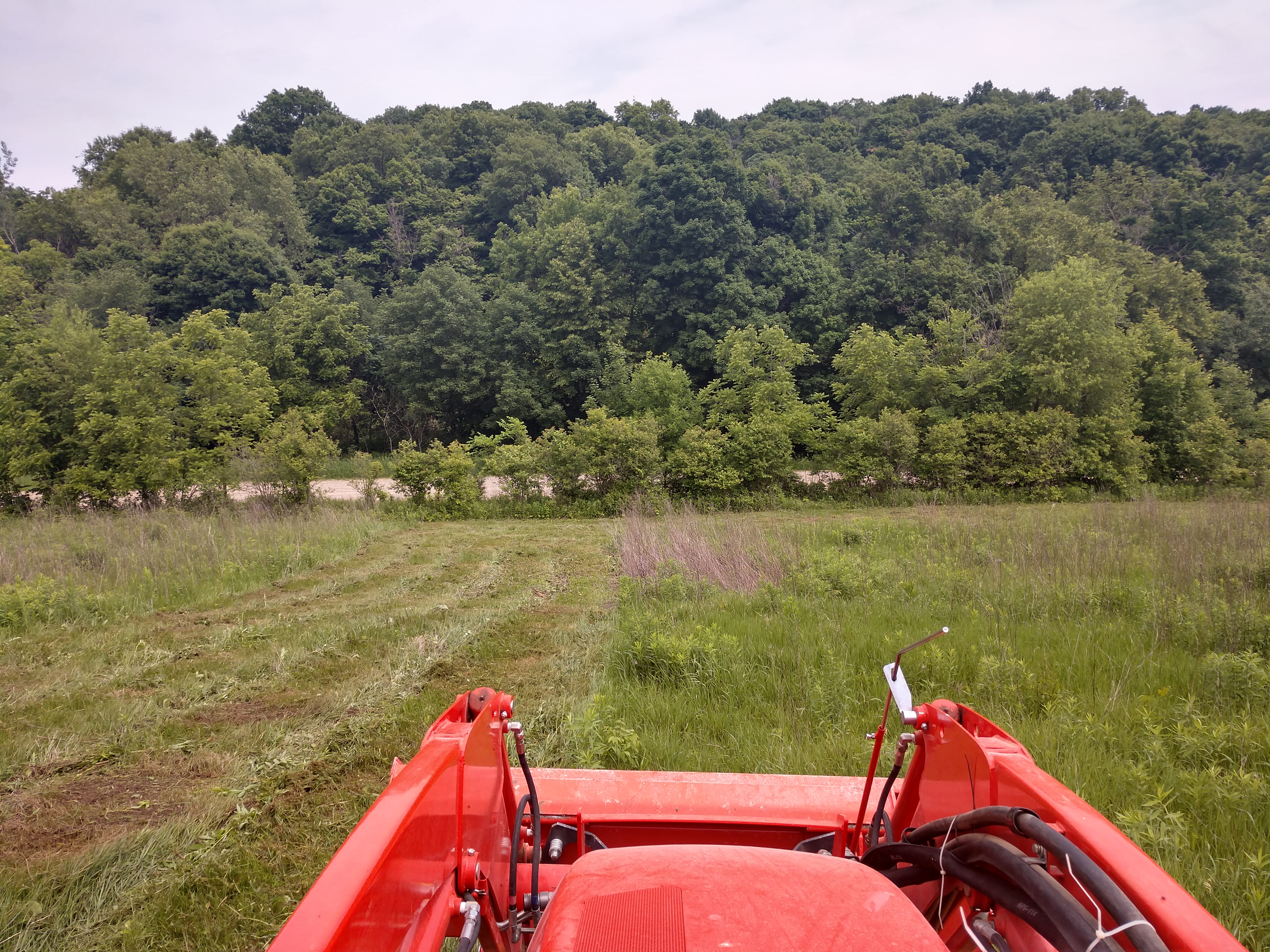

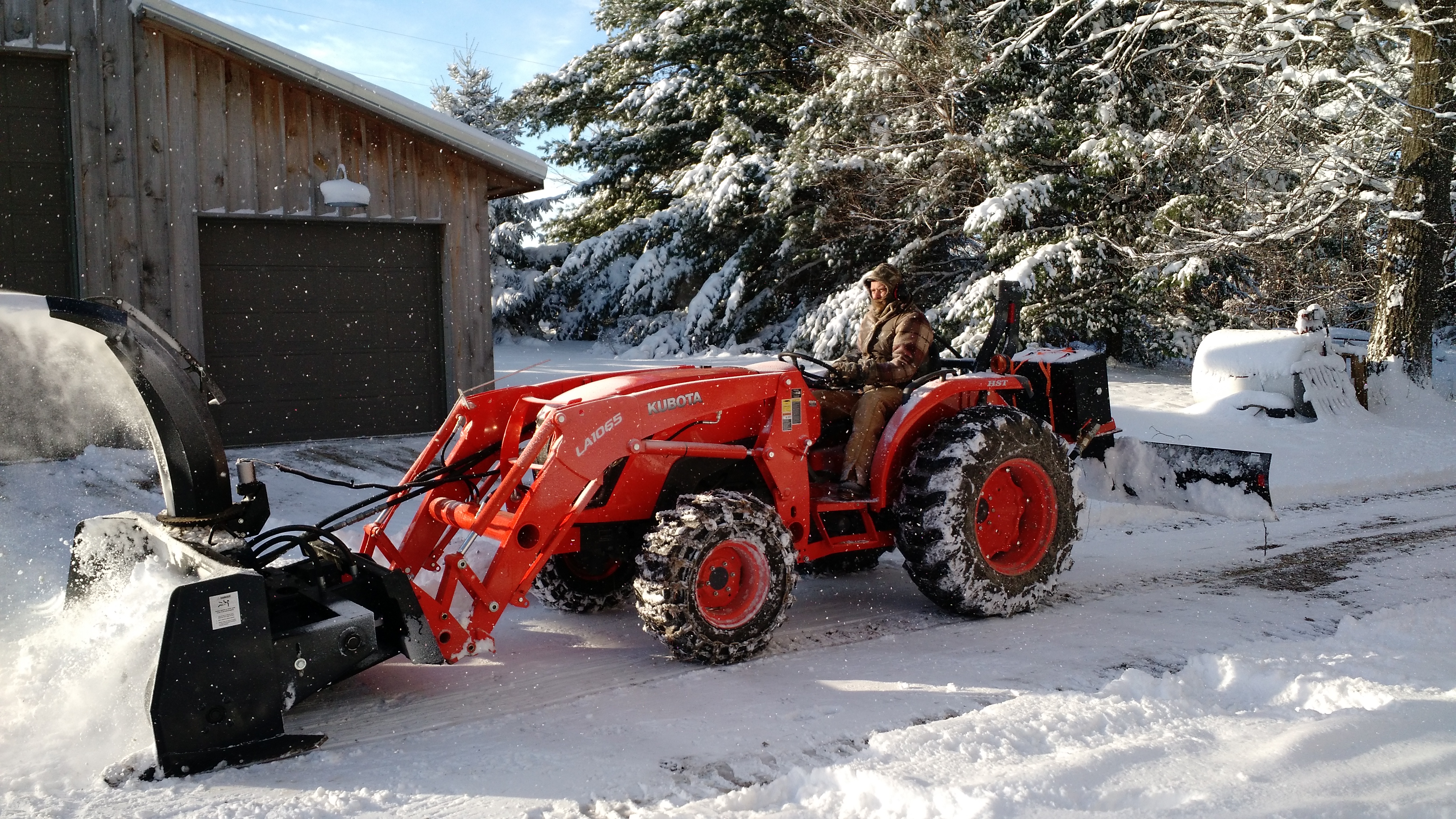

I have a MX4800. I use a 6' Bush hog 2x a year on a 3 acre pasture. I use the grapple in the timber to get logs. A 6' Land pride 3 point finish mower. I use a 8' rear blade and a 6' skid steer blower on the front. And of course the FEL with a 72" bucket for everything else. I have R-4s. They are tough and a good compromise. We have hills, snow and ice.. so I have chains too... My R-4 have fluid in them as well.
