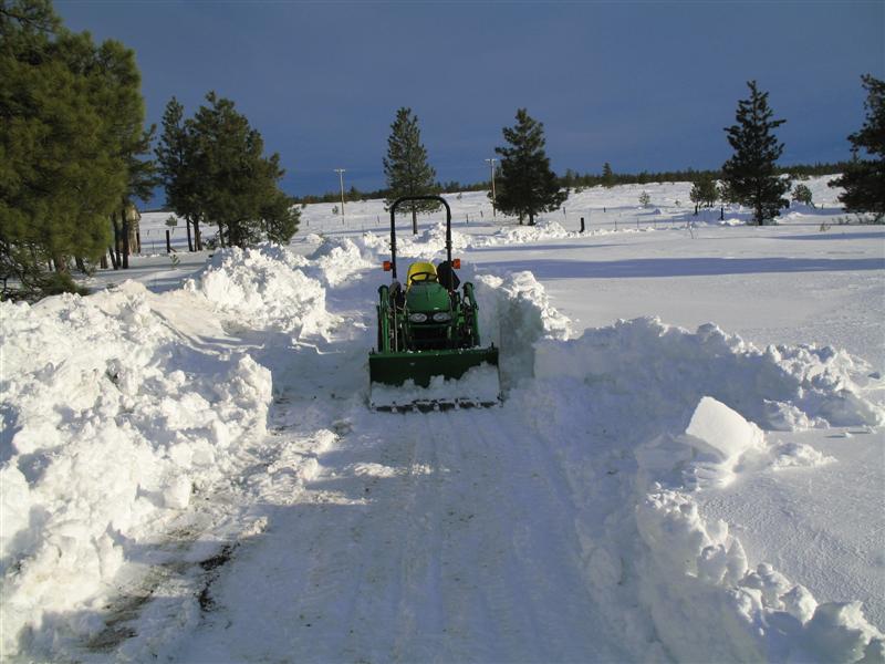

Boy I sure don't want to start round 9,785 of the tire wars but R4s work ok for me. Don't get me wrong chains are much better. For your application I would suggest turfs with chains. My R4s do tear up my lawn a bit in spring when it is soft. That is not too much of a problem since we do have a small lawn tractor.
As far as a FEL vs blower is concerned. If it is one or the other get a FEL. If you can afford both a FEL and a rear blower/front blade setup, wow, that would be ideal. FELS do work for snow. If you get a lot of snow in one go then the FEL can lift up the snow and stack it. After the storm in the picture it took about 8 hours (with breaks of course) to do my 800 ft driveway, my neighbors 400 foot driveway, and the retired couples 600 foot driveway down the road. Do I wish I had a blower; you bet, but the FEL rear blade setup does work and can be used all year long.
If you do settle on the FEL rear blade setup try using the rear blade reversed (pushing with the concave side) you hardly move any gravel. Good Luck.

A blower would be faster but the FEL will handle 4 foot drifts. In the picture above the snow was over 3 feet deep and wet enough that I could just scoop along the ground and pick up a large "stack" of snow. We don't get storms like this very often where I live in Eastern Washington so I did not go the blower route. Even with a blower it would be slow going if you waited until the snow had accumulated the entire four feet.
What I do now is wait until we get about a foot or so of snow then put the FEL about 1 inch or so above the ground. Then I push the snow and can clear the driveway for maybe 30 or 40 feet. The snow is either pushed off to the side or stacks up in front. Then I do a sharp 90 degree turn and dump the accumulated snow. Repeat as needed. I don't know if that would work for you or if you get so much snow that you would be outside all the time.

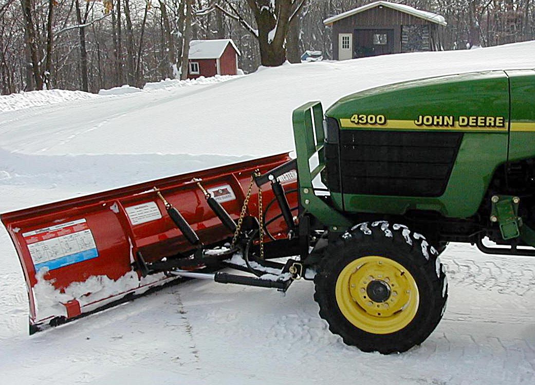

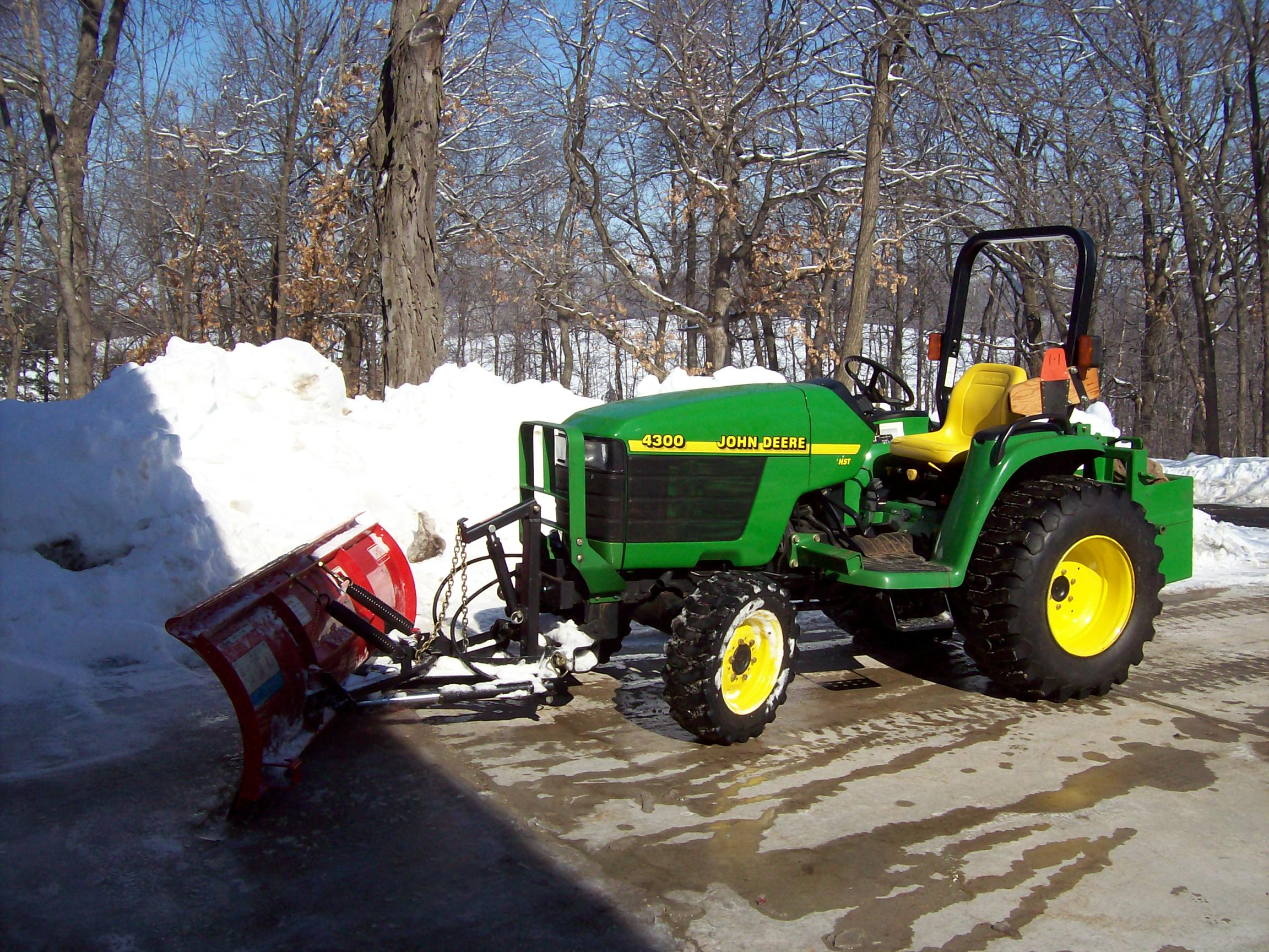

Here is my 4300 with plow (7' Western) and it handled the 12" snow this past week with relative ease. There was a stretch of drive that runs E-W that was just at 4' deep on the south side, and 12" deep on the north side.
