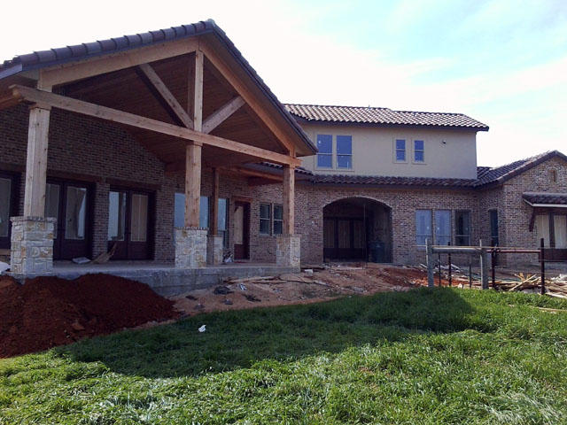

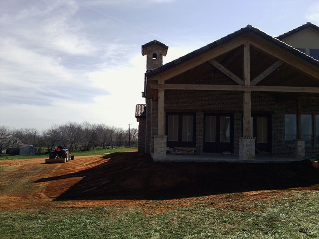

This is a little more extreme than your situation, but here are two methods I use to accomplish the same thing.
The first photos are a buildup of soil to create a flat top (for a sidewalk from the door to the driveway) and sloped sides. The soil was placed in 6" lifts with the fel and compacted by rolling with the tractor. The sluff soil next to the home was cut and compacted into the mix during each lift. Then I used the boxblade to cut and shape into this profile.
In these photos the soil next to and behind the patio was laid in with the fel and then backdragged to shape, rolled in and then touched up again with the fel and more soil.
A combination of the two methods should get your fence line area straightened up.
