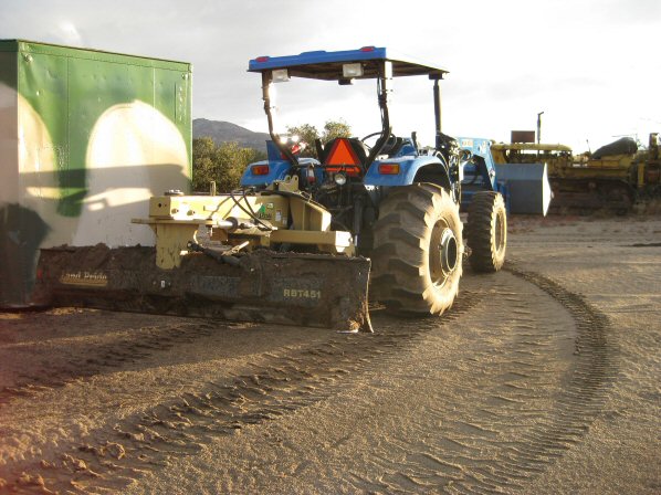

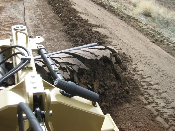

If you have the draft setting set light, it does not take much for the blade to raise. It only raises a fraction of an inch and you go on your way. Actually never even know that anything has happened. Normally you are not taking a heavy cut and even if you were, it's not like you are making a single cut and calling it the finished grade. I have made roads from scratch, moved roads over 10'-15', finish graded. This has worked for me VERY WELL. Not saying anything bad about a gauge wheel setup, just that it is not needed if a person has the right equipment and know how to use it. Without draft control, not sure how well that would work. :confused3:
Typically for the finial finish grade, I go in reverse so that the tractor is moving over the finished surface and gives an extremely nice finish. This is done without draft control. Actually I only use draft control when I'm making a cut of more than 1 inch. ;)

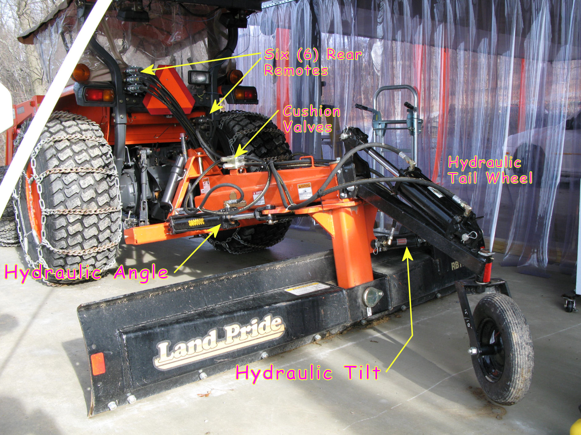

I have the hyd gauge wheel and no, doesn't go completely vertical and does extend rearward. It does go sufficiently high that the blade will rotate under it, should you wish to reverse blade. I am having trouble envisioning a geometry that would do what you want without repositioning the attachment point, etc. but I'll go look at mine (I've posted pics before)

If you get a chance, could you measure the length of the gauge wheel main support bar for me? i'm wondering how long it is. I remember seeing a picture you posted somewhere before as well, I'll try to search your old posts and find it. I'll post a few pictures of my "new" blade as well.
Brian,
I like the idea of the dual gauge wheel on the RBT4596 that you posted about. I think I'll try to copy that one. I can't believe they get $1700 for the gauge wheel setup on that blade! I wonder what the blade itself costs new.
What I was thinking about as far as getting the "geometry" right for allowing the gauge wheel to be raised up to almost vertical, would be to use a longer cylinder, and instead of mounting it to the very end of the rear blade frame, mount the end of the cylinder on the actual boom of the blade frame, closer towards the tractor. I'll try to draw a picture to represent it a bit better.

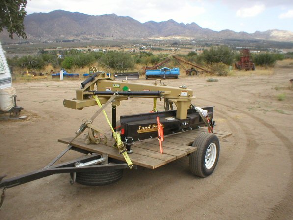

My RBT45108 with skid shoes and no hydraulics was $3600 six years ago. 2 years later I find out that I could have bought it with no adjustment bars at all and saved about $600. :( Here is a pic of it brand new, ready to get unloaded off of the trailer. :thumbsup: The improvement over my first rear blade in indescribable. :cool2:
For your gauge wheel setup. Use a 3" x 10"-12" stroke and like you said, mount the cylinder up on the boom maybe half way and you will easily be able to get vertical or even towards the tractor movement. Not that hard to do, just put the thinking cap on. ;) Thinking about it a bit more and you should be able to get the tail all the way up and over the boom. :cool:

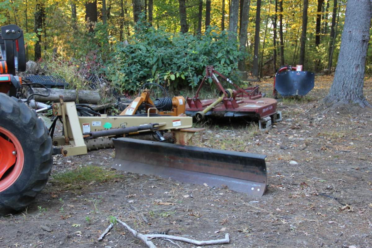

Brian, that is one heck of a blade, I'm actually surprised it wasn't more than what you paid. I bet the price has gone up since then though.
Here are are a few pics of my new blade.
