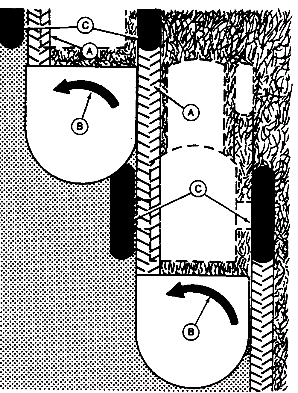

I am close to purchasing a 5065e, 4WD with 77 inch outside rear tire width. I want to buy a Bush Hog 296, 6 foot cutter. Is it dumb to have a cutter that won't cover your tire track? I will be 2.5 inches short on each side. I will be cutting logging roads and some food plots and fire break. Some tight spots needing 3 point turn arounds. I can't see that it will matter. I will have to run the tires down the edges and won't cut to the tire track edge but not an issue. Any experience that would suggest a 7 foot cutter (84 inches>77)?

Agreed. In fact a single spindle cutter is designed to go between the wheel tracks for an optimum cut. I'm not sure where the whole notion of having a cutter wider than your tractor came from, but as per the design of the cutter that is incorrect. The reason for this is so the cutter is cutting undisturbed grass. With this setup if you go around the field the proper way the inside tire will still mash down the grass for the next pass, but the rotation of the blades will pick it back up, the outside tire is always in cut grass.
I use a 5' bush hog on my 5203. The cutter works better on that tractor than my Ford NAA or B3200. The distance between my front tires is right at 5', so it's real easy to judge where you are cutting and get a full swath each time with very little overlap. If I need to cut up close to something I just swing it over to one side using the sway links.
So I say go with the 6', a single spindle 7' is a really large, heavy and long cutter. They also take a disproportionate amount of power due to the really long blades.
This is an illustration provided in the manuals for JD single spindle cutters describing cutting technique and wheel spacing:
If this is true why do all commercial mowers, zero turns, lawn tractors, etc. Have mowers that extend beyond the wheels? Also, why would you ever use a batwing if this is the case?

Multiple spindle spindle cutters rotate the blades in a manner that will take out both tire tracks. We have a Woods BW180 15' batwing and it provides an excellent cut, as does our Deere 1008 twin spindle 10'. Finishing mowers (and the others you listed) are a whole different ballgame due to the shorter grass height.
Things have changed over the years, I was just informing folks of how these cutters were originally designed to operate. Many of the new high tip-speed single spindle cutters will do a satisfactory job covering both tires, but not as good as they could if operated like they were originally intended. I'll also add, most folks don't care about cut quality when it comes to bush hogging, if it knocks it down that's all that matters to them.
