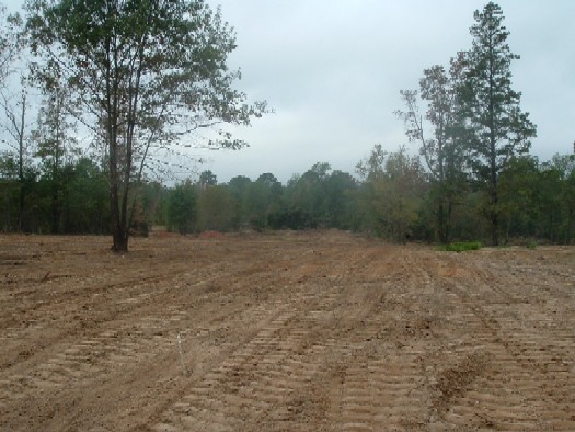

I'm still kicking around some options on a small pasture that I'm creating. The land is cleared and graded. When spring arrives, I'll plant bermuda grass, which does well in my area and is one of the better grasses for grazing.
The pasture will hold a few Longhorns. They will be for ornametal purposes.
My plan is to run five strands of barb wire. Goucho 4 barbe was recomended as a good choice. I was told it doesn't rust as quickly as red brand. Other than that, I have no idea of what to look for in barb wire.
I have three choices for the corners. Metal pipe, PT posts or Cedar posts.
I've gone back and forth on using pipe. I like the idea of being able to paint it green to match the t-posts and the finished look is real nice. Price is close enought to PT that it's not a major concern. Welding them up would be a fun project on rainy days in my barn.
Negatives on pipe for me comes down to fastening the wire to it. I haven't seen anything that I like as much as just nailing the wire to a post.
PT posts are my current favorite choice due to the ease of attaching the wire and the big beefy look I like on corner posts. I can also paint them to look nice, or leave them natural for a nice rustic look.
I've just started thinking about using Cedar trees from my land as posts. I have plenty, the price is right, and they will give me a really rustic look that I think I'll really like.
Negatives of Cedar comes down to how long will it last compared to PT?
I have one strait run of about 650 feet that will be the viewing area of people at my place. If Cedar will last as fence posts, I'd even consider using it instead of t-posts on that run and maybe even creating a three rail fence from it to really create a rustic look.
Then I could do the other runs in a more traditional method.
Thanks,
Eddie
