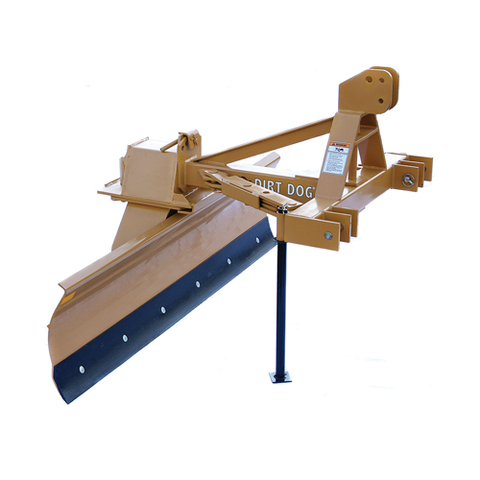

Looking to upgrade to a Heavy Duty blade for my 60 hp NH Workmaster. Tractor is 4wd with a front loader and rear ballasted weighing around 8500-9000 lbs.
What I want, mechanical offset, tilt, & swivel. So I've looked at the Dirt Dog 70 series blades in a 8' wide blade. From my understanding Dirt dog makes this same blade for Bush Hog & Rhino in there 70 series. Does anyone have experience with these? And if so will it handle my tractor on a hang up without folding the blade? I've looked at hydraulic blades a little beefier but I really don't need to spend $2500+ right now.

Can't see all of the blade but it looks like at least one hydraulic cylinder could be added as needed at a later date, without having to make mounts. Are all the adjustments made with a cylinder substitute, like the swing?
You're looking for trouble to run that blade behind an 8-9000lb tractor IMO. :eek: Two things, it's not heavy enough to actually do much work other than snow and soft materials and if you were to get it caught on something, it would just fold up with that much weight pulling it. Ask Oosik about the differences.
Minimum rear blade IMO for your tractor would be in this category. Bush hog.

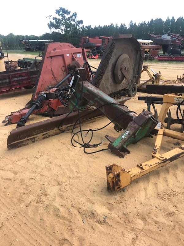

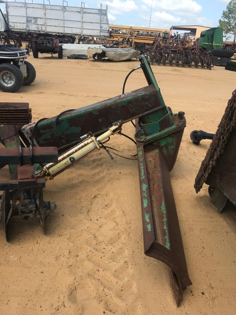

Found this John Deere 155 at a auction yard. They are asking $1500 for it. Needs some TLC but they said it's solid and everything works like it should. He offered to hook it up for me to inspect it which I would. Don't mind the surface rust, I can repaint it & I know those old 155 blades were stout. Does the price sound fair?

Take a very close look at that blade. If I'm not mistaken, it only offsets to one side without having to change the cylinder to the other side. And I think that it only tilts in one direction. The blade angle is manual, to me that would be the most important function to have hydraulic. ;)
