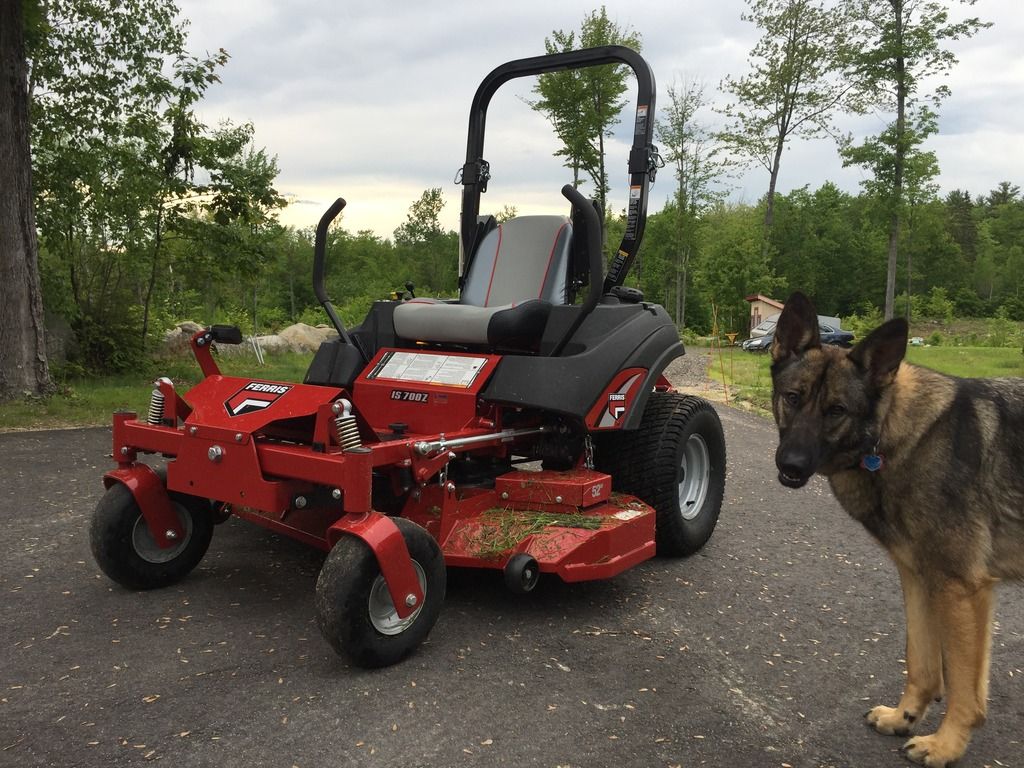

I just picked up an IS 700Z a few days ago, only have 1.5 hour of mowing time on it but so far Im impressed! A huge improvement over my 22 horse Husqvarna lawn tractor. The suspension and weight of the machine really sucks up the bumps a lot better, and being able to keep the deck up so high is great for my property too...a lot of sections have rocks under the ground that I had to go around with the Husqvarna that I can go right over now without hitting.
Cant help you much with what to look for as I only just got mine. Its a pretty awesome machine though!
