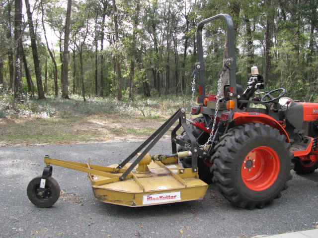

ENTRY LEVEL does not tell us much. The questions we need answered are: Will you be cutting exclusively grass? Will you be cutting some saplings? What diameter saplings? What quantity of saplings? Will you be operating over sloped ground?
Tractor Supply Company's 'Countyline' implements are made by Tarter. You may be able to get a Tarter Rotary Cutter cheaper under the Countyline brand. In my opinion, King Kutter Rotary Cutters are two grades better than Tarter/Countyline Rotary Cutters. I would consider Tarter light-duty, King Kutter medium-duty.
The 48" King Kutter I bought used, then operated three years before selling when I bought a heavier tractor, was a stout implement.

Thanks for your reply. I will be cutting mostly grass, not sloped, and maybe a few small 1" or less saplings, but most likely not. My dad has a skid with mulcher for big stuff and making trails in the woods.
I checked the county line by TSC it's slightly more expensive than the tarter and yes it's the same thing from what I was told.
Thanks for input on the kingkutter
