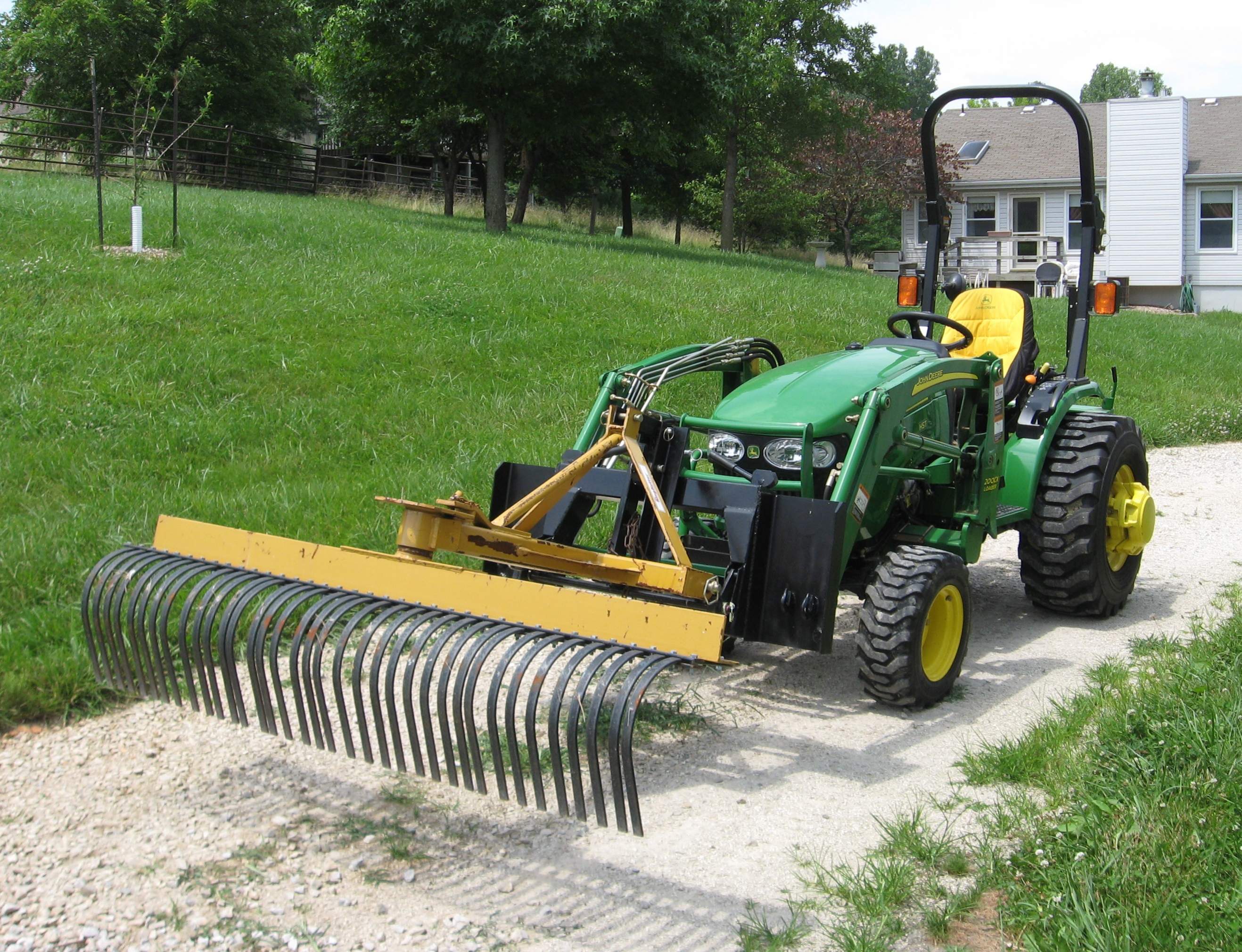

I have a 6 foot KK rake for my 2520 and it seems to handle that size OK. I wouldn't necessarily recommend a KK rake because they aren't built all that well, have lousy paint and are NOT iMatch compatible out of the box.
I bought it because it was cheap and on-sale to boot. I then made an iMatch adapter for it that doubles as a trailer hitch and also adapts a KK carryall.
Best of luck with your decision.
