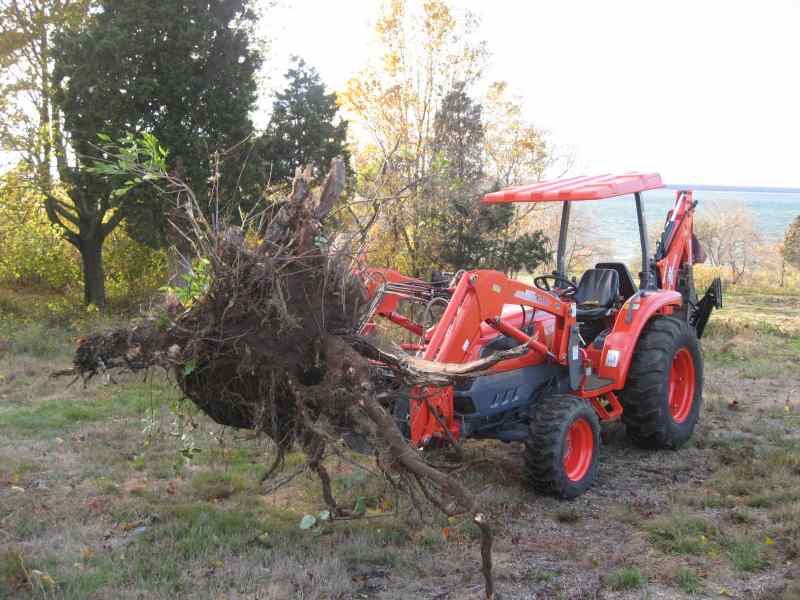

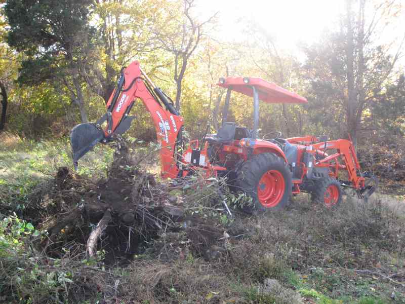

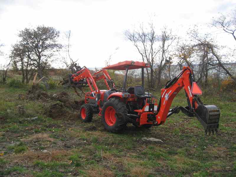

I have a Woods BH90x with a manual thumb. I don't find it to be a critical addition to be honest. I have a grapple on my tractor which is part of the reason I say that. The thumb would certainly be nice for pickup of rocks, logs, stumps etc but I found out pretty quickly that it was even more efficient to just turn my tractor around and use the grapple for such tasks. On the downside a thumb can get in the way when digging and does require getting off the tractor to position.
