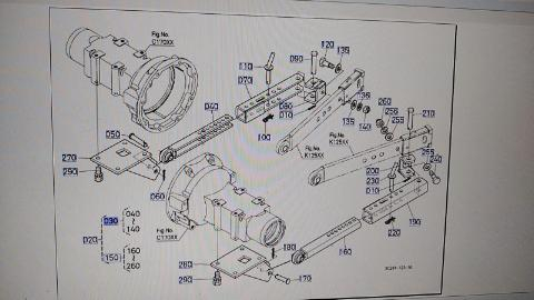

Kubota M8540.........telescoping stabilizer bar for the 3-point. It's part #40 in the diagram. Getting actual part number was not something I could find.
Any idea if aftermarket or used is available? New is $124.......
I've gone old school with a section of 1/2 inch chain in there now. But that is harder to adjust when I change implements. Though, for $124 I can out up with a little aggravation. Still, if it was available at a more reasonable cost....??

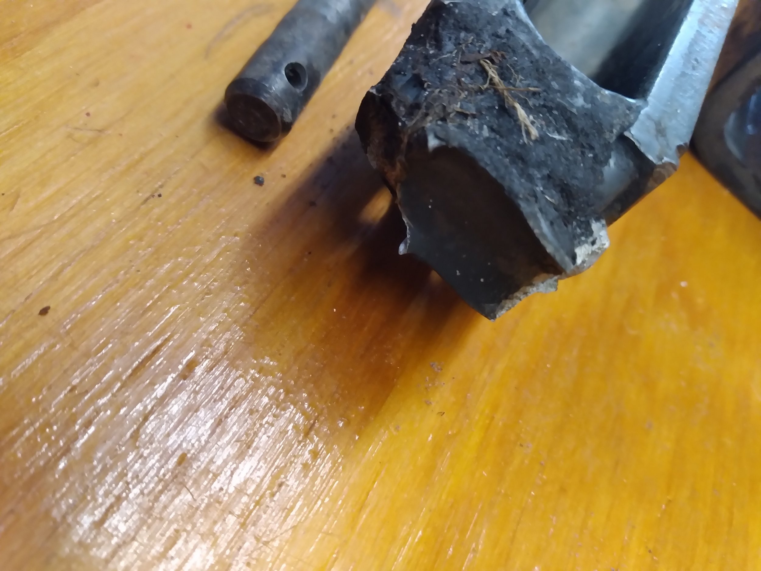

I should have posted the picture of where it broke.......at the ball and socket......not really sure how that can be fixed as that was my first thought.
   / Aftermarket available? #4
you can buy just the end socket piece then you cut your arm and re weld it on
That is a idea I had not considered. And as one of the guys who hunts on our property is a first rate welder it's a idea that will get tried!
Thank you!
