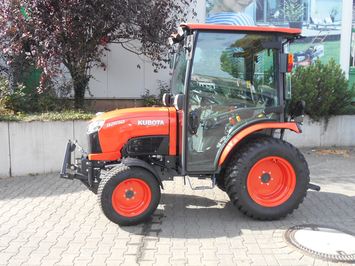

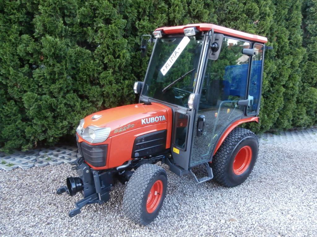

Too bad we don't seem to have standardized front implement mounts like Europe seems to have as options.
