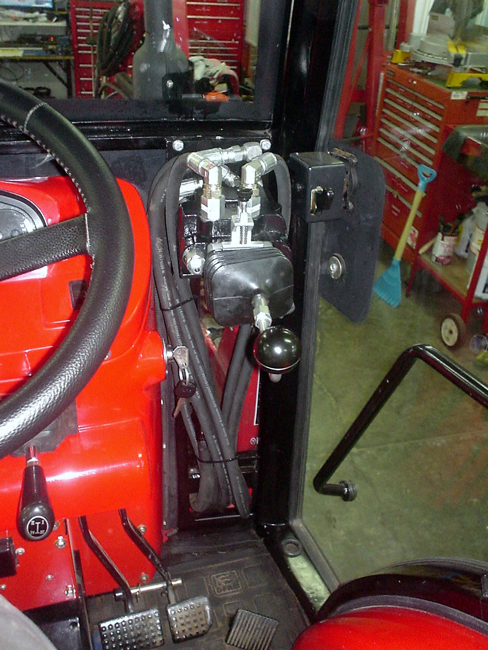

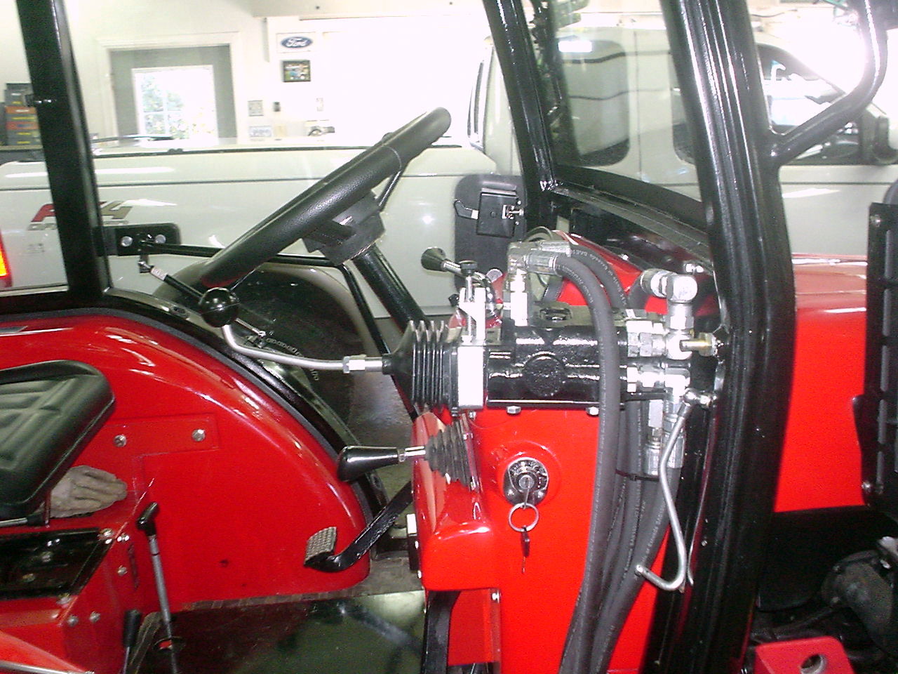

   / Aftermarket Jinma Tractor Loader Valve? #3
I bought a Prince loader valve on ebay.
Works great Prince hydraulics loader valve 1.jpgPrince hydraulics loader valve 5.jpg
Looks like a Great Deal!
How did you know which one to get?
   / Aftermarket Jinma Tractor Loader Valve? #6
I bought the one that has both float and regen dump.
Try to match the valve size to your hydraulic pump size.
A lot of the Prince valves are too large. I am not sure what this does but I assume you would have less control.
Thanks Cleat,
I will tackle this right after the Holidays!
