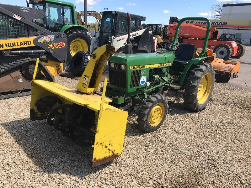

Folks -
Not sure if it was in this forum or something like Green Tractor Talk, but I recall somebody linking to a company that offered a full set of turf rims and tires for the JD750. I believe the rims were white-ish in color, and expensive.
Does that ring a bell for anyone? If so, please post up that info! I've searched and searched this forum and others, but can't find that info at all.
   / aftermarket option for JD750 turf rims & tires? #2
It sure rings a bell. :)
Your tractor was made 100% by Yanmar and painted JD green. So, where would one expect to get rims, wheels, or any other parts in the aftermarket other than John Deere? You guessed it, the Yanmar aftermarket parts suppliers.
White rims eh, those are YANMAR YM, F and FX series wheels.
If you look at the ID plate on your tractor, it should say, made by Yanmar for John Deere in Japan. ;)
My machine in the avatar when painted JD green is a JD850.
At the Yanmar Tractor Owners Group, link in my sig, there is a WIKI page on the site with all of the suppliers for what you are seeking and other goodies too. From those suppliers, you can compare pricing and shipping costs and come out on top. Plus, you can even order the JD yellow rim paint and even wheel spacers OE made by BORA MotorSports USA in their CNC shop.

Tractor data only shows 2WD info. If the OPs machine is a 4WD, then those tire sizes are not even close.
Yes, the JD750 did come in 4WD. ;)
