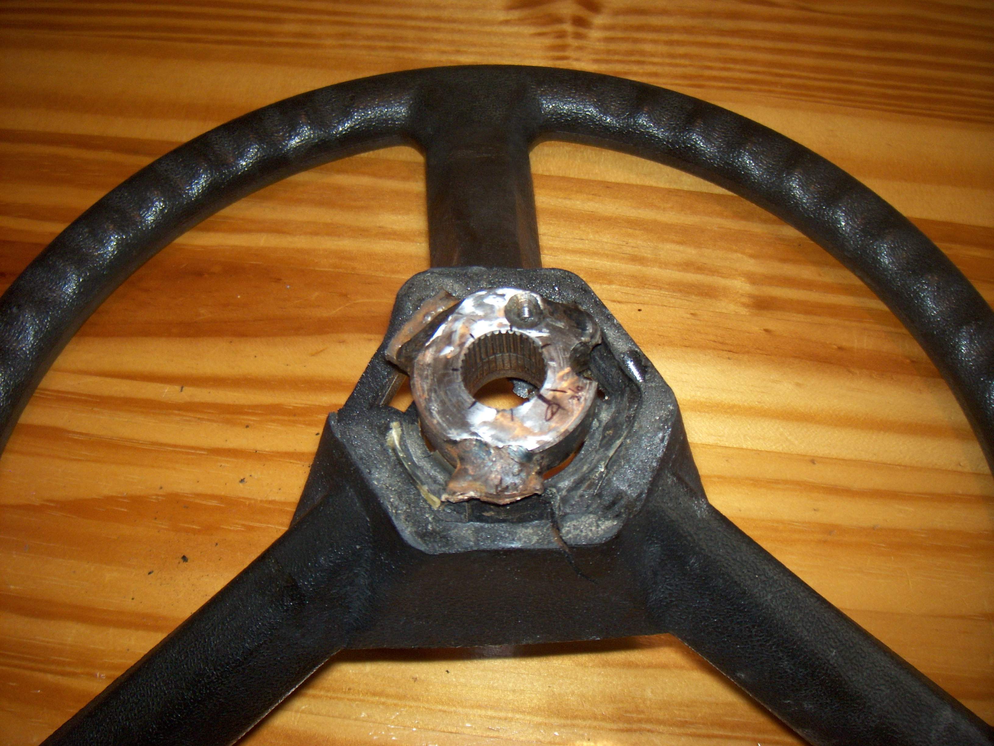

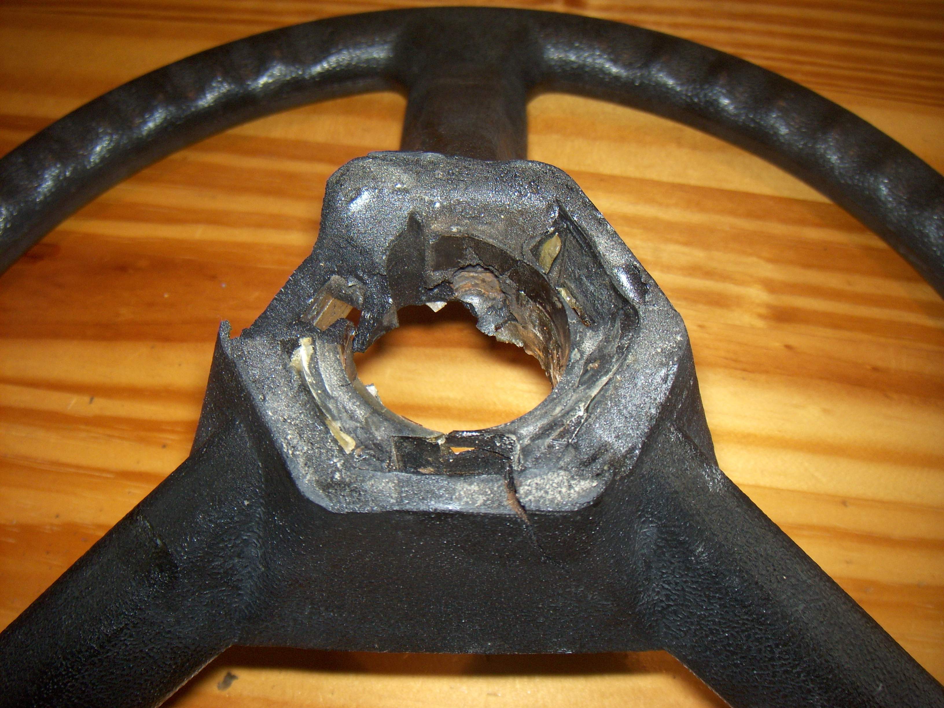

Broke steering wheel on tractor when mowing & I got hung up on a unseen large stump, just about turned over.
Because of the inferior make-up of the Jinma wheel, (Shoddy, my opinion) & the $80.00 +/- replacement cost, I had decided to try another type or brand of steering wheel,
just not having much luck matching anything to steering shaft.
Just wondering if anyone had replaced wheel with another brand or similar.
I looked at a neighbors 200 series Jinma a & his steering wheel is broken too.

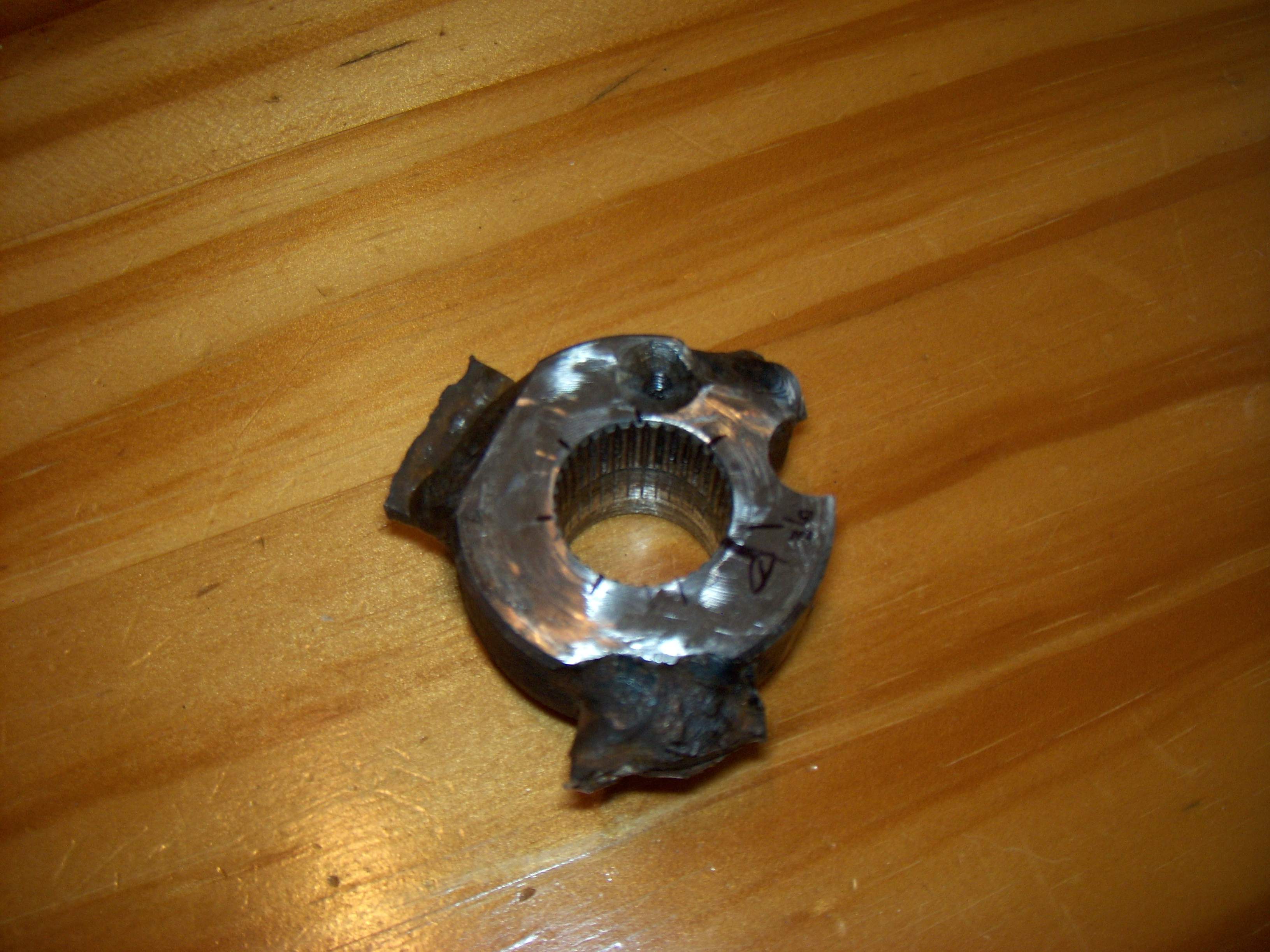

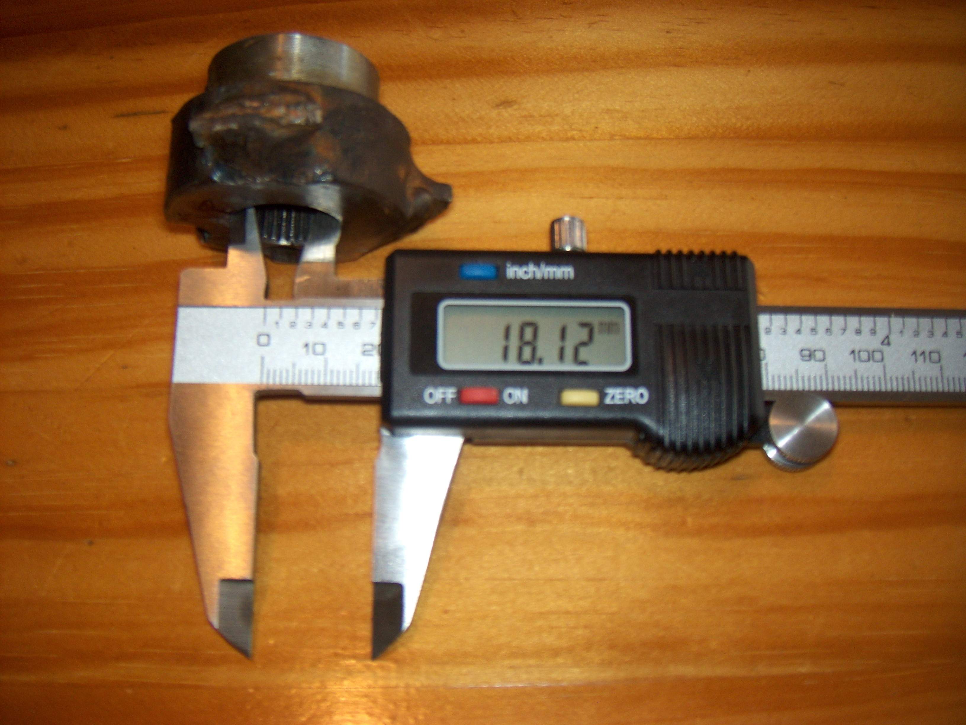

Steering shaft has a 36 spline tooth, & about 18mm (3/4")
David

After a little closer inspection, I believe this wheel was broken before.
Traces of some kind of plastic epoxy.
I think I'm just gonna have to keep off those stumps

I found out the jinma steering wheel is an 18mm (3/4) x 36 spline
