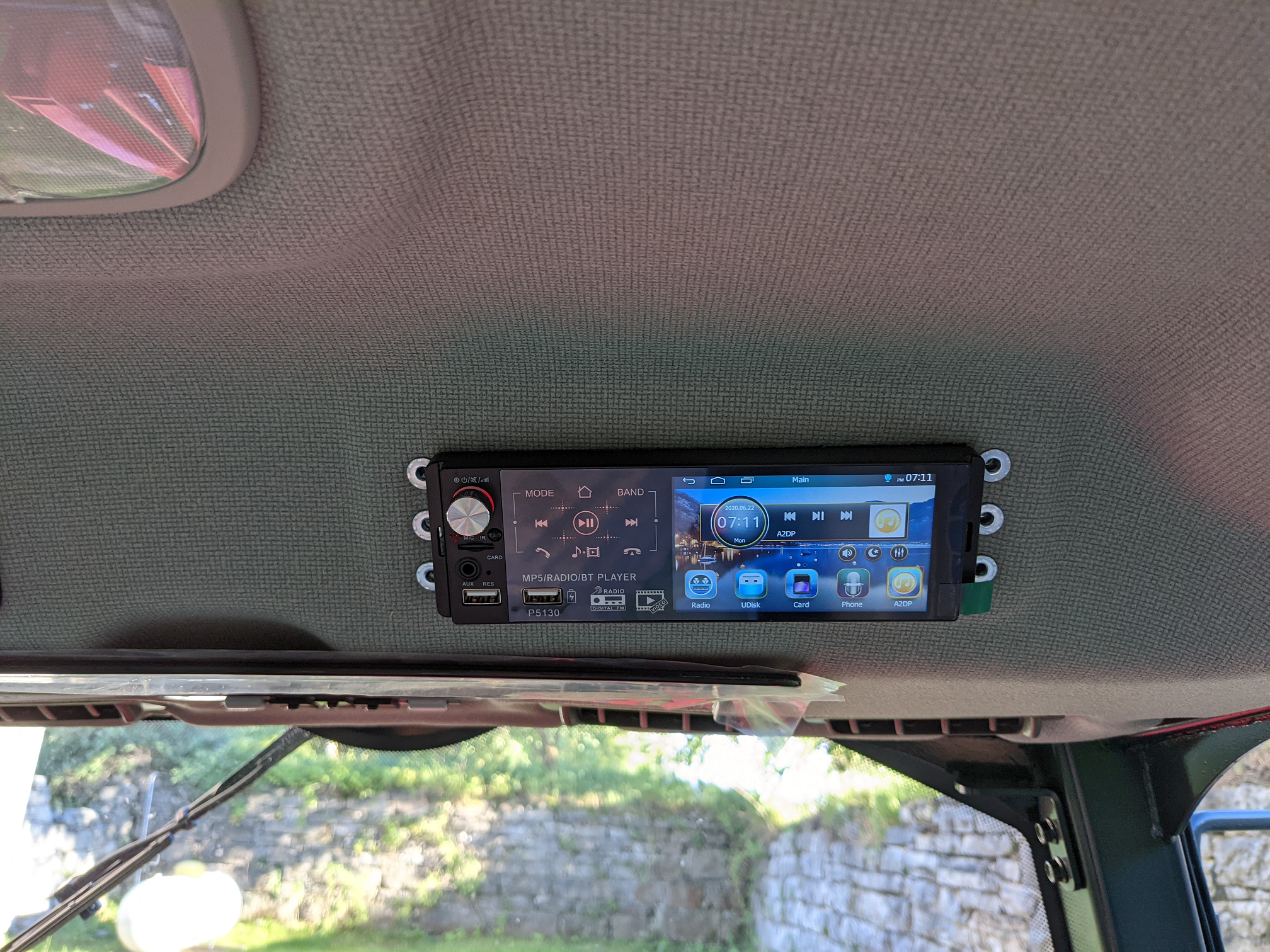

I appreciate you taking the time to pull this thread together and linking to the other thread in the initial post. The info there helped me install an aftermarket radio without a problem.
In my case, my phone doesn't have a headphone jack so while there is an aux input I wanted to add a radio that has bluetooth. Since I was buying one, I figured why not add the capability for a rear camera? I bought a cheap harness and radio on ebay. (we'll see how it works)
Cheap Harness: Metra 70-7712 1995-2004 Honda and Isuzu Radio Wire Harness TurboWires 86429021581 | eBay = $7.50
Cheap Bluetooth Radio: Single 1DIN 4.1" Car Stereo Radio Bluetooth FM MP5 Player USB Head Unit + Camera | eBay = $63
I wired up the harness tonight and tested the radio to confirm it powers on and connected to my phone. (it does) I need to work on the harness to get the reverse camera setup in place (then I'll decide if I want to use the one that came with the radio, or buy a better one.)
Between work and grad school I am slammed for time. While I have the capabilities to build this myself I ponied up some cash for expediency and purchased this surround mounting bracket (should be here soon)
