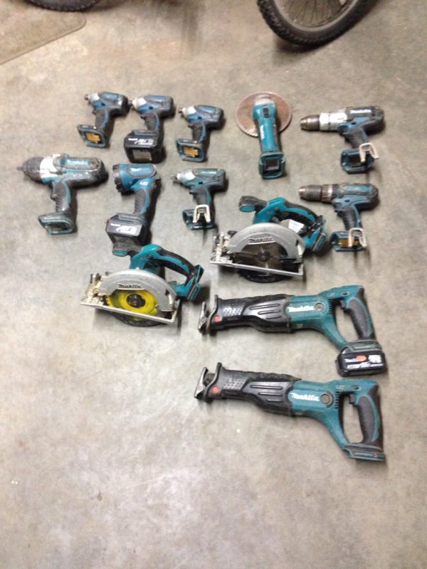

I bought a load of Makita tools at an auction a while back. The problem is I only got one working battery. I'm looking for opinions on factory vs aftermarket batteries. I use them a lot so I really need to buy a second battery. I don't know how I got by without a cordless sawzall, impacts, and a grinder. At one point I thought they were useless and I wouldn't have bought them new. It was the best $140 I've spent. I have 2 dead batteries. Does anyone think they contain enough good cells to make one working battery? image-780755671.jpg
