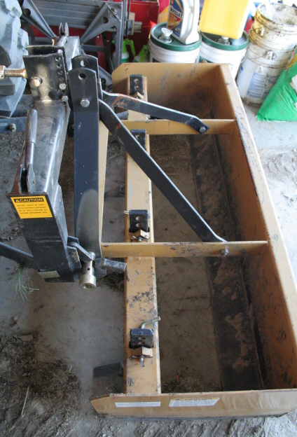

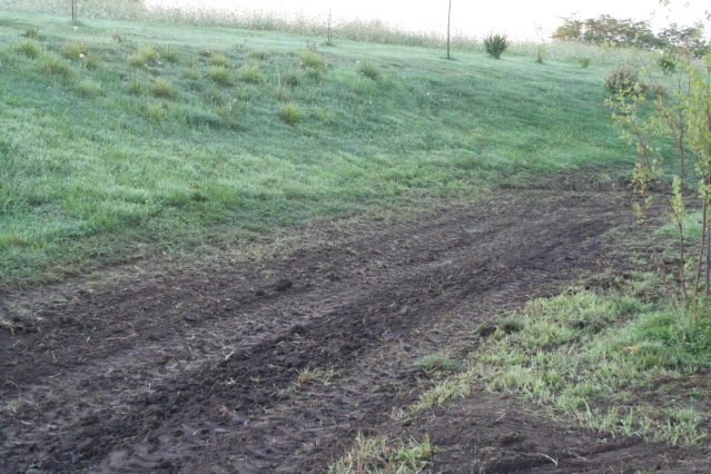

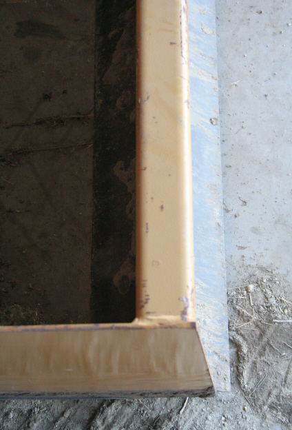

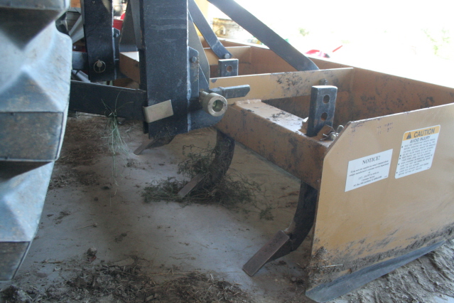

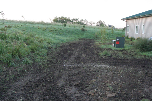

I did exactly what you want to do today. I dug a shallow ditch to prevent puddles and standing water behind our house. I have a regular BB with two blades on the back wall. One facing forward and the other backward and five adjustable rippers on front cross beam. The ground was grassy, dry and hard clay. On the first pass it looked just as the BB collected some grass and didn't bite. But after several passes the rippers loosened the soil enough that the BB bit in and pull some material. Then I adjusted the BB in desired angle and cut the ditch. I dug about 130 ft of the ditch and it took me about three hours including spreading and smoothing removed material in another place that I needed to elevate. I will take few pics and post them when sun comes up.
   / Aggressiveness of a BoxBlade #8
Pictures of my shallow ditch work.
