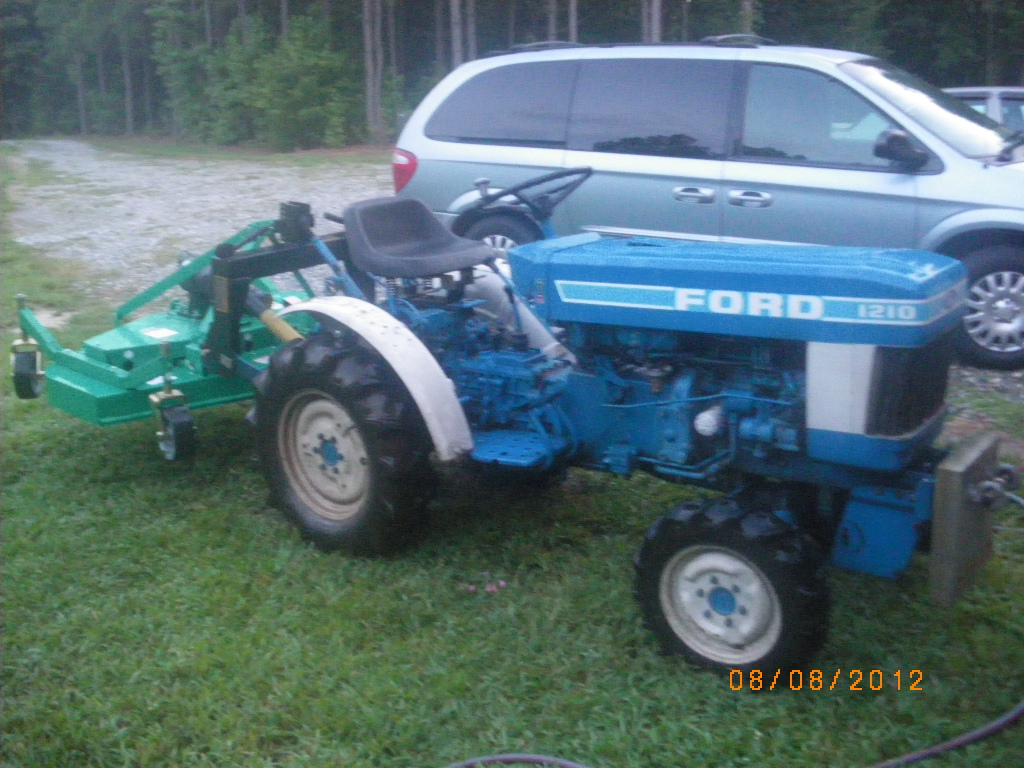

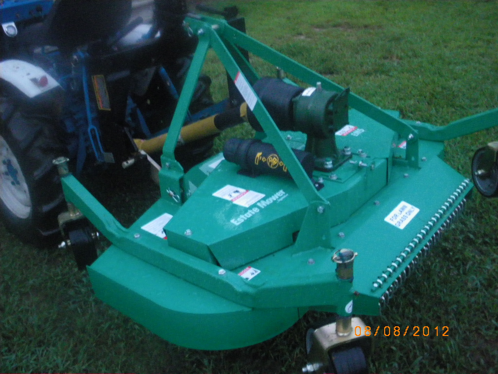

I have the 5' version; bought for $749 two years ago. They're Chinese of course. In fact parts reference "china estate mower' on Agri-supply's website. Rear discharge requires less power to operate so I pulled it for a year with a 12 hp PTO tractor. It works fine, parts are available and reasonable, keep spindles and castors lubed and its good. Also don't run the caster wheels on gravel edges they will break down (as will any solid wheel). I bought extra blades, spindles and belts to have around since I had a bad experience with Woods.
