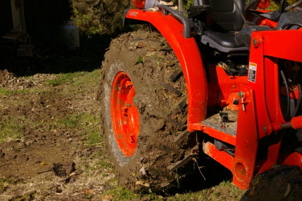

My soil is all clay and muck and I use R1's. Really can't compare the two because I never used R4's. Looking at how my R1's plug I couldn't imagine R4's or others. Haven't gotten stuck but came **** near a few times...

I agee with you. R-1's are good at "gooing" forward, but they do not work as well in reverse (I have been stuck a few times :(). I have not yet experienced a tire puncture with R-1's, but I have had a couple of valve stem rip offs. Many of the threads in TBN indicate that R-1's are more susceptible to punctures than R-4's. Jay

Not bad :D . Try that kind of mud with R4s!!!!!!!!! They would look like slicks.
