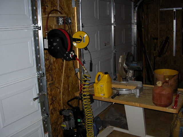

Here is a pic of the weekend place, The 25' hose retractable air hose (little HF AC just below, and the 30' retractable power cord. I can get anywhere in the garage and about 20' out front. If you start using a retractable...you'll never go back!! :D

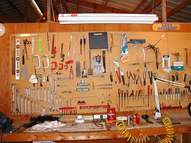

By "retractable" are you referring to those little 1/4" coiled yellow air hoses as shown in your picture, and the two of mine in this picture made in my shop? Those things are pretty stiff and pretty thin material; nothing at all like the 3/8" PVC hoses I have now. But the only problem I had with those little coiled hoses was a couple of times the fitting on the end came off, but those were used almost daily at the workbench.

Yeah I had the same problem with the coiled hoses, ends came off. The yellow coiled are great if you stay in one place. I used to work for Senco and sold to upholsters, etc, they all hung from the ceiling.
The red hose in the reel is retractable. You pull it out, it'll click about every turn and catch if you let it back in. Then to retract give it a short pull and the spring takes over! Like a room shade.
One of the ones I mentioned from HF you have to turn the reel by hand. Still handy, it has 50' on it.
